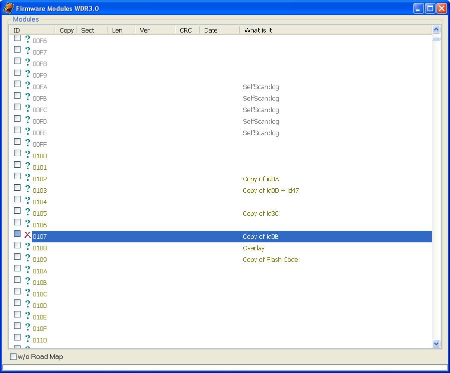

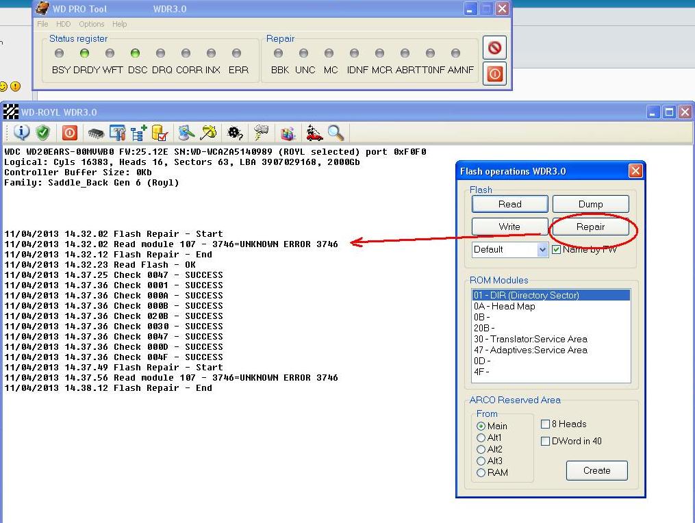

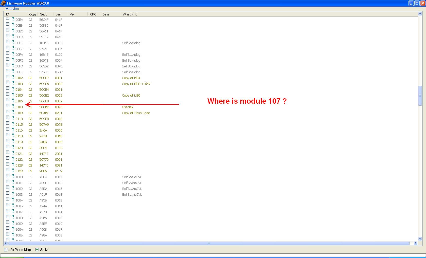

If i try to do flash repair i get error 3746 on module 107?
What is module 107?
It's normal that is not shown in module list?

 Post subject: Re: Need firmware for pc3k WDC WD20EARS-00MVWB0 25.12E
PostPosted: April 11th, 2013, 11:16
107 is ROM mod image. Not related to slow responding issue.
Other mods gets affected by this issue.
It's related to bad blocks.
I wanna try to fix mod 107, how should i do?

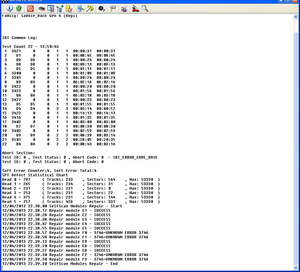

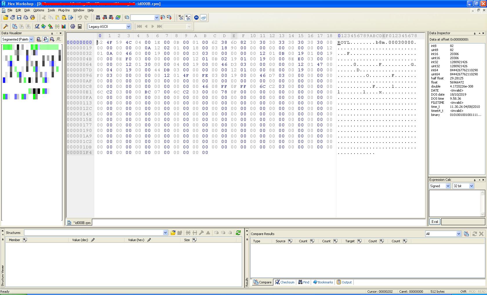

I did selfscan module repair to repair those 4 errors, but didn't fix them.
As you can see in the pic selfscan modules F0 - F1 - F2 - F3 get error 3746.
I cleared module 32 (Translator Grown) and then i opened the module file with Hexworkshop (it cleared).
Then i did quick translator with P-list (WDR wrote "successfully"), but it's still slow.

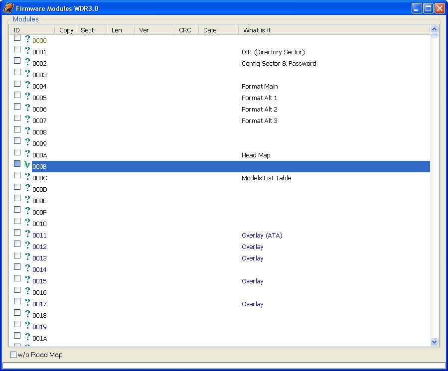

Then i went into module operation menu, Road MAp - Via Enumeration and i found much more modules, also module 107 but it's corrupted ("read all modules" button doesn't really copy all modules, i don't know why).
I read description of module 107, it's wrote "copy of id0B", so i copied module 0B (which is ok) and i renamed it 107, then I/O and write it, but it doesn't fix it (module 107 remains corrupted).
Module 0B:
Still slow...

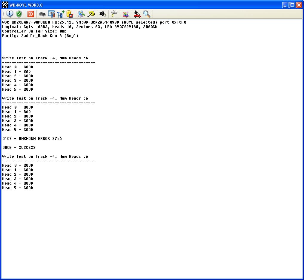

So i flashed the firmware from the donor pcb and pushed "repair", but still the same problem (also i still get error on module 107).
Then i flashed again the pcb with the original rom, of course il still the same...

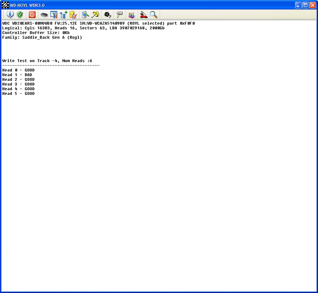

So I gave up and I realized that it is a problem of heads as you were saying at the beginning
So I wanted to try once again to test the heads, guess what ...
Now WDR detects bead head (only head 1), until yesterday it reported GOOD
Should i try to depop head?
I will need help how to do it because i never did in my life...
Thank you.
P.S.
Now head 1 is reported again good
:lol:
PostPosted: April 13th, 2013, 2:37
Posts: 17323
You need to edit the MOD. Change the MOD ID from 0x000B to 0x0107 and then recompute the 4 checksum bytes. Pad the end with 0x00 bytes until it's the correct size.
If you upload the binary data for MOD 0B, I can do this for you.
PostPosted: April 13th, 2013, 3:19
Posts: 17323
You need to change offsets 0x08 - 0x09 from 0B 00 to 07 01. That's the MOD ID in little endian format.
The checksum bytes are computed as a 32-bit little endian sum over the entire MOD contents. This checksum is located at offsets 0x0C - 0x0F.
The new checksum is computed as follows:
new cksm = old cksm - (new MOD ID - old MOD ID)
= 0x826D3862 - (0x0107 - 0x000B) = 0x826D3766
Therefore you need to edit the checksum bytes as follows:
offset 0x0C - 0x0F from 62 38 6D 82 to 66 37 6D 82
You might like to use WDR to confirm that the checksum is correct.
PostPosted: April 13th, 2013, 5:27
Posts: 17323
I suspect that this is what it should look like:
00000000  52 4F 59 4C 01 00 1E 00 07 01 01 00 69 37 6D 82
But I suspect that MOD 107 may not be necessary. Did you check whether the others were NOT_INIT?

Also in WDR doesn't exist module 107 in the module list, but it appears if i do Road Map - Via Enumeration :o
PostPosted: April 13th, 2013, 6:08
Posts: 17323
I'm not a data recovery professional, so I don't know what WDR is doing. But if I examine MOD 01 with a hex editor, it appears that each MOD entry in the directory occupies 0x12 bytes and begins with 12 02 low_MOD_ID_byte high_MOD_ID_byte
So the entry for MOD 107 should begin with 12 02 07 01, but there isn't one. That might be why it doesn't appear in the module list.
I have no idea what "Enumeration" means in the present context.
