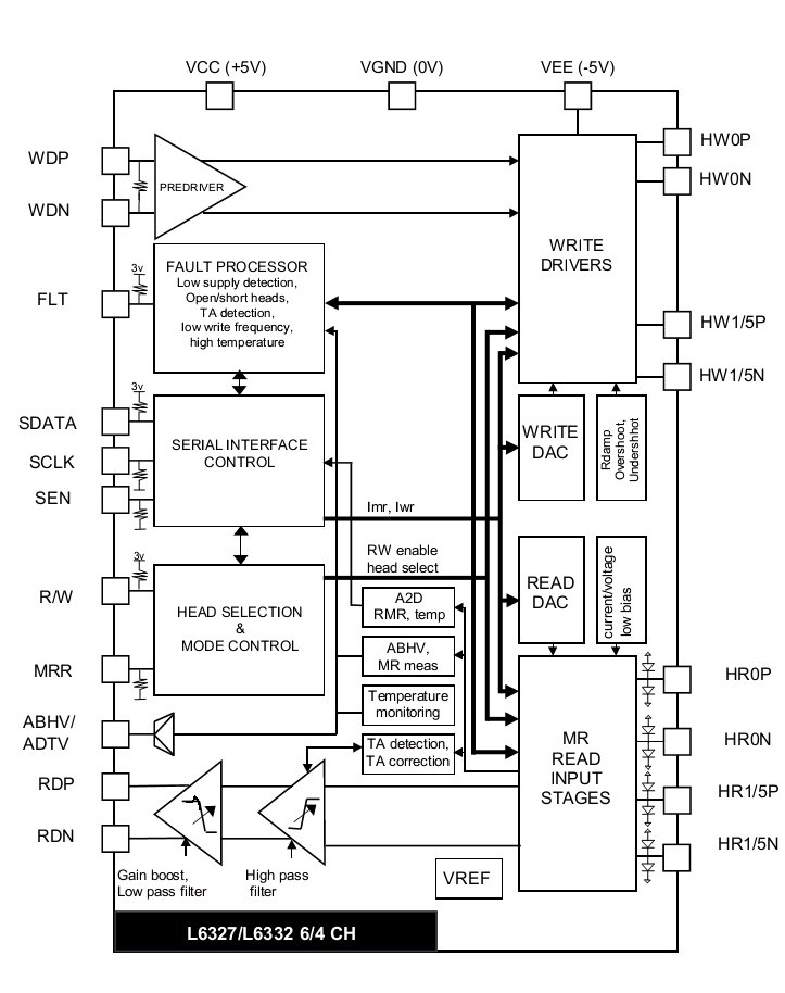

I've been looking at preamp datasheets and I notice that the following IC, while being powered from +5V and -5V, has an internal 3V supply. Several of the pins are pulled up to 3V via internal resistors.
Your preamp would undoubtedly be different, but I would look for 3V at the preamp connector.
BTW, the following datasheets discuss the 3-wire serial interface in detail:

This are the voltages on the pcb head pins (with pcb physically disconnected from the drive)
PIN 1: 0
PIN 2: 0,15V
PIN 3: 3,3V
PIN 4: 0,08V
PIN 5: 3,15V
PIN 6: 5V
PIN 7: 3,15V
PIN 8: 2,4V
PIN 9: 0
PIN 10: 0
PIN 11: 0,15V
PIN 12: 0
PIN 13: 0,15V
PIN 14: 0
PIN 15: 0
PIN 16: 0
PIN 17: 0
PIN 18: 0
PIN 19: 0
PIN 20: 3,36V

Pins 11 & 13 and 5 & 7 are the read/write differential pairs, respectively. The write pair will be driven by the read channel within the MCU, the read pair by the preamp. I would expect that the signal levels should be symmetrical, in which case I would expect that the read pair should sit at 3V when the preamp is connected. That's what I'd look for.
There should also be a Fault signal generated by the preamp. If we could identify it, then this would be another thing to check.
