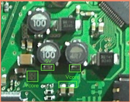

I finally managed to get the Voltage readings, please find attached image with the reading values.
I don't know if these values seems bad or not, but readings were stable every time.
The only thing that looked suspicious is the 2 Diodes measuring marked in blue:
Both diodes are exactly the same based on the part number which is identical, but the Multimeter Diode tests values are different:
1. the top one red probe on + showed 0V, other way showed 0.198V.
2. the bottom one red probe on + showed 0.070V, other way showed 0.130V.
Is it possible that one of the Diodes is causing all the problems?

The diodes are not important. The coils are where the output voltage appears.
You have confirmed that the Vio voltage (+3.3V) is OK.
The 4R7 coil is associated with the Vcore supply. This supply appears to be OK, but you should measure the bottom terminal. I have given you 3 equivalent test points in the attached diagram. Choose whichever is more convenient for you.
The -5V supply for the preamp appears at the bottom terminal of the lower 100uH coil. You need to measure that as well.
At the moment it is looking as if the -5V supply is missing while the Vcore supply is present. This would suggest that the motor controller is working, at least partially, and that the MCU is faulty. I'm assuming that the MCU switches on the -5V supply.

I actually measured the other terminal of each coil too.
In all of them the values were slightly lower than the upper terminal.
The vCore as you describe it was also ~1.397V on the bottom terminal.
The Bottom Terminal of the middle coil, the one you marked with -5V was also showing a read of 113microV.
So does it indicated the Marvell MCU is gone?
In that case this case is not doable ad the adaptives are in the controller.
Cheers

The motor controller generates the Vcore (+1.4V) and Vio (+3.3V) supplies for the MCU. These appear to be OK. Once these supplies are up, then the MCU comes alive and performs a POST. The -5V supply is also generated by the motor controller, but it isn't clear to me whether the MCU needs to turn it on. In some WD designs, for example, the negative supply remains switched off if the board is dismounted from the drive. I suspect this may be because the MCU cannot detect the preamp. If the MCU were dead, then the result would be the same.
In short, I suspect that the MCU may be dead, but I can't be certain. In any case there doesn't seem to be any easy repair option. What puzzles me is that you observed a shorted 12V TVS diode. This kind of fault would impact on the motor controller, if anything. It would affect the spindle motor and VCM sections of the chip, but perhaps the +5V sections would survive. I don't know.
Have you tried to communicate with the MCU via its serial terminal interface?

I checked it with terminal
and no response so i assume the MCU is gone :-(

I replaced the PCB with a donor one and managed to recover it all :-)
