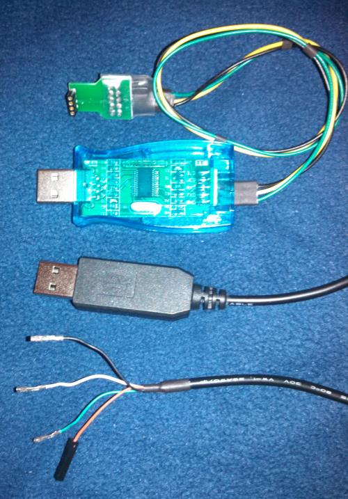

Re: ST3000DM001 NO ID BSY and Spins.
April 5th, 2014, 16:54

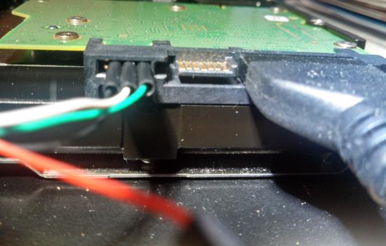

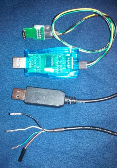

make a photo of your connections and write the terminal parameters you are using. you are very close

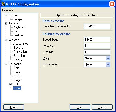

Here are the pics of my connections and terminal settings:
Terminal Settings.jpg (33.88 KiB) Viewed 31318 times
I removed the plastic connectors from the ends of the wires as IMweasel indicated and used heat shrink to insulate the connections. This also creates just enough tension between the three wires to keep them securely connected to the drive serial pins.

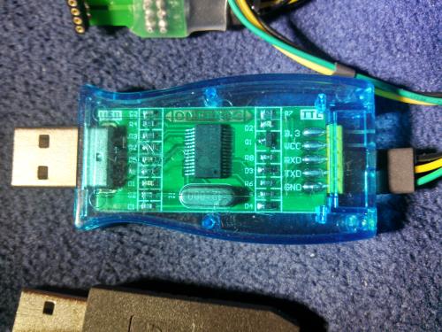

@dcsang, I'm wondering whether the TTL voltage levels are mismatched.
Can you measure the voltage levels at the drive and at the adapter, with the adapter disconnected from the drive? AIUI, the drive's I/O voltages are in the range of 0V - 1.8V whereas your adapter may be configured for 3.3V. If so, then it may be that an output of 1.8V from the drive may not be reliably detected as a logic HI by the adapter.
Can you show us a detailed photo of the adapter's PCB? Some bridge ICs can accommodate 1.8V and 2.5V supply voltages for their TTL IO logic. You would need to modify the PCB, though.

The drive serial pin voltages are as follows (pin 4 closest to the SATA port):
GND (Pin 2) to TX (Pin 3): -1.8v
GND (Pin 2) to RX (Pin 4): -1.25v
I have two PL2303 adapters using the same Prolific driver. The ONEFROG adapter purchased from hdd-parts passes a loopback test but does not produce any terminal feedback from the drive. The adapter voltage measurements are as follows:
GND (GR) to RX (BL): 2.6v
GND (GR) to TX (Y): 3.55v
The 'USB / Serial TTL 5V cable - PL2303HX converter' recommended by IMweasel produced the terminal output and had the following voltage measurements:
GND (BL) to RX (WH): .2v
GND (BL) to TX (GR): 3.3v
Also, thank you for that article!

It does appear that there is a problem with mismatched voltage levels. There are several versions of the PL2303HX chip, with the most recent version (PL2303HXD) supporting lower I/O voltages (1.8V and 2.5V).
Here is the datasheet:
http://www.prolific.com.tw/UserFiles/fi ... v1_4_4.pdf
That said, support for the lower voltages would require an external 1.8V or 2.5V LDO regulator IC.

Good to see you are making progress. I am not aware of the voltage output i get from my cable, i'll post it in the near future.
The terminal settings you are using seem to be fine.
But as for the garbled,cryptic output you are getting...i'd think you are having a ground problem. A ground loop problem to more specific.
I've seen slightly garbled outputs due to total lack of grounding, but a ground loop really makes things worse.
Using the black wire on the 3rd pin would seem right, but this actually makes things worse.
I solved this by putting the drive im working on, in direct contact with the internal bare frame of my computer case. (not the painted outside,as it would not make contact)
So make sure to just connect tx and rx, and ground the drive to your case!
edit: looking back at your pictures...the power plug on your drive seems unusual... are you using an external power source to power the drive?
If yes, do it differently and use an internal plug off your PSU.
