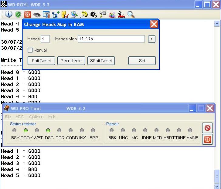

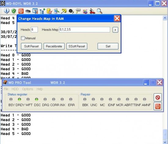

Hello, i'm not sure how to edit heads on ram with WDR.
Someone can help me please?
Is this right?
My firmware database:
 Post subject: Re: WD My Book Essential with drive WD20EACS-11BHUB0 encrypt
PostPosted: July 30th, 2013, 11:37
Posts: 2984
Try "0 1 2 3 0 5"

Head map on ram seem to not work.
After head map edit on ram i push the button for "drive info", the drive is still detect as 2000 GB. Is this normal?
I tried a lot of different head maps, but i still see as 2000 GB drive, maybe WDR 3.2 bug ?

Why are you expecting the capacity to change?
You are not depopping a head, just temporarily disabling it in RAM, so no firmware is being changed and therefore the capacity will not change.

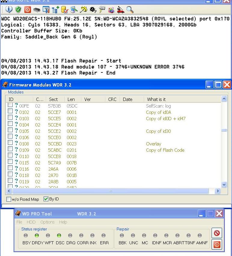

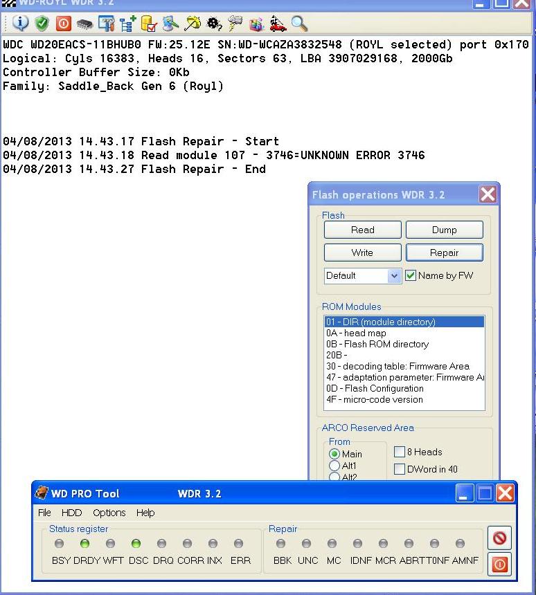

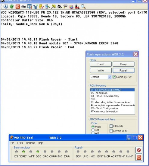

i was trying to do the ROM repair when i see error on MOD 107
i didn't confirm "repair" due to error
In SA i don't see mod 107 :?

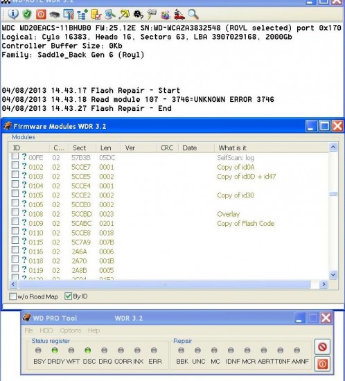

Is this normal or a symptom of something else?

Someone does know something about mod 107?
PostPosted: August 12th, 2013, 5:27
Posts: 2984
Your ROM is external, so 107 should be empty.

Thank you hddguy, i gave back the drive to the owner.
Problem is on head 4, with WDR i could do head edit map on ram but i can't clone the drive on head 0-1-2-3-5
WDR head map edit on ram it's useless if doesn't have option to clone on other heads :lol:
