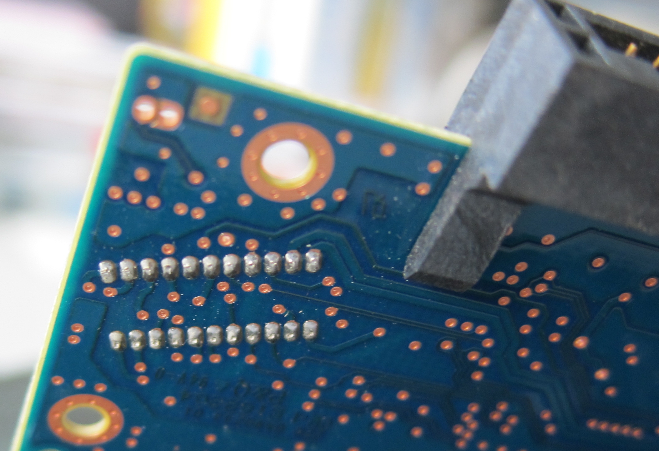

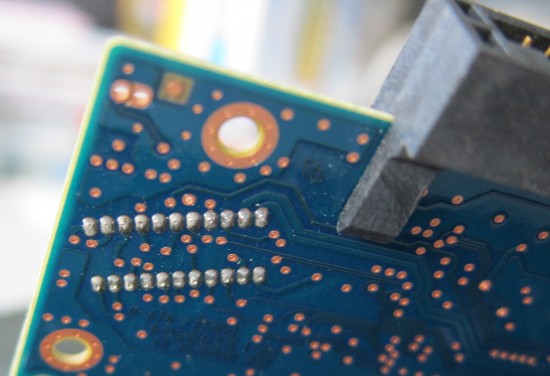

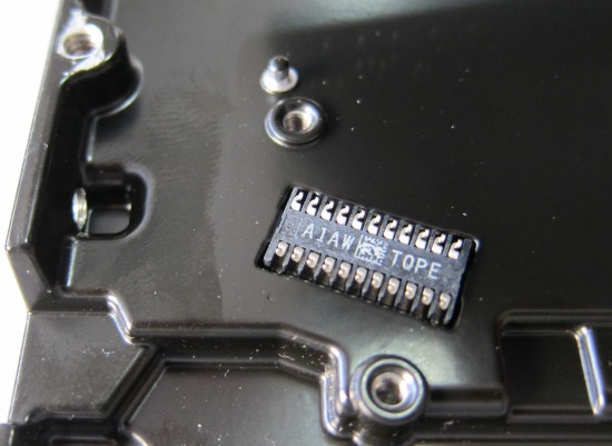

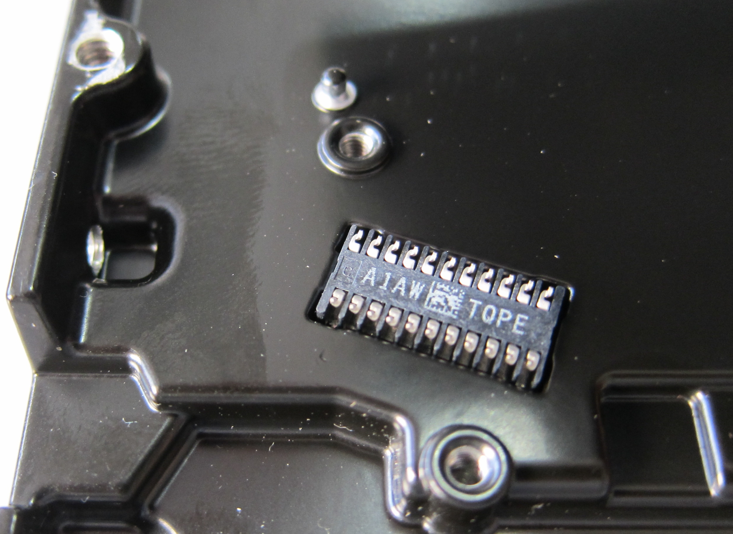

I attached a picture of what looks like an IC fixed to the HDD housing (but now I think it's just a connector), and one picture of the landing pattern. The IC/connector is not soldered to the PCB, just pressed onto it.
BTW, I will add some pictures of the damaged/blown IC with that hole when I get access to a microscope and a X-Ray device. Next time when I go to an assembly factory.

You may find the following article useful:
http://hddscan.com/doc/HDD_from_inside.html
Here are several preamp block diagrams:
http://malthus.zapto.org/viewtopic.php?f=59&t=229&p=582
Thanks, that explains the confusion - you should not have called it an IC/chip.
Correct.

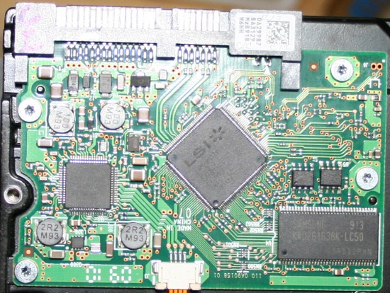

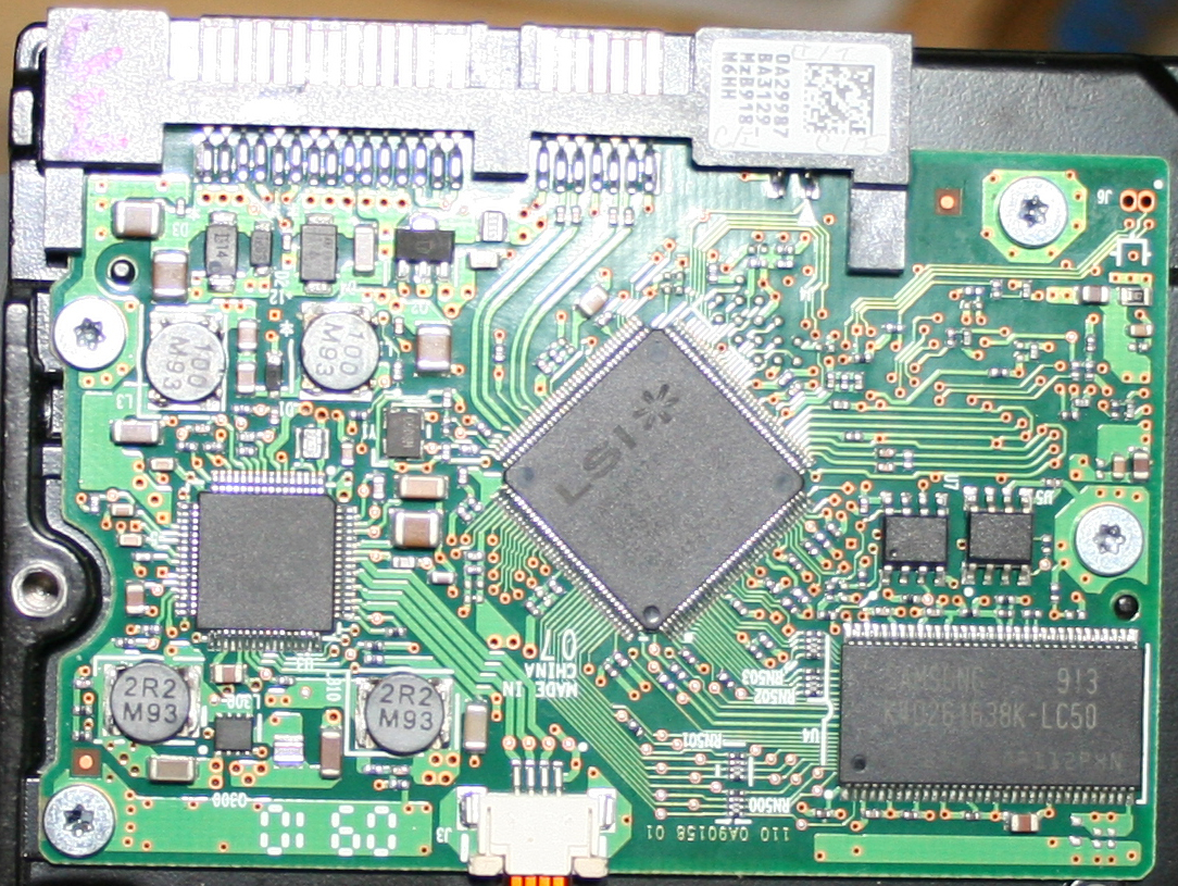

I have same drive with similar issue....I use mostly Hitachi HDDs, 3.5 and 2.5" in my PCs and laps, as I foind them most reliable. The partial failure in this HDD may've been partially my fault...
It was a "C" drive and about 10mos old when it failed. It failed upon PC power-up (the PC was off for about 5 hrs). I almost never pwr down or even hibernate my PCs -- something I learned in the manuf. industry where consumer-grade PCs and notebooks were always on ... 24/7 for years. IAC, I use extremely clean PSUs, and cascaded DIY line filters and UPS's. Indeed, most of my PCs are always on and even the screen saver is disabled. I have two Dell Inspirion laps, now running for 10+ years, almost always on (I had to manually tweak the OS and AntiVirus so that HDD would spin w/o hardly any arm/head activity -- something not native Dell settings...you can hear a Dell lap's HDD clicking away, every minute or so, from the date you first turn it on!!)
Anyway...the 1Tb 3.5" HDD in question spins up, but the head/actuator arm do no move. Hence the drive is never recognized in the PC's OS or BIOS. I've mounted it internally in the PC, and in a USB external 3.5" HDD case. No change i.e., same issue! I looked at the PCB carefully under a magnifier, and took some basic measurements. All looks and measures "normal".
At first, the drive would not even spin up. I removed the PCB and powered just it up w/o the drive, checking for heat and audible noise...no warm spots but I could detect a faint whistle sound near the main pwr input diodes/inductors area. I took a few DMM measurements and finger pressed the components and PCB area in question. Again all seems normal (no heat spots or visible/measurable component damage). And I re-attached the drive to the PCB as normal. Strangely, the HDD spun up again. Alas, the head/arm do not want to actuate, so the drive may be useless.
BTW: I do have experience with several other HDD and driver-board repairs. But this one has me stumped. Any help is appreciated.
THX!!

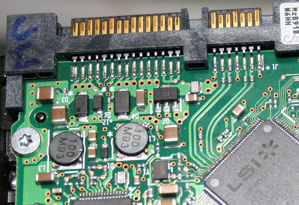

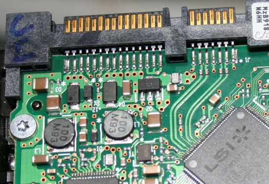

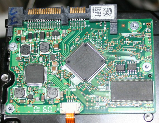

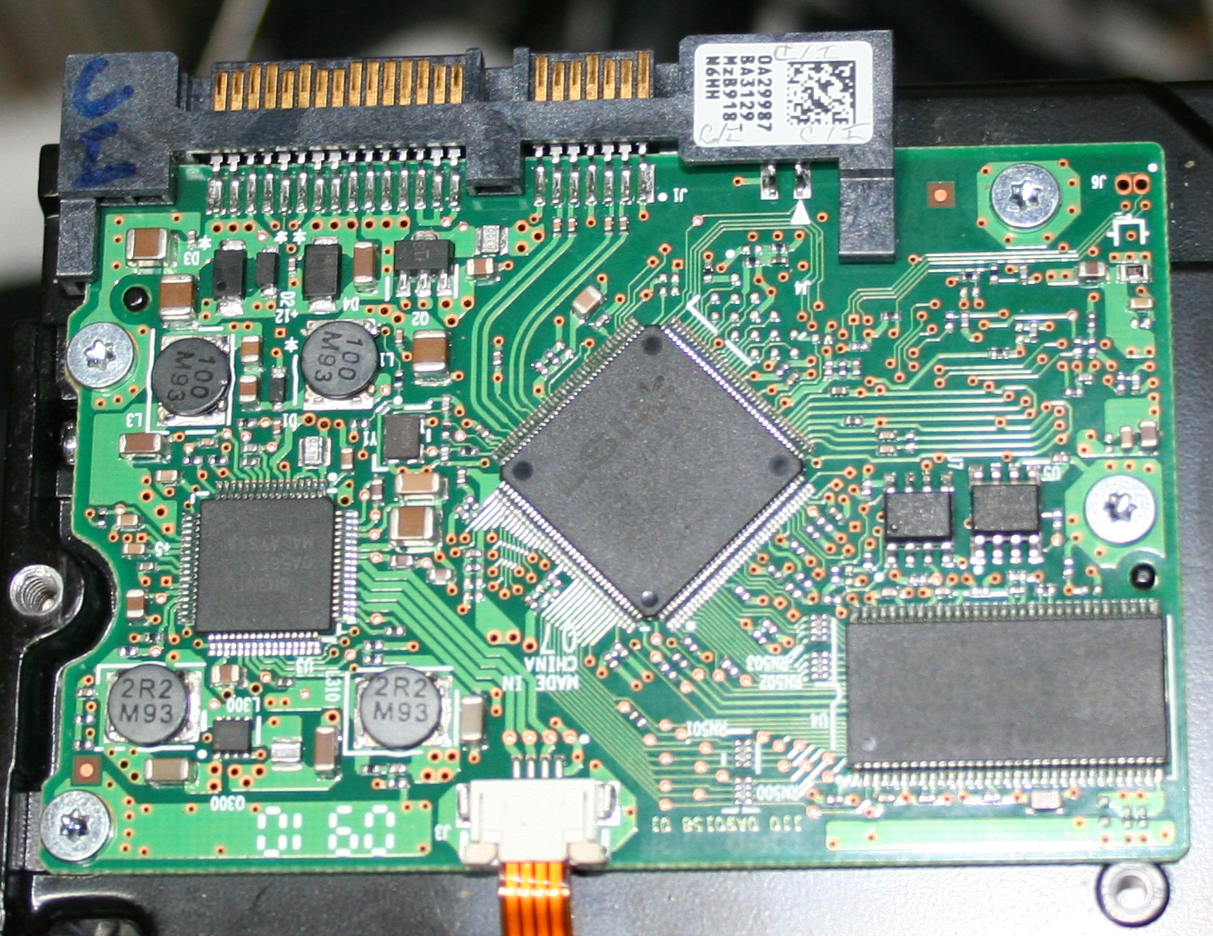

pictures of pcb (component side)
 Post subject: Re: Dead Hitachi 1Tb HDS721010CLA332
PostPosted: August 16th, 2013, 15:58
Joined: August 15th, 2013, 5:06
Posts: 39

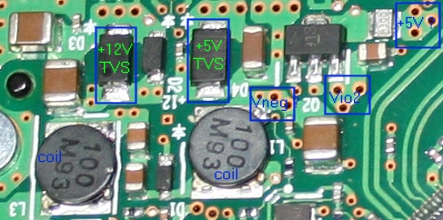

Any takers on the above HDD? I did test the TVS diodes and they are fine. How likely are the opamps to fail?
PostPosted: August 16th, 2013, 16:28

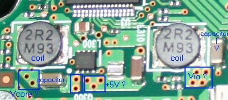

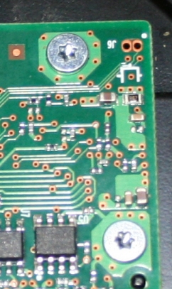

Posts: 17216
Your TVS diode protection regime seems more robust than the two most recent Hitachi models I have seen. Therefore I doubt that your drive has sustained an overvoltage.
Your initial statement that the drive didn't spin suggests that the PCB had a problem, yet subsequently you have managed to get it to spin. However, it is not clear whether the drive was able to reach full speed.
I can't really help with any internal problems, if that is indeed the issue, but FWIW I can show you some voltage test points. If you can show me the other side of the PCB, I should be able to help you confirm whether there is continuity in the voice coil circuit.
The following photo clips represent my guesses as to the relevant voltages.
Measure the Vcore and Vio.
Measure Vio2 and Vneg.
Tell us the markings on the ROM and NVRAM chips. You will need to transfer the NVRAM if you decide to replace your PCB.
Measure the voltages at the 0.47R resistor and the A and B components (probably capacitors).
When removing the PCB, take note of the locking tabs.
It may help to know how the drive behaves when the HDA is disconnected from the PCB. To this end, slightly loosen the two preamp screws and slide a business card between the PCB and the HDA. Then power up the drive. AIUI, some drives won't spin up if they cannot detect the preamp, whereas others will spin up regardless.
Do not slip with your multimeter probes, as catastrophic damage may result.
PostPosted: August 16th, 2013, 16:51
Posts: 39
Thx for your detailed reply. I'll reply back in more depth shortly (I won't have a chance to work on this unit for a day or two). In the meantime, I can recall the following from memory:
I had the cover off when the HDD reached full speed. At the time (before drive was powered on), I had the head assembly in the MIDDLE of the parking unit. When (I assume) the HDD reached full speed, the head assembly effectively snapped to back of parking unit. This may indicate full speed reached???
As far as the back of the PCB ... I did go over it very carefully under a magnifier. Not damaged whatsoever as far as my eyes can be trusted. IAC, I'll try to post a pic of that soon.
