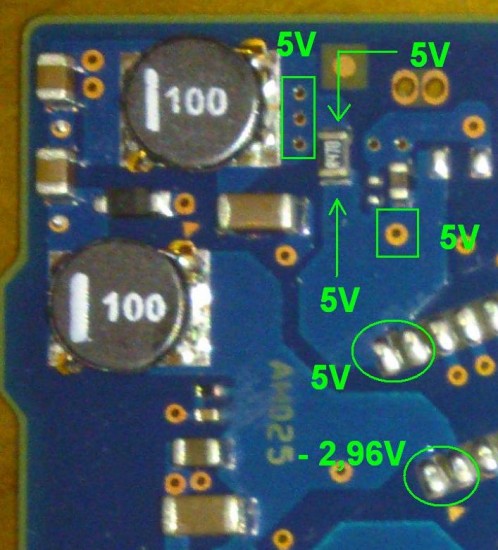

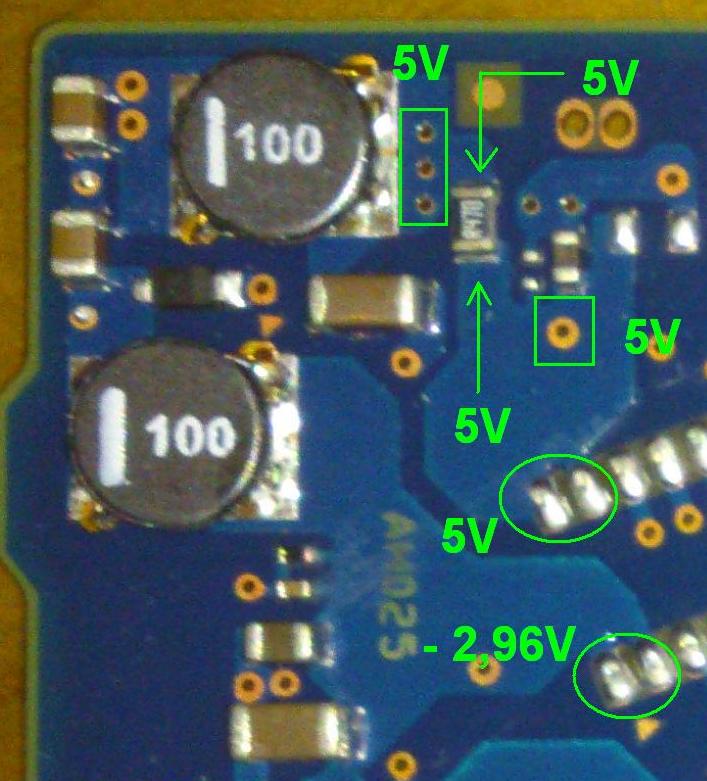

i didn't find any +18V with pcb connected to the drive.
Also, as you can see in the pic i posted before, on 47 ohm resistor i have 5V on both side.
Resistor R470: 47x 10^0 = 47 ohm
This means it is shorted.
So i checked the resistor with ohmeter, value is 0 (shorted)!
Aunless the resistor is not connected in parallel to the coil, it should not be 0 ohm.

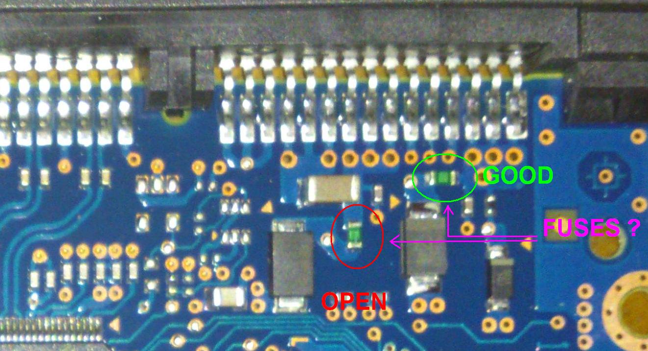

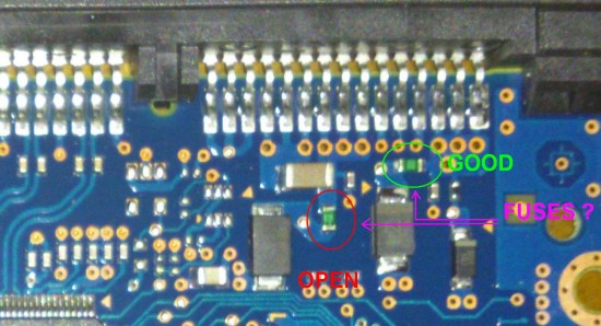

Also, i found 1 opened fuse (if it's really a fuse)?

The "R' in "R470" is a decimal point. So the resistance is 0.47 ohm.
Those other two components should also measure 0 ohms. That said, if the 5V "fuse" is open, then why is the 5V TVS diode not shorted? Is it possible that the surge struck the 5V supply, in which case is it possible that it killed the preamp?
That's exactly what i was thinking...
5V diode is not shorted, it should short to protect other pcb components and pre-amp.
On seagate drives i see TVS diodes do a good job, but on WD (green models) i see very often TVS protection failing.
This is the first 3.5" Hitachi on which i'm working, and TVS protection seems to be as WD, SUCKS.
i fixed few days ago a 2.5" Hitachi, it had one open fuse, i substituted it after searching for shorted components as TVS diods, capacitors etc but i didn't find any shorts.
That drive is working since 1 week. 8)
I would love to ask to WD and Hitachi engineers why they do not take example from Seagate (at least as regards the TVS protection)

I was thinking also, why does the drive spin if that fuse is open?

I guess I've been in denial for a long time, but ISTM that, as strange as it may sound, Hitachi's (and WD's ?) design philosophy seems to be to protect the external PSU from the consequences of a shorted TVS diode rather than to protect the PCB from an overvoltage. In other words, it appears that Hitachi's circuit may look something like this:
+5V  O----+---------O +5V unfused
         fuse
          X <---- does this junction connect to anything?
      TVS diode
GND  O----+---------O Ground
If I'm right, then the first surge opens the fuse, and the second surge then kills the unprotected drive, or the first surge can do all the damage on its own if it persists for long enough.

BTW, I would check whether junction "X" connects to any pin on the motor controller.
Nope for the bad fuse (unless between junction "X" and motor controller pins there is some opened component).
Yes for the good fuse
P.S.
Bad fuse is on 5V rail, the good fuse is on 12V rail.

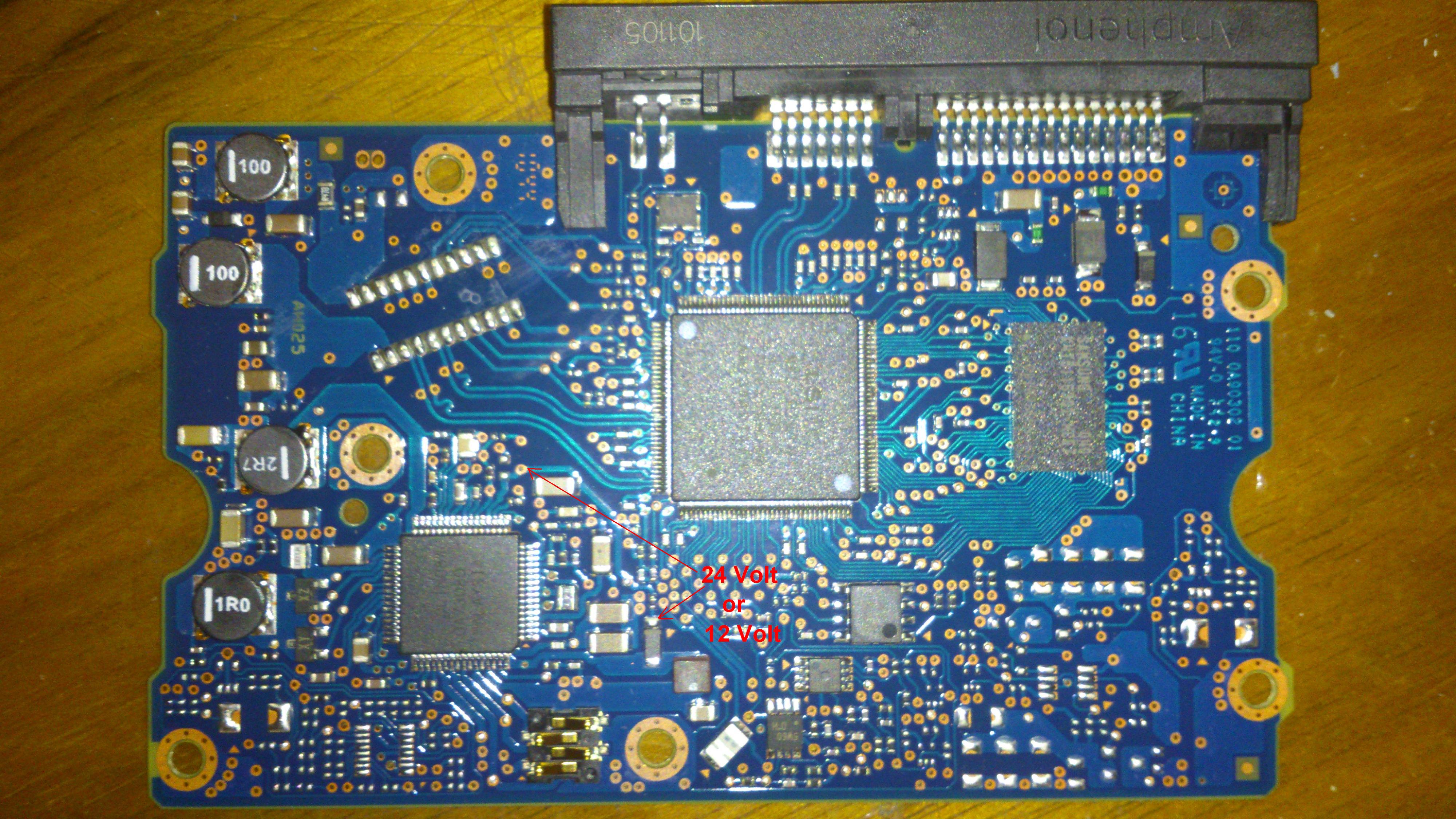

I didn't find any 18V, but i found 24V point.
When i power on the drive i have 12V in that point, then the drive does some clicks (when i hear clicking the tension goes up to 24V for half second).
If drive spins down the tension stay on 12V, if spinning continues it keeps on 24V
I have 24V only in that point and only if the drive keeps spinning.

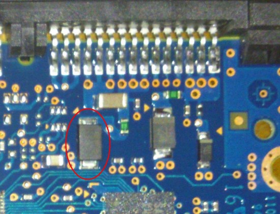

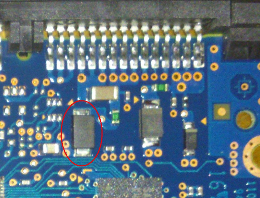

What kind of diode is this?
above it is written:
ST VU
SUA
GP03S
I can't find datasheet for it!! :?
I dessoldered it from pcb to misure with multimiter.
Diode tester in direct polarization: 0.270 V
Inverted polarization: 0.585 V
20K ohm tester in direct polarization: 2.7 Kohm
2K ohm tester in direct polarization: 1.31 Kohm
20K ohm tester in inverted polarization: 3.98 Kohm
2K ohm tester in inverted polarization: "full scale range"
Drive still spins without the 5V diode and without 5V fuse :shock:

It's a 5V TVS diode. It is testing as leaky, so it is definitely bad.
"ST" is the manufacturer, ST Microelectronics.
"SUA" is the marking code, probably similar to SMA6J5.0A (6UA marking).
http://www.st.com/web/en/resource/techn ... 152688.pdf
"GP03S" is a date code and manufacturing location.
All drives work without their TVS diodes.
