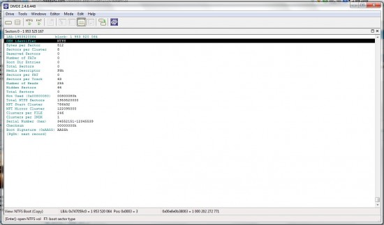

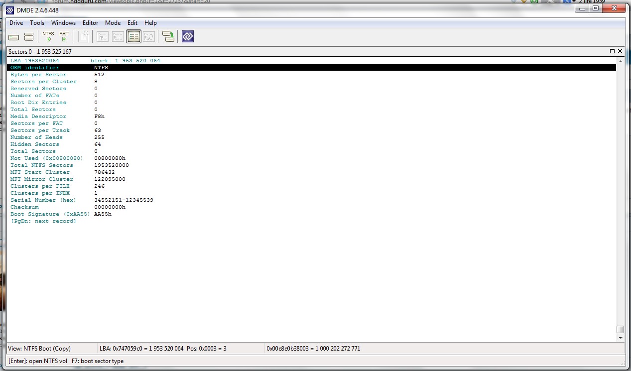

If you wish to persist with DMDE, then you need to show us sector 64 of the physical drive, not of the logical volume.
When you launch DMDE, uncheck the Show Partitions box. This will place you at sector 0 of the physical drive.
Then select Editor -> Goto Offset -> select sector 64 (decimal). This will be the current NTFS boot sector.
Now go to sector 1953500000 and select Tools -> Search For Special Sector -> Boot Sector. This should find the original NTFS backup boot sector, if it still exists.
Re: TestDisk for Linux, recover after format...
November 14th, 2013, 22:46
fzabkar wrote:If you wish to persist with DMDE, then you need to show us sector 64 of the physical drive, not of the logical volume.
Sector 64 is all 00 00
Sector 1953500000 see photo:

The TV has overwritten the beginning of your file system. :-(
I don't see any easy manual solution. I would clone your drive, or use data recovery software to recover your data to another drive.
