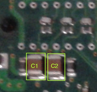

I would measure the voltages across each of the capacitors (C1 and C2) at the HDA pins. One should be +5V, the other -5V.

First reading is +5.05 and -5.05.
Second reading gave nothing.
And the third is 0.625 for both.

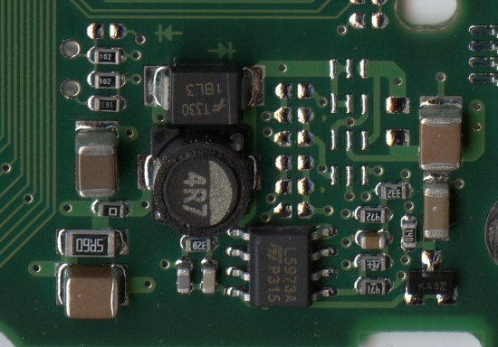

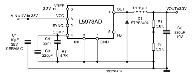

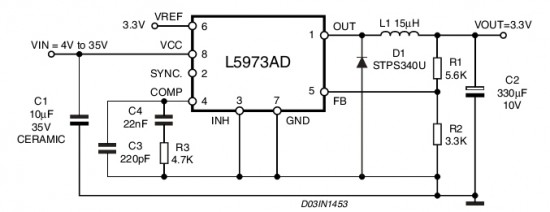

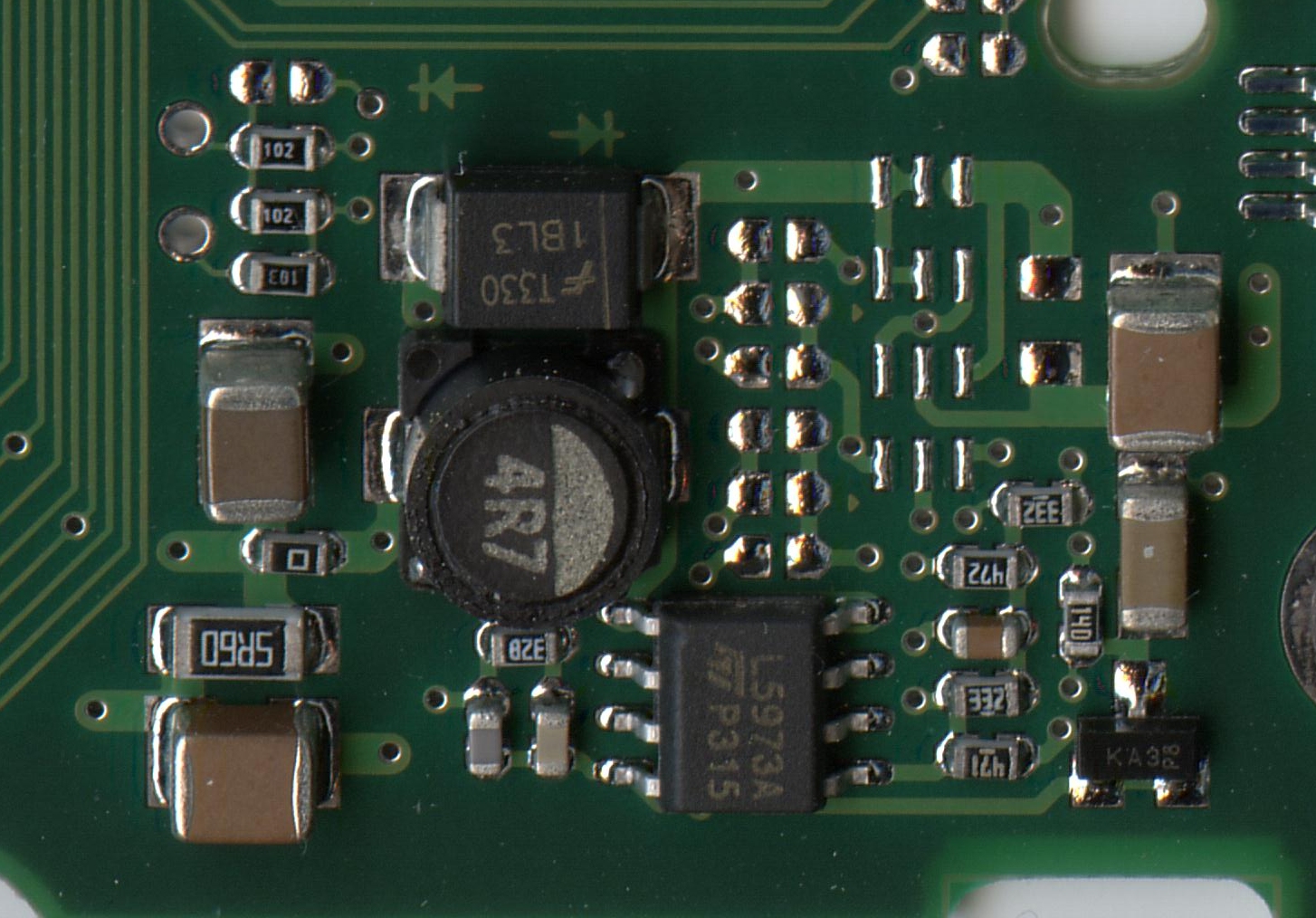

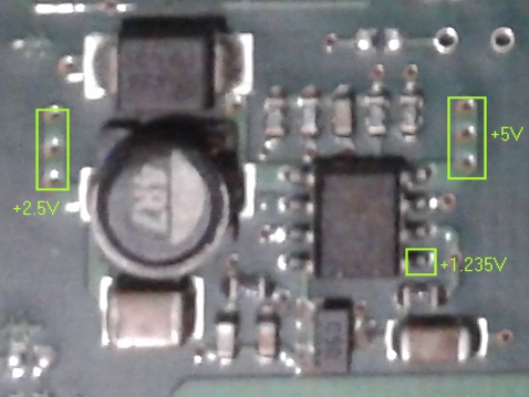

The fault appears to be in the 2.5V regulator circuitry.
I have attached a scan from a similar board, plus an application diagram from an L5973A datasheet.
Could you measure the three voltages I have identified?
L5973A, ST Microelectronics, 2A step down switching regulator:
http://www.st.com/web/en/resource/techn ... 003370.pdf
http://www.st.com/web/en/resource/techn ... 004439.pdf
http://www.mrq-ml.com/pdf/L5973A.pdf

Left to right 2.05, 1.226 and 5.05.
 Post subject: Re: Samsung IDE hard drive won't spin up
PostPosted: December 30th, 2013, 15:15
Posts: 17230
I found my board and measured it. It does in fact measure 2.06V. Sorry for leading you astray. I don't understand why my other board measures 2.5V, though.
