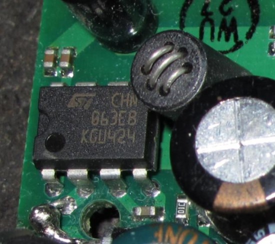

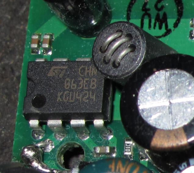

To what you attribute the title "5v switch mode regulator", well, all I can say is, here's a bigger picture.

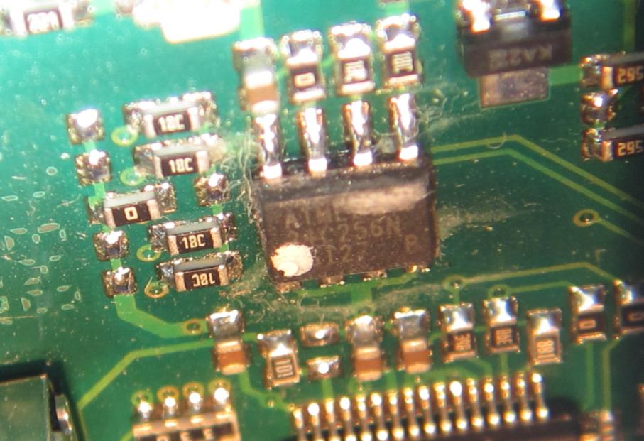

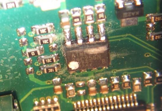

And to that which you suspect to be eeprom, again I offer a bigger picture, somewhat marred by some white crud.

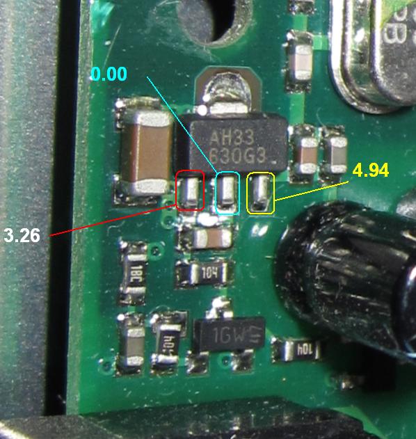

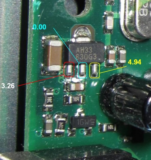

I've had chance to test the potentials of the LDO:
Seems okay, no?

AT24C256N, Atmel, 256Kbit (32K x 8), serial EEPROM:
http://www.atmel.com/Images/doc0670.pdf
MC34063EB, STMicroelectronics, DC-DC converter controller, marking 063EB:
http://www.st.com/web/en/resource/techn ... 001232.pdf

The LDO looks good. If you now CAREFULLY measure the pins of the 4925 dual MOSFET switch, you should find +12V and +5V on the Source pins. The +5V supply will be generated by the MC34063EB, not by the USB port. Please don't slip with your probes, as catastrophic damage will probably result.

Good stuff. I have SMD marking code guides but it would seem only experience will help. Googling only ever produces garbage. How do you do it?
 Post subject: Re: USB-IDE Bridge Fail - old Freecom External : HW encrypti
PostPosted: January 29th, 2014, 20:59
Posts: 17226
The AT24C256N was obvious. In the second case it helped to recognise the logo, and in retrospect the chip is a very common one which you can find in mobile phone chargers such as those powered from a car cigarette lighter.

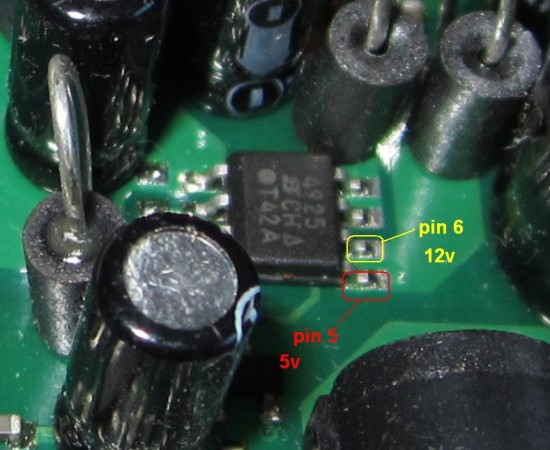

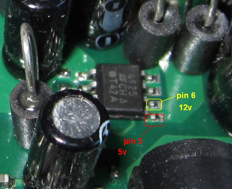

The MOSFETs are controlled by the PL-2507 bridge via the Gate pins. The Source pins are connected to +12V and +5V. If you short gate-to-source, then you will impress the corresponding supply voltage directly onto the bridge, thereby destroying it.
Gotcha. It's getting kinda late here, so I think I may just leave this 'til the morning when I'm fresher if you don't mind.
In the meantime, just to take the stress out of the operation (and thus steady the old hand), could I trouble you to confirm the pin voltages on the below pic? Cheers, and thanks for all your help. I really appreciate it.

Pins 5 & 6 are wired together, so they should be at the same potential. Likewise with pins 7 & 8.
If I'm correct in my assumption that the dual MOSFET is switching 12V/5V power to the drive, then one would expect to find 12V on one pair of Drain pins, and 5V on the other pair. You can easily and safely confirm that this should be the case by measuring the resistance (with the power switched off) between the red (+5V) wire in the Molex connector and each of the drain pairs. This will tell you which drain pins are switching the +5V supply to the drive. Similarly, you could determine the +12V drain pins by metering their resistance to the yellow (+12V) wire.
Rather than metering the dangerous "busy" areas around the MOSFET, you could determine if +5V exists by measuring the voltage at the coil adjacent to the MC34063 IC. Of course you will need to do this with the power applied.

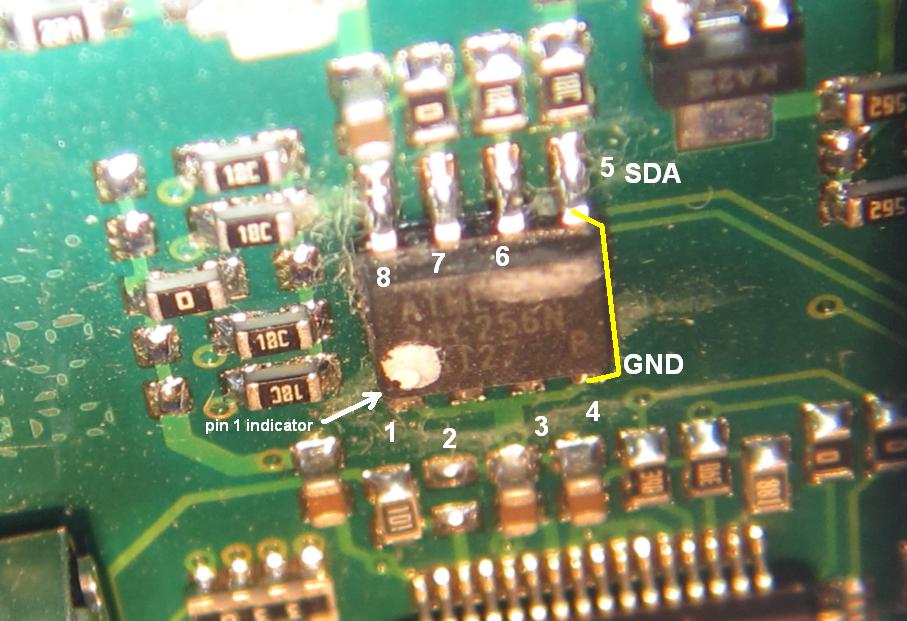

I am not suggesting that you permanently invalidate the EEPROM.
At the moment you are getting no response from the bridge IC. It could be that the bridge is dead, or it could be that there is a firmware problem on the bridge board, or a dead crystal, etc. By making the bridge IC believe that there is no external EEPROM, you will force it to rely on its internal ROM based firmware. If the bridge IC is alive, then it will enumerate as a Prolific device. You will be able to see this with a tool such as USBDeview.
http://www.nirsoft.net/utils/usb_devices_view.html
Once you have completed this test, then you can restore the board to its original state. In fact some people short the relevant pins with tweezers, in which case there would be nothing to undo.

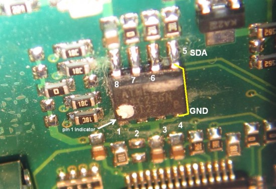

PS: I've had the chance to test USB continuity from the host plug end to the device receptacle end: seems fine.
I guess that means we proceed with the eeprom shorting. Can I just confirm the pins with you here (seeing as I made such a jumble of things earlier) please?
Here's how I think things stand:
I'm planning on using tweezers. I am right in thinking NC, A0 and A1 are all connected to GND, yes? It will make the task easier knowing this.
Thanks for your help.
