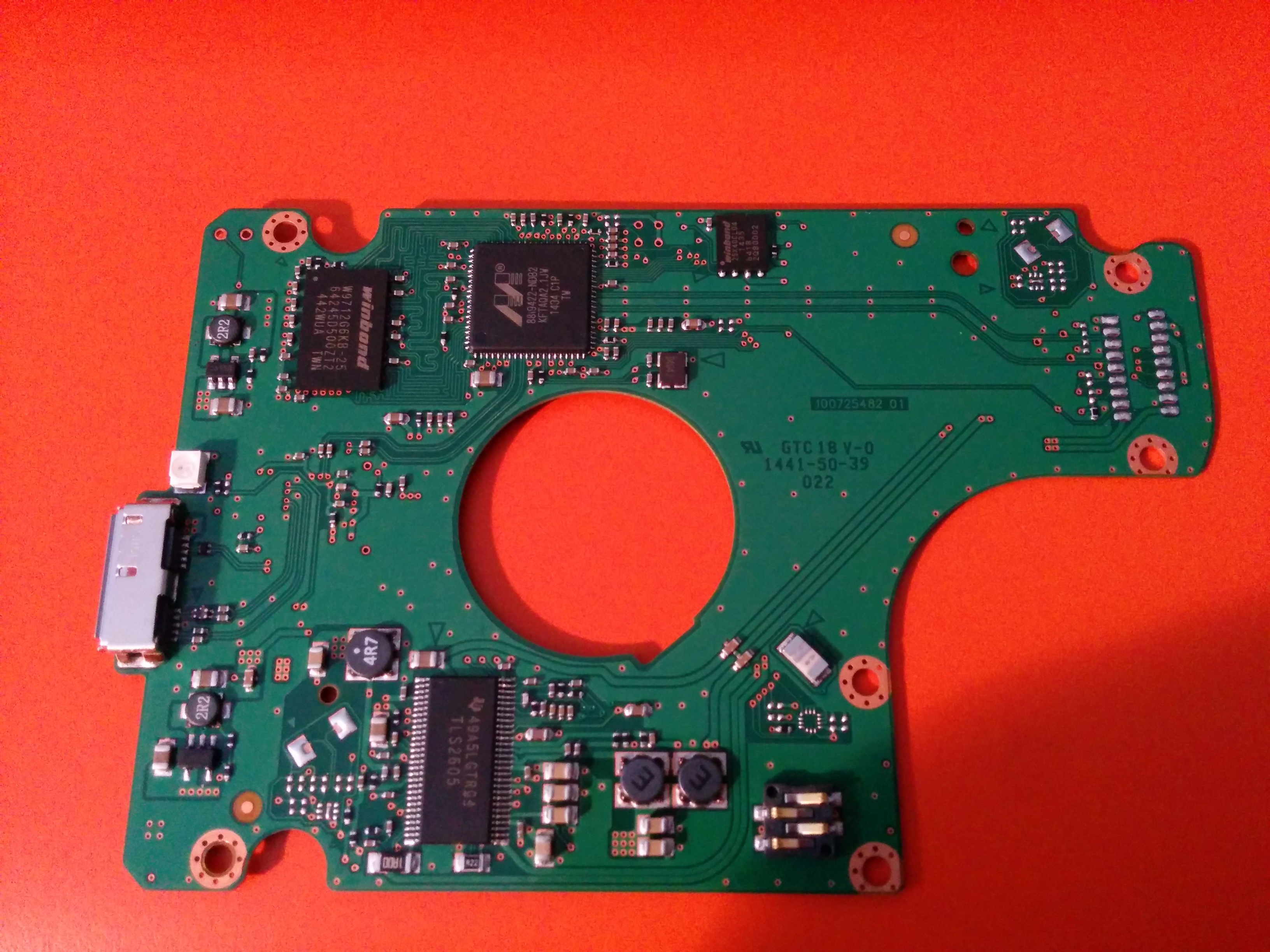

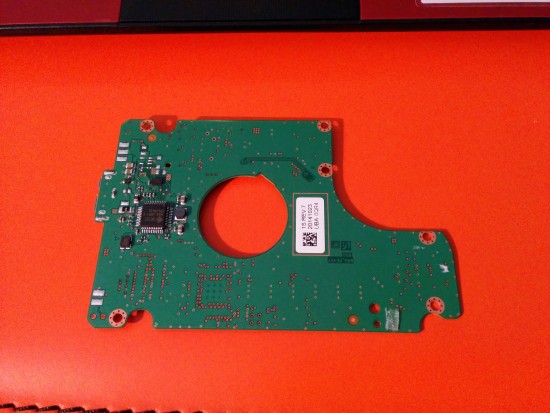

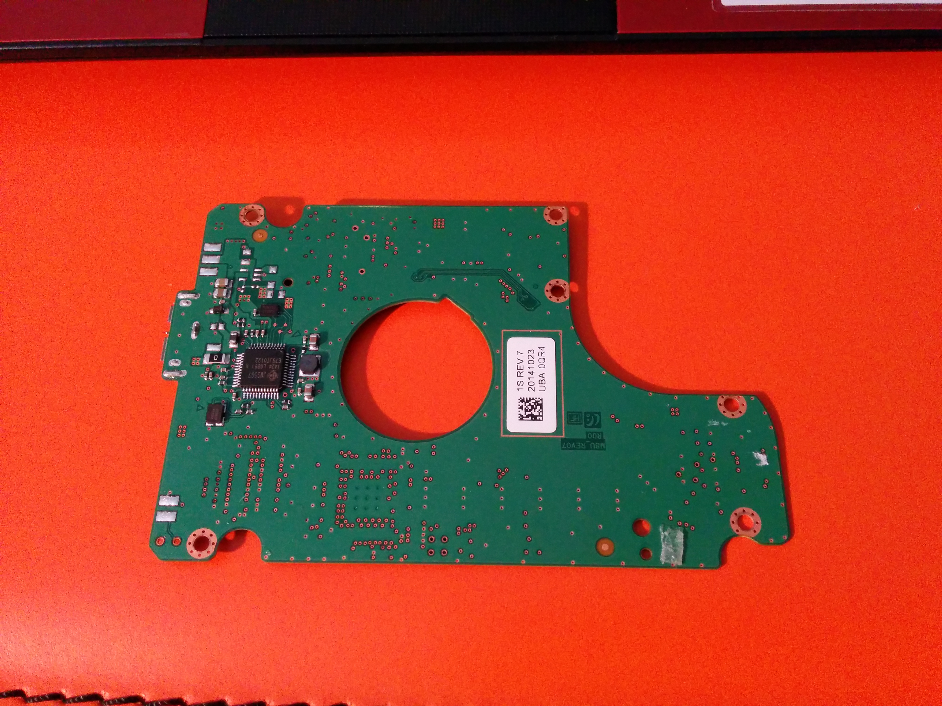

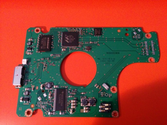

Rear and front view. Here they are. Thanks a lot.

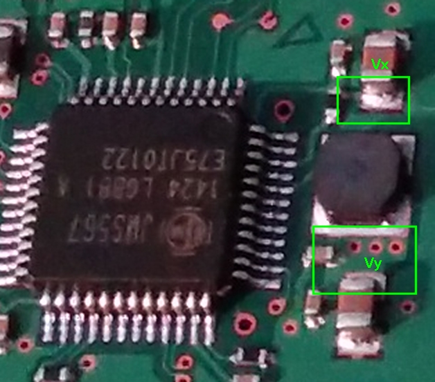

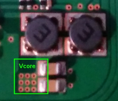

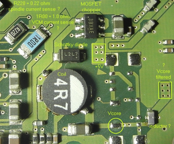

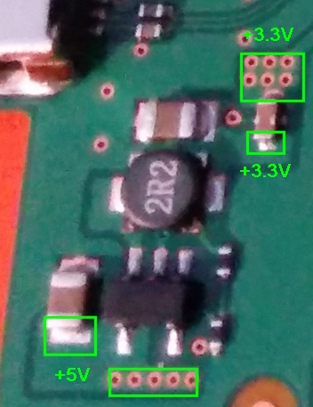

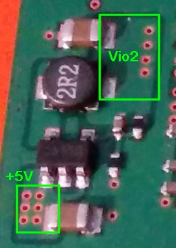

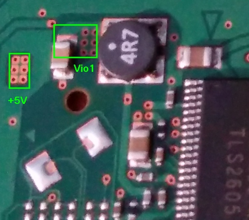

I've marked my best guesses as to the voltage test points.

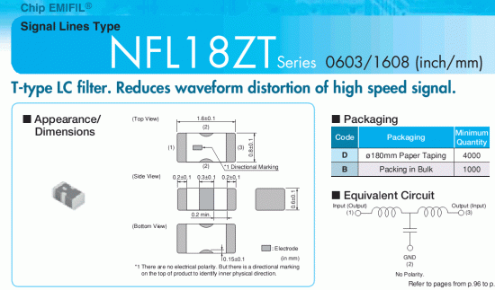

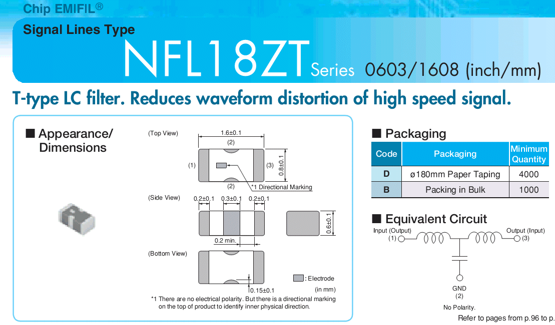

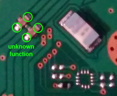

ISTR another thread where a user determined that there was a fault in the component that filters the output of the 3.3V bridge supply (see first attachment). I suspect that it may be a low pass T-type LC filter. The Murata device looks like it might fit the bill, although it is specified for signal lines rather than power lines. The same component appears to be used in the "unknown function".
NFL18ZT, Murata, T-type LC filter, EMI suppression for signal lines:
http://www.murata.com/en-us/api/pdfdown ... 107H1A3%23
http://www.mouser.com/ds/2/281/c51e-794816.pdf
http://www.murata.com/~/media/webrenewa ... ashx?la=en
I tested all of the checkpoints, but voltage is zero for each. I grounded both the PCB and the voltmeter to a common metal body (old damaged eide HDD).
Something is wrong with power supply, it seems. Is there a way to supply power bypassing the USB interface? I could try and provide 5v at some point on the PCB. I should find the right contacts on the available side, naturally, not the one facing the HDD. Or would it make sense to try and do that without screwing the PCB onto the HDD and connecting via the terminal?

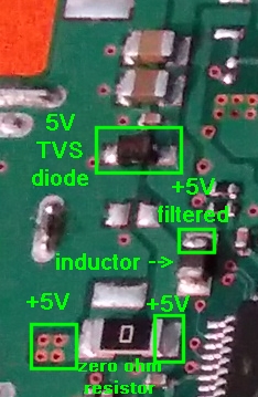

I found this thread and tried the checkpoint "Point A". It seems to be the same problem as it was for the guy.
https://forum.hddguru.com/viewtopic.php ... ile=mobile
Pushing slightly the solder of the black component causes the led to light up!! So maybe I only need to "reflow the solder". And here comes the problem: what does it mean? I think it means to heat up (not too much) the solder, cause it to become soft and stick again so that the contact gets back to functioning... am I right? you can laugh...
 Post subject: Re: ST1000LM025 - Unusual case
PostPosted: April 10th, 2016, 13:44
Posts: 17316
Yes, that's right. You can wet it with a little bit of fresh solder, if necessary.
Best of luck.
BTW, I don't understand how you were able to measure 3.3V at Tx/Rx if this component was open circuit.

I have added the test points for the TVS diode and associated components.
For the benefit of others, that "unknown" component could be a 3-terminal capacitor rather than an LC filter:
NFM18PC, Murata, EMIFIL 3-terminal SeriesFeed Through Capacitor for power lines:
http://search.murata.co.jp/Ceramy/image ... FM18PC.pdf
Here is a thread where a user replaced a similar part with an smd fuse:
https://forum.hddguru.com/viewtopic.php?f=1&t=29654
https://forum.hddguru.com/download/file ... &mode=view

Ok, the trick worked great! I've resoldered the 0-ohm resistor (someone will explain what it is for... sounds like a zero-cash bank account) by keeping the soldering iron tip on one endpoint at a time for about 25 secs. I tried the first time keeping it less time because i was afraid to mess it all up and burn something, but it didn't worked. So i embraced my courage and that's it... it worked fine, being my first almost-soldering!

The resistor is often fusible, otherwise the same position can be occupied by an smt fuse. It just depends on how cheap the manufacturer is feeling at the time.
When there is an overvoltage, or reversed polarity, on the +5V USB supply, the 5V TVS diode goes short circuit. This then causes the "fuse" to go open circuit. That said, such a fault is very unlikely for USB powered drives.
BTW, Samsung's HDD PCBs seem to have a lot of problems with dry solder joints, even in their 3.5" drives. I wonder if this may be due to the use of lead-free solder mandated by RoHS. Lead-free solder requires higher soldering temperatures than leaded solder.
