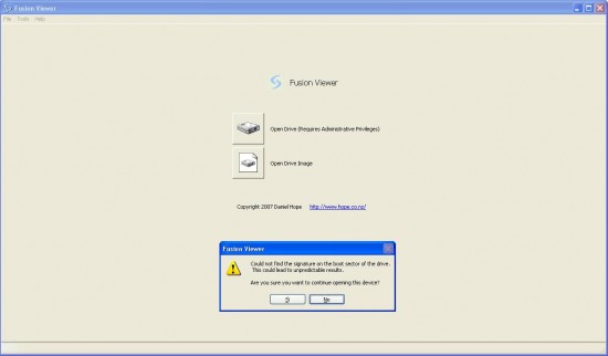

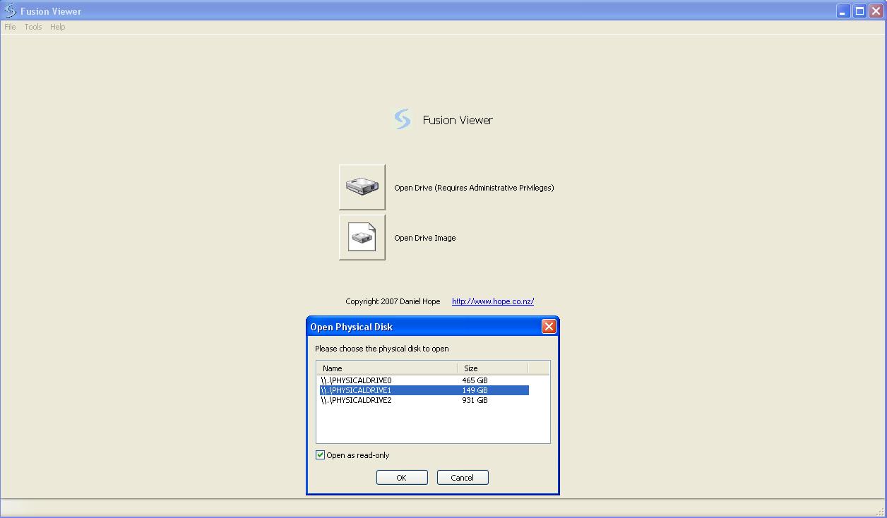

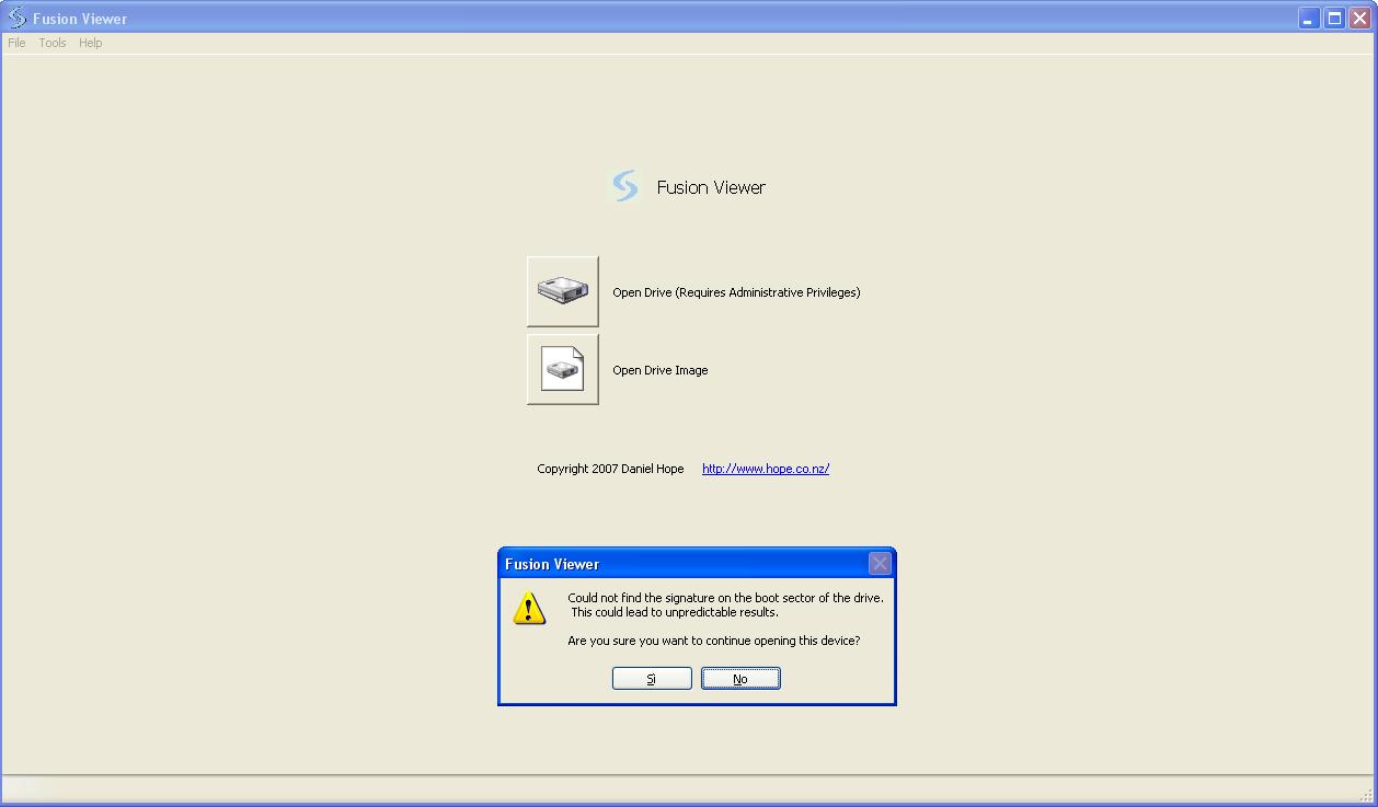

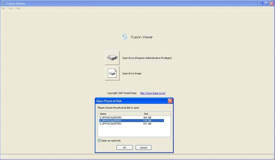

fzabkar is right, this is not linux filesystem so can't be loaded on linux OS.
Also, photorec is for files recovery in raw mode, we need some type of tool which is able to emulate the pvr partition in windows so then we will be able to see folders and files.
I downloaded the Fusion Filesystem Reader:
http://www.hope.co.nz/projects/fusion/
but seems not working, it's not able to read the boot sector
What happens if you ignore the warning? Could you upload the first 16 sectors in BIN form? I'm wondering whether the "boot signature" is actually a checksum.
In any case ISTM that the similarity between the OP's file system and that which is described on Daniel Hope's web page is too much to dismiss lightly. In fact the cluster sizes and partition sizes that I've calculated correspond exactly to those in Daniel Hope's screenshots.

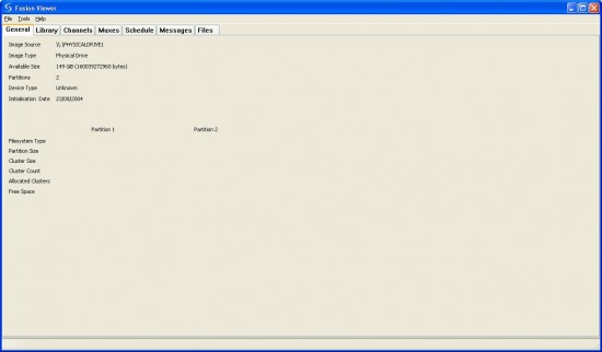

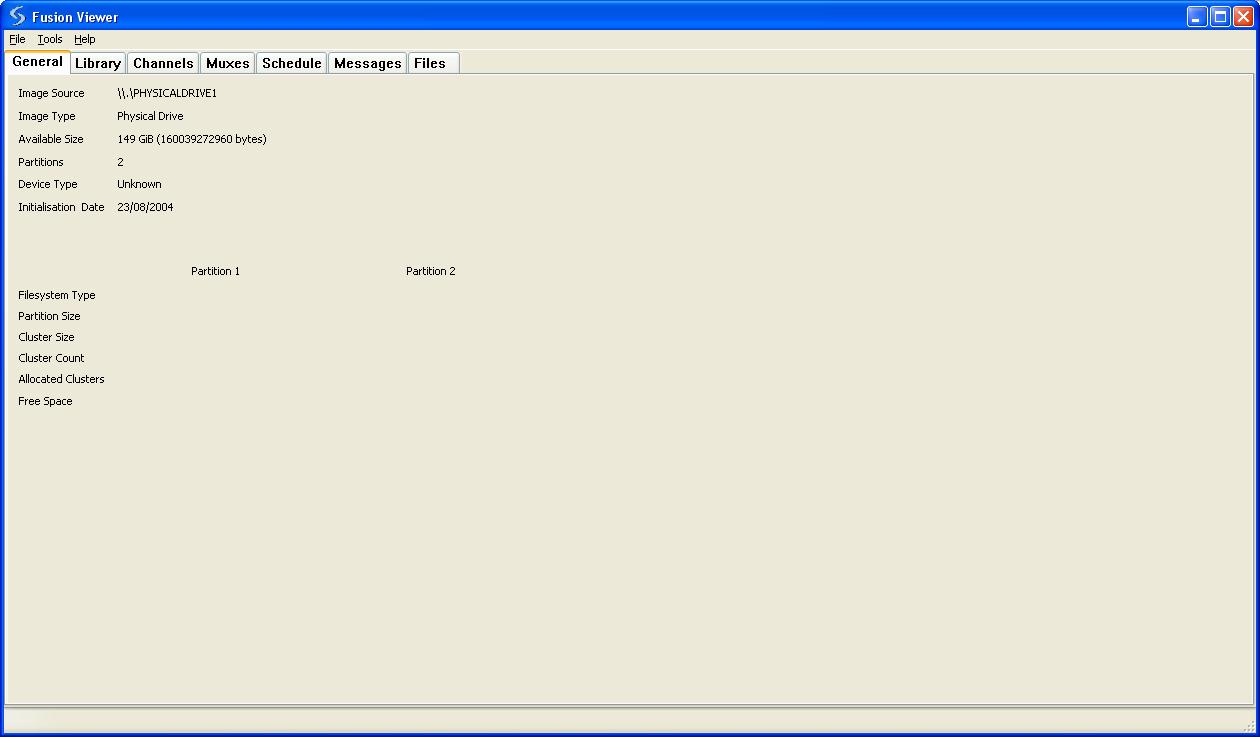

It happens nothing, see the pic:

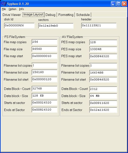

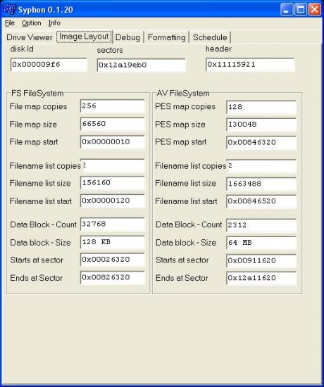

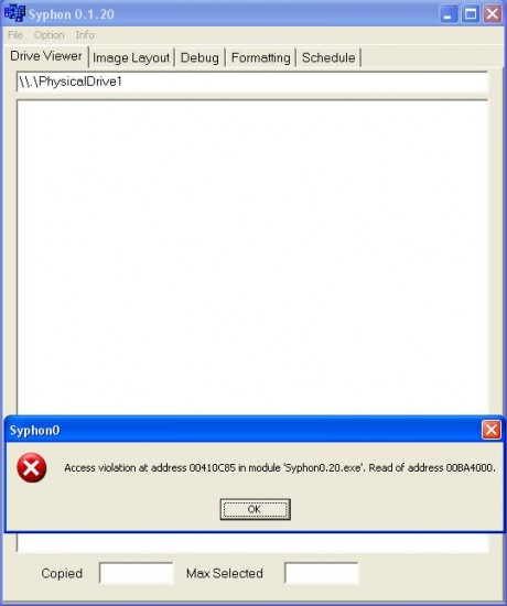

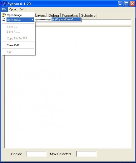

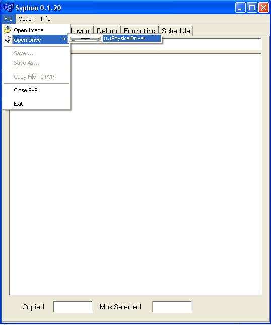

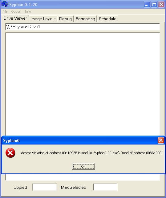

I used also the second tool, the pvr partition s still not detect in windows but i can see some infos:

I've been in touch with the author of the Fusion reader (Daniel Hope) and he has kindly given me the boot sector information from his source code (I'm waiting for his permission to publish it). The structure appears to be identical to that in the Syphon screenshot. The boot signature in the Fusion PVRs was 0x31415926 (the value of pi) rather than the OP's 0x11115921, so that accounts for the warning message.
I'm still waiting for confirmation from Daniel, but I suspect that the reason that the Fusion screenshot shows blank partition information may be that it doesn't recognise the partition ID bytes. Offsets 0x30 and 0x98 contain partition IDs of 0x0B for each of the 2 partitions whereas the Fusion reader recognises the following 3 PVR brands and partition IDs:
Fusion / Thomson            Digiality                  Nokia 260T
Std FS       A/V FS         Std FS       A/V FS        Std FS      A/V FS
0x0000000C   0x00000008     0x00000009   0x00000008    0x0000000D  0x00000008
Perhaps you could edit those 2 bytes in sector 0 and try the Fusion reader again? Otherwise there may be a workaround in the Syphon threads at Digitalspy. I would run the program natively on a Windows XP platform rather than in compatibility mode in later Windows versions, assuming that's what you've done.
