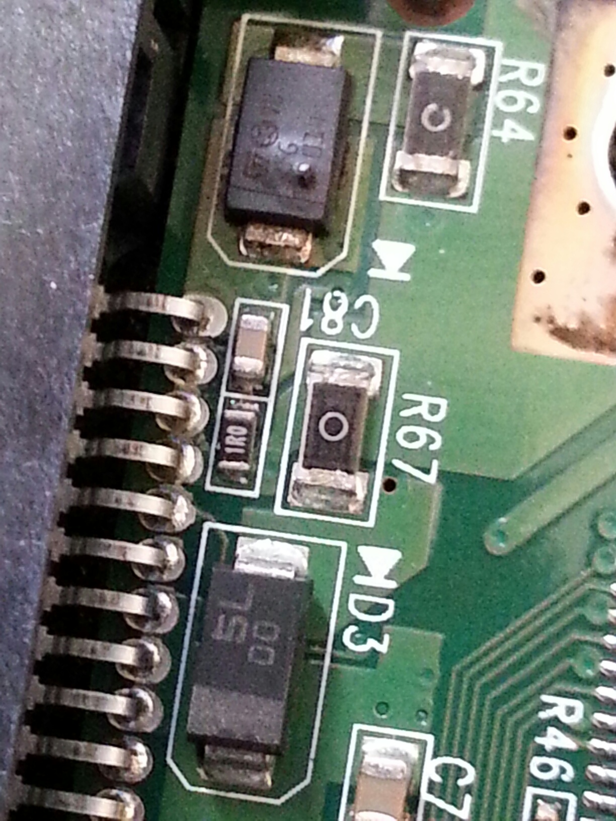

Hi Michael Chiklis & hhddrec,
Thx for your comments. Unfortunately my multimeter is too old (built in the 80's) and it can't test the diodes. I ordered a new one today that I ll receive tomorrow. I will let you know if the tvs on the sata pcb are ok or not.
Best regards

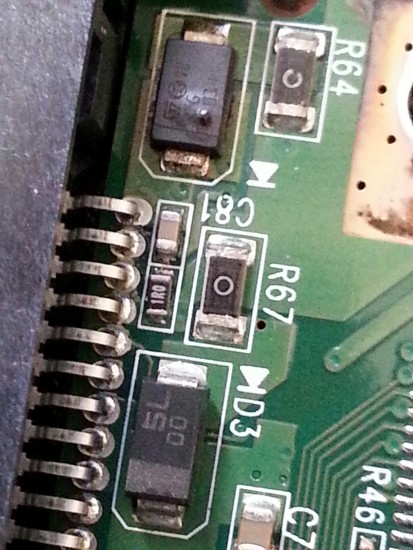

Well it is too late I got my new multimeter this morning. and trust me the old one was really old. I even had the user guide, and Google could not find it. One question Where is the + and the - on the TVS diodes?
I don't see the dark line mentioned in the PDF document!
thank you for your assistance
best regards
0383A
 Post subject: Re: WD Mybook Essential 1tb smoke
PostPosted: June 27th, 2014, 9:55
Joined: June 19th, 2014, 6:37
Posts: 42
Location: Switzerland
So here are the value of the TVS diode:
12V TVS diode: 0.028
D3 5V TVS diode: 0.401
Thanks the new multimeter who inform if connect the black and red to the correct +/- or not!
Now I will have to check the ohms on R64 and R67
PostPosted: June 27th, 2014, 10:11
Posts: 42
For the R64 & R67 I have to measure the resistance (in Ohms value)
is that correct?
if this is right, here are the values measured:
R64: 0.5
R67: 0.5
Thanks in advance for your feedback.
Best regards
0383A

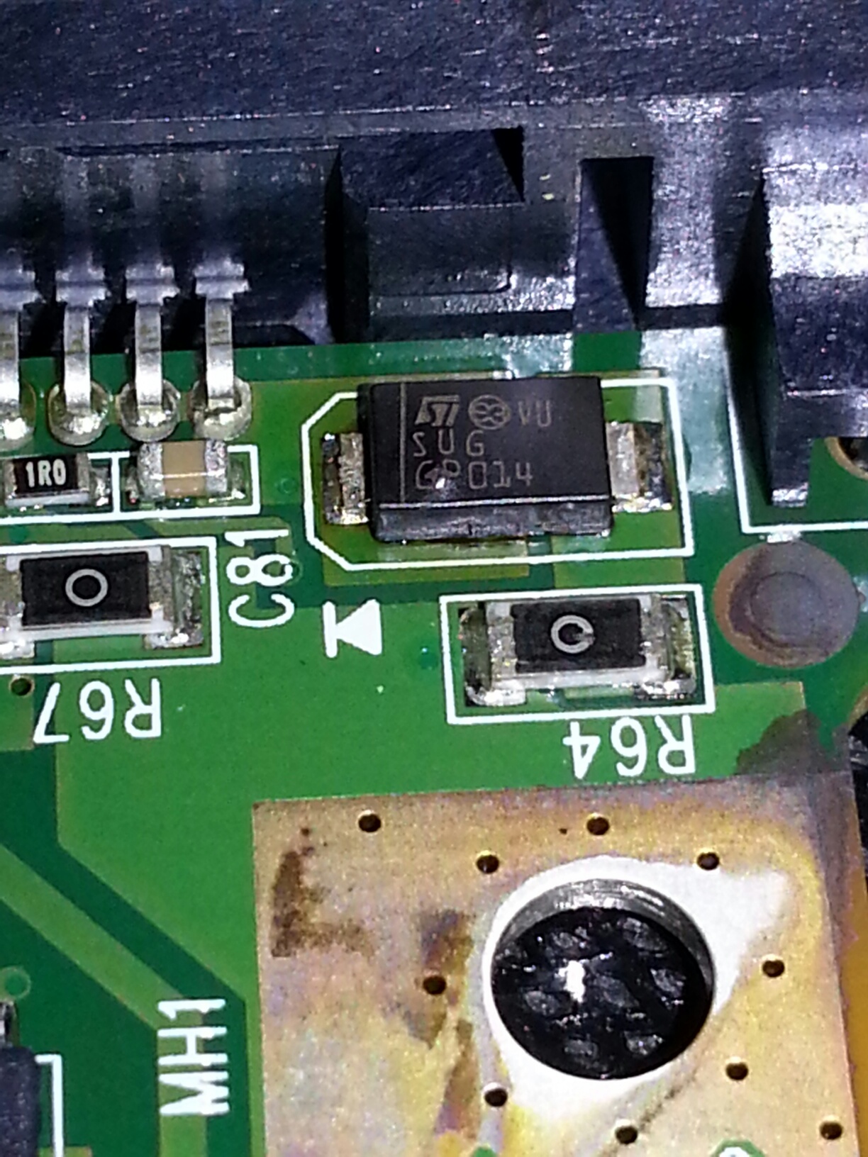

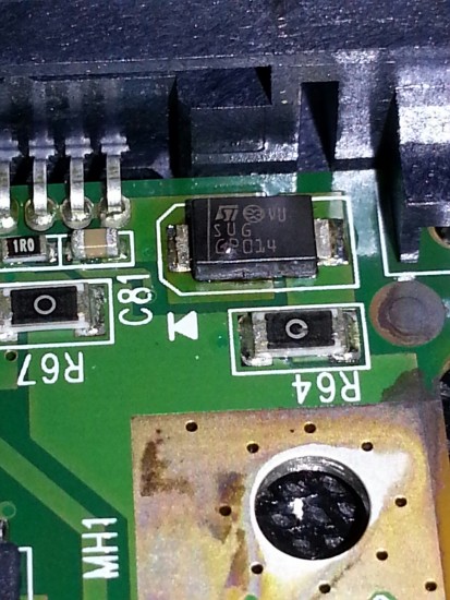

I have taken 2 macro pictures of the 12V TVS diode which I believe shows something not original. There is like a bump on the top of it near GP or GR letters. Here are the pictures:
PostPosted: June 27th, 2014, 12:25
Posts: 811
Location: World
Looks like Diode badly!
Looks like, I ll have to ship both PCBs (the sata one and the usb one) to the Data recovery center for replacement?
PostPosted: June 27th, 2014, 12:33
Posts: 927
Location: uk
0383A wrote:
No!
You can carefully remove the damaged tvs diode. If you are lucky the drive will work.

Unsoldering bad TVS diodes could work, but usually i prefer to replace them.
If something goes wrong when you will apply again the power supply you might kill head pre-amp without TVS (assuming that pre-amp is not already damaged).
By using new TVS, head pre-amp and pcb circuit should be safer.
If you want i can do this job for you, i have TVS diodes for replacement, i'm in Italy (not far from Switzerland)
PostPosted: June 27th, 2014, 16:00
Posts: 17092
I have seen many similar cases in WD's forums. The usual result is a shorted 12V TVS diode. If R64 survives, as it has in the OP's case, then the drive is usually OK after removing the diode. You can use flush cutters to do this. You don't actually need to desolder the diode. In fact you may even be able to use finger nail clippers. Just be careful not to lift the copper tracks.
A local TV/AV repair shop should be able to replace the diode. My FAQ lists suitable replacements and sources.
There are ways to repair the bridge PCB without having to purchase any parts, but you would need a little soldering skill and some understanding of electronics.
