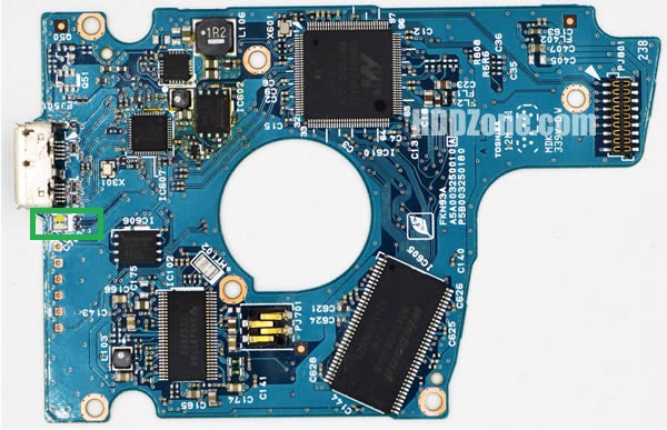

Hi, everyone,
I have a couple questions about this specific drive and if you think a new board would help.
Out of nowhere the drive just stopped working. It was fine one day, and the next it is just dead. The drive doesn't light up when I connect it to a computer, no sounds, OS doesn't recognize it. I tried different cables and different computers.
I was hoping that the interface is just bad and the drive is OK. I just had to do a data restore on a seagate drive and it cost $700. I really don't want to have to do it again.
Do you think this sounds like a bad board? I tried to remove it to make sure everyone was connected, but one of the screws is stripped and couldn't get the all off. Any tips on dealing with a stripped screw when they are so small?
Thanks for any help;
Re: Convert USB Toshiba MQ01UBD100 to SATA
May 21st, 2020, 3:00
There are two fuses near the USB port.
May 21st, 2020, 22:19
Thanks for reply. I'm taking from that that you think one or both of the fuses might have blown?
Are they the two yellowish looking pieces that I have boxed out in green on the attached image?
Do they just pop out to replace? They look like they were soldered in.
Thanks again
May 21st, 2020, 23:35
Here they are:
