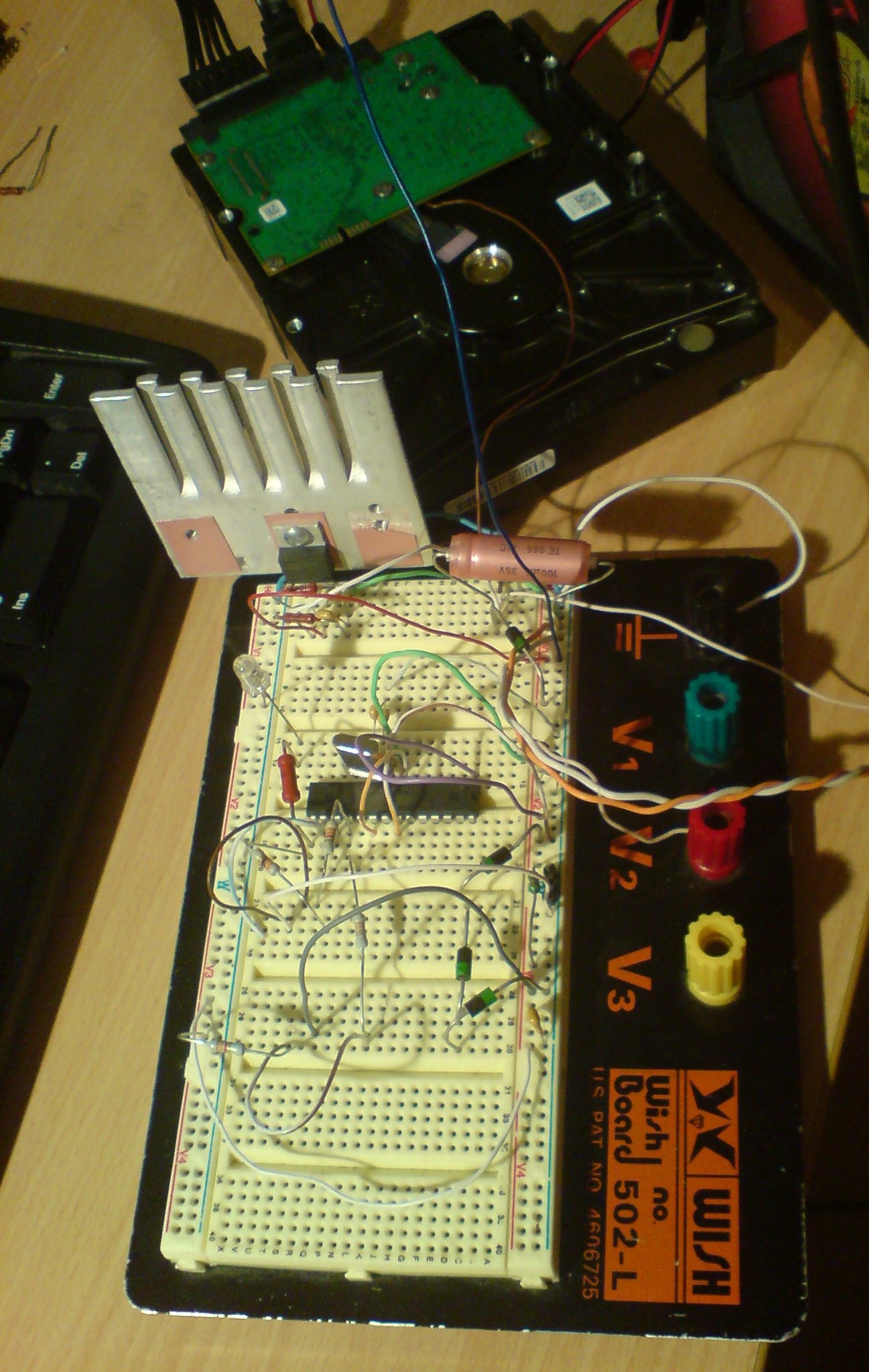

HOLY SHIT I ACCidentaly removed LM338 feedback divider, voltage fell to 1,25V and disk booted up !!! IT WORKS, BACKUPING LIKE CRAZY
I would write more, but i cant i have to backup most important data, then maybe do image

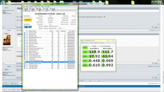

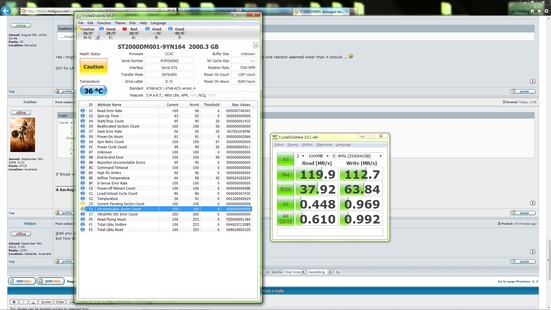

Here is pic of status in Crystal disk info it has few uncorectble sectors (because of dust). Ignore that BAD HDD, it is just for trash data and it actualy works for 2 years since it went bad :D
I backed up everything I knew that I want and If i forget something, I ll just power up it again :)
Anyway, thank you all, you helped me very much, especially you fzabkar :D

Oh god, I have completely forgot that ... I feel like an idiot now. It is miracle MCU survived 1.8V. Well, nobody came smart and experienced :) I ll desolder Rfb1 and measure it tomorrow.
HDD could work like new even without opening it, but it probably wont because i forgot how to measure resistors and opened it, but who would use repaired disk for important data ? :)
Never mind, data is saved and I ll probably buy new HDDs to RAID1 and maybe I ll use this for unimportant data, I ll just have to add some 1,2V regulator which will fit to it (LM338 is too big and and eats too much power).
HaQue: I went eat and forgot to disconect HDD from power, when I came back I thought I turned it off (I did not check if it was really disconected). I tried to use different feedback resistors (with different voltages i had different logs), when i removed it, feedback pin was left grounded by second feedback resistor and that caused voltage fell to 1.25V, terminal started writing new messages and windows wrote new hardware detected... Now that was luck !

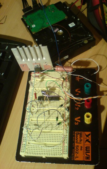

Here is one photo :) LM + Flash programmer (It looks weird, but it works). Brown wire is 1.25V, ground is through PC PSU, I cool it with PC fan.
And one screen from crystaldiskmark
It acts like if I never opened it in dirty enviroment (only these few uncorectable sectors in SMART).
 Post subject: Re: ST2000DM001 damaged electronics
PostPosted: August 13th, 2014, 0:09
Posts: 17323
Ironically, despite all the "bad" things you've done to your drive, its Read Error Rate has improved from 105 to 109. :-)
The Total LBAs Read has increased by 36GiB in the last two CrystlaDiskInfo screenshots, yet the raw error counts have remained the same, as you have said.
(0x8624ee0325 - 0x8620645a23) x 512 bytes = 36.3 GiB
ISTM that you should buy a lottery ticket. :-)
BTW, you might be able to cannibalise a cheap 1V SMPS from an old socket 7 motherboard (by cutting it out with a hacksaw), or you could adapt a 12V car charger from an old mobile phone. Some were based around an MC34063.

What is the max current MCU can take ? I have found old, completely disassembled HDD ST3500820AS (I have only PCB and body with motor, it was friend´s disk which stopped working long time ago and he wanted to see what is inside, so we disassembled it and because it spinned, we made grinder from it :lol: ), it has small ST1S06A ICs, so I might create small PCB and use them. Datasheet says it can supply 1.5A (LX could 3A) but I think that MCU wouldnt eat more than 1A, because these coils on my PCB seems to be too small to be able to transfer more than 1A. I have one Socket7 MB but I dont want to destroy it :) . Using these small ICs would be nice small workaround, wouldn't it ?

You could insert an 0.22 or 0.47 ohm resistor in the supply line to the LM338 and monitor its voltage drop. That should tell you the MCU's current draw. I would do this when the MCU is reading or writing.
