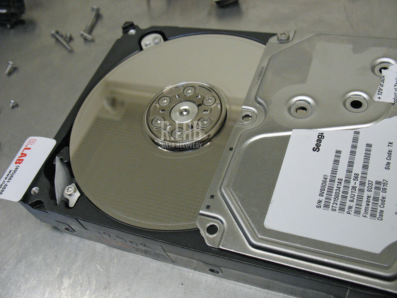

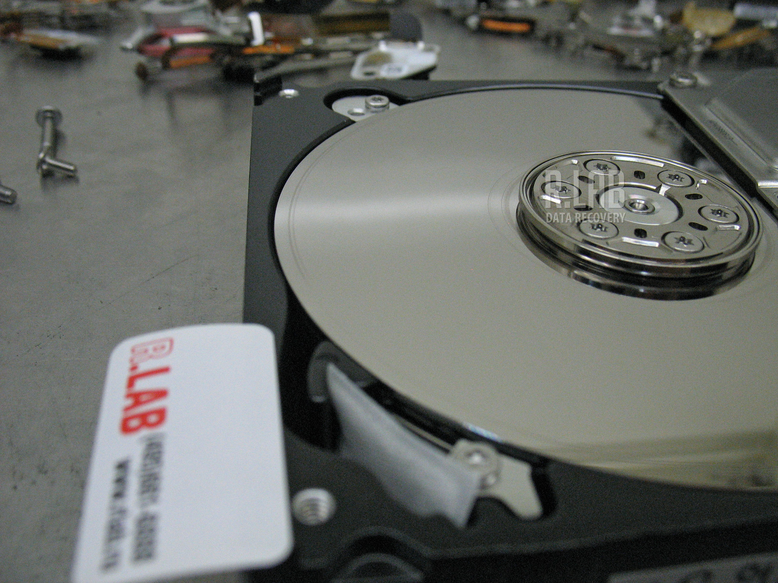

Getting back late, as Xsan kept us quite busy. I got some spare time finally, so made a few pictures promised.
I took two photos for each drive to give a clearer idea of the situation. Did my best when shooting, hopefully media damage is discernible.
To speed the things up I decided to pick the drives with a mechanical damage on the top surface, which are visible without platters removal.
First one is Seagate ST31500341AS. This is a completed job, results have been accepted by the client.
We have recovered approx. 70% of data from the hard drive.
Jobs like this have much better chances than like one in the next post.
File comment: Seagate HDD with scratched platters
File comment: Seagate hard drive with damaged media

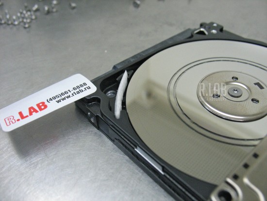

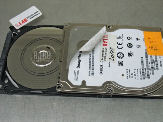

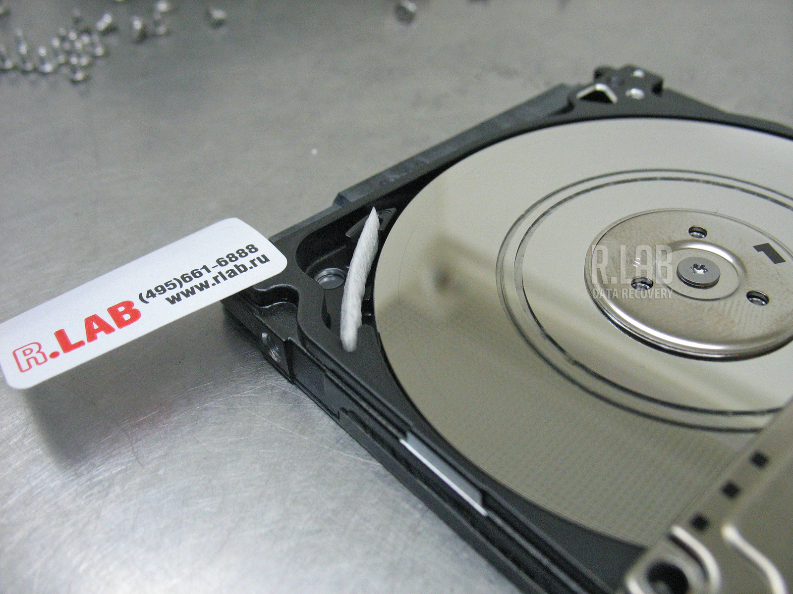

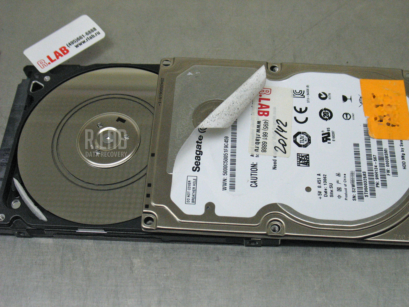

 Post subject: Seagate HDD with scratched platter we're working on (photos)
PostPosted: October 3rd, 2014, 6:05
Posts: 456
Second drive is Seagate ST9500325AS. Situation with it is considerably worse: besides the scratch is more severe, dust settling on the platters makes data extraction much more problematic. There are damages on the lower surfaces as well.
This job is in progress and I'd say the most optimistic recovery forecast is 5% of user data.
This drive already killed two donor head stacks, but the client needs data desperately, so we keep working on it.
File comment: Laptop hard drive with severe media damage
File comment: Seagate hard drive with concentric scratch

Hi dmitri!
about ST31500341AS case: disabling 1 head?

and about ST9500325AS case
trying to read data until heads crash, exchange it for new ones, read another time until headscras another time, and so on?
