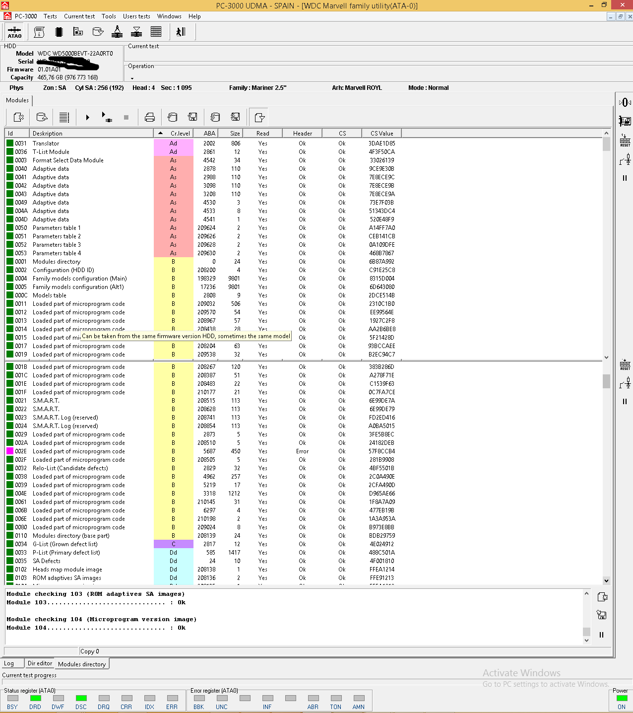

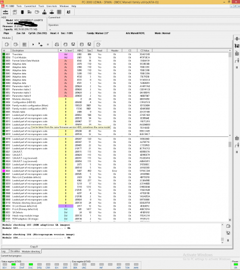

Hi Fran, Thanks for your help
I,ll upload it, but i think this is not the problem, because i tryed to repair manually module and write it, but i can not rewrite it i get error.

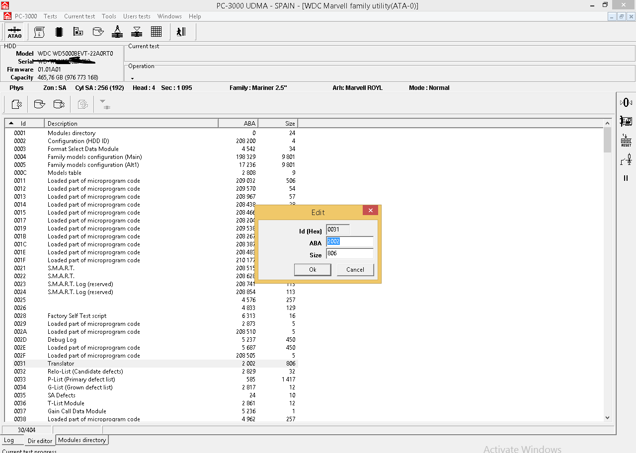

Location: Egypt
this mean this module place in SA have bad esctors did you try to shift this module to another empty place on Sa
you can do it by dir editor in your pc3k or more easy way by DFl

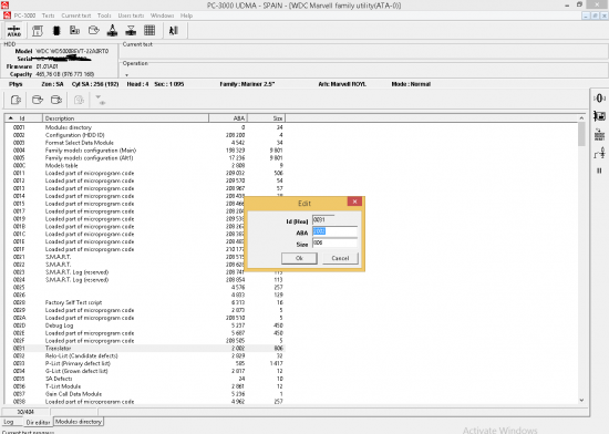

Hi tawfeek_mokhtar, good option too, but now solved
 Post subject: Re: Any Way to recover Translator on WDC WD5000BEVT-22A0RT0?
PostPosted: September 11th, 2014, 9:50
Posts: 811
Location: World
Solved as you can see on mod directory
