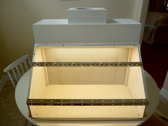

Do you think there's any difference in having a top->bottom compared to back->front airflow?
There are a lot of opinions but I haven't come across any systematic analysis/testing of the benefits of one over the other. I think it comes down to personal preference or just throwing the dice. Some people find the breeze in the face bothersome after prolonged use with horizontal units. I wear glasses so it doesn't bother me.
I've tried both with version 1 of my project, and I prefer horizontal because I've seen particles fall onto the platters with vertical when I accidentally touched my head to the cover while peering closely at the drive. With horizontal and good air flow, I believe that is less likely to happen.

Thanks! It cost me $275 CAD and about 12 days of part-time effort to build. The parts list and individual costs are in the first post. The cost does not include the cost of a high-pitch blade (for especially smooth cuts in plywood) for my 7 1/4" saw, because it will be used for other purposes. Just as the cost of my drill, etc. are not included.

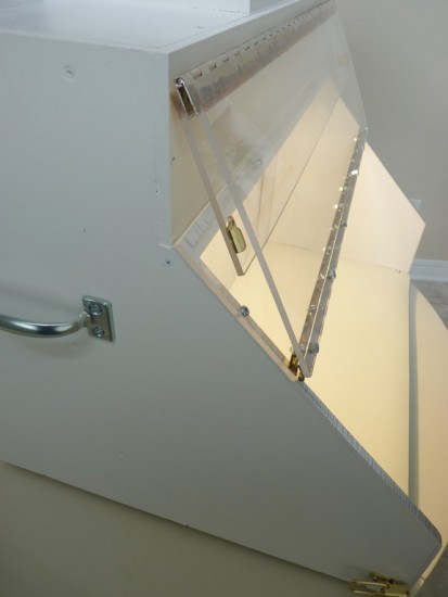

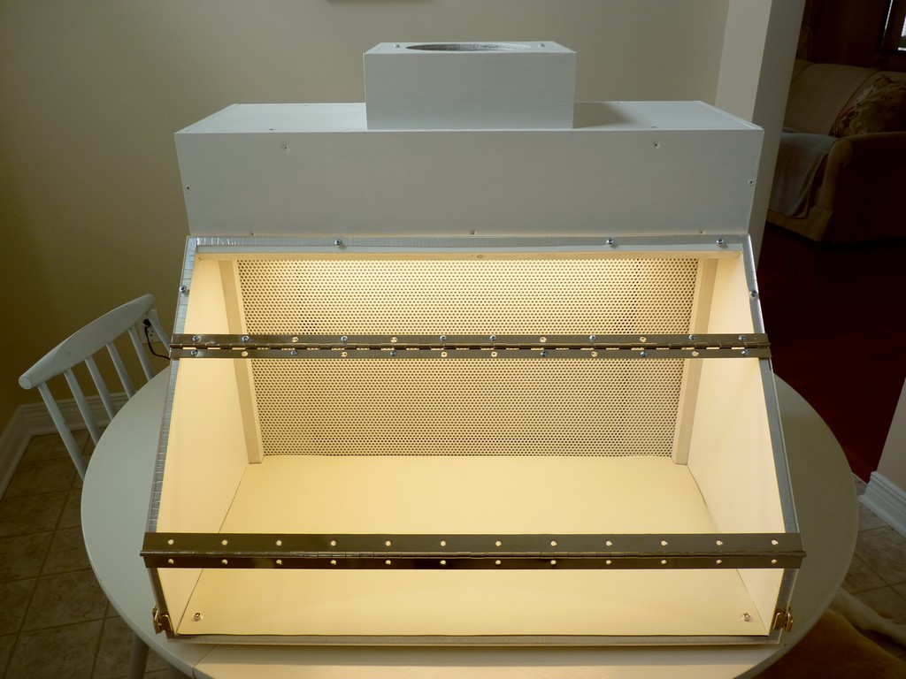

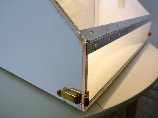

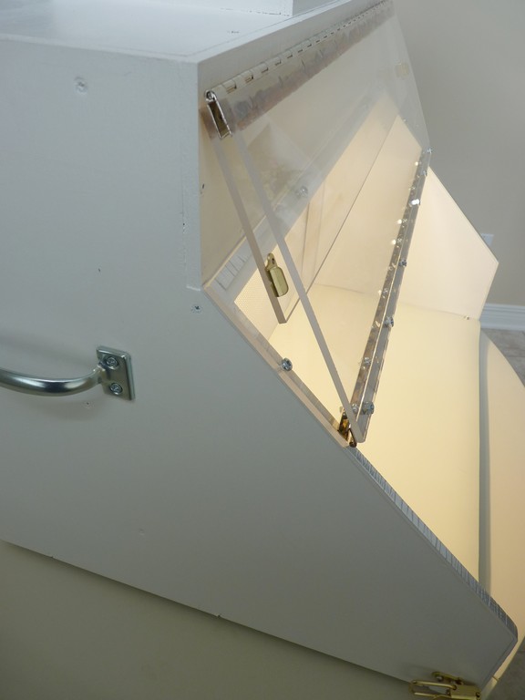

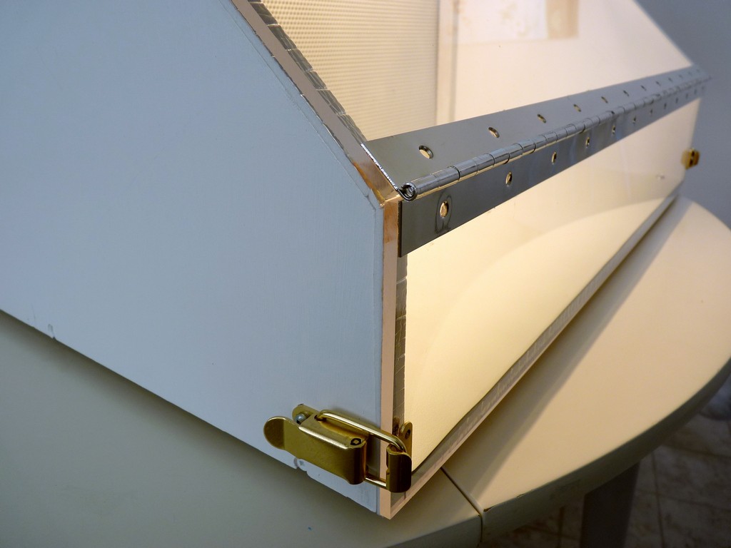

@dragonsrage99, my apologies for the late reply -- I just came across your post. Yes, I still use it and it has worked perfectly for me. While I wish it were larger, to hold all the head comb kits, tools, etc., I don't do enough data recovery to justify building a larger unit. This one is more than adequate.
I did build another one for a colleague to use in a mobile setup. It's narrower (24" vs 30" wide) but deeper (12" vs 10 1/2") and runs off the vehicle battery+inverter but still uses the same 110v motor as the V2 version. Because it is transported in a vehicle, I added a layer of 1/8" x 3/8" closed-cell weatherstripping between the acrylic cover and the enclosure, plus snap-down clasps to keep it tightly sealed when not in use. It also uses a filter that is larger (14.25" x 18" x 2.8"), more effective (99.97% @ 0.1 micron) and is user changeable. The unit has a LED (rather than CFL) light.
Here are a few pictures of V2.1, as I named it.

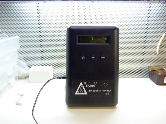

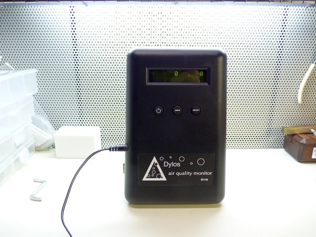

It works great, thanks! I use it all the time -- well, as much as I have DR that requires internal inspection, head swaps and curing stiction. DR is an adjunct to my computer repair business, so I might get just 3 -4 cases a month. Nevertheless, it's an important supplement to my income and would be much less it I didn't have the clean chamber.
I tested it's effectiveness with a Dylos laser particle counter and verified that the cabinet provides class 100 conditions, as you can see here.

It works great; I use it all the time -- well 3-4 times a month, given that DR is just an adjunct to my computer repair business. Nevertheless, it's a valuable addition to my income and is much higher than it would be without the clean chamber.
I have verified that the cabinet provides Class 100 conditions, as can be see here.
What else would you like to know?
Larry

I was just going to ask you to measure air particles with a meter. It looks great, I will try to replicate its cabin in aluminum instead of wood. Does the HEPA 14 filter come in various sizes? Do you also have pre-filters before you get to the HEPA filter?
