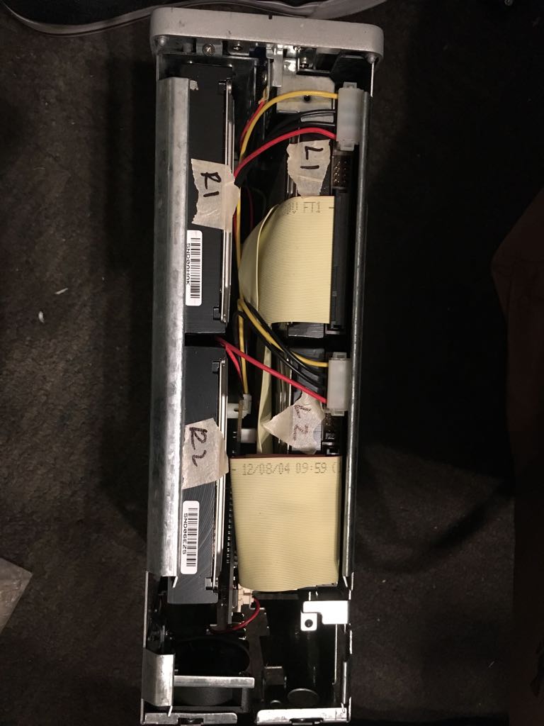

OK, I believe I've found the order and stripe size for the two raid 0 arrays (disk 04 & 01, disk 03 & 02, 128kb) but not sure of the stripe size / offset for the JBOD...

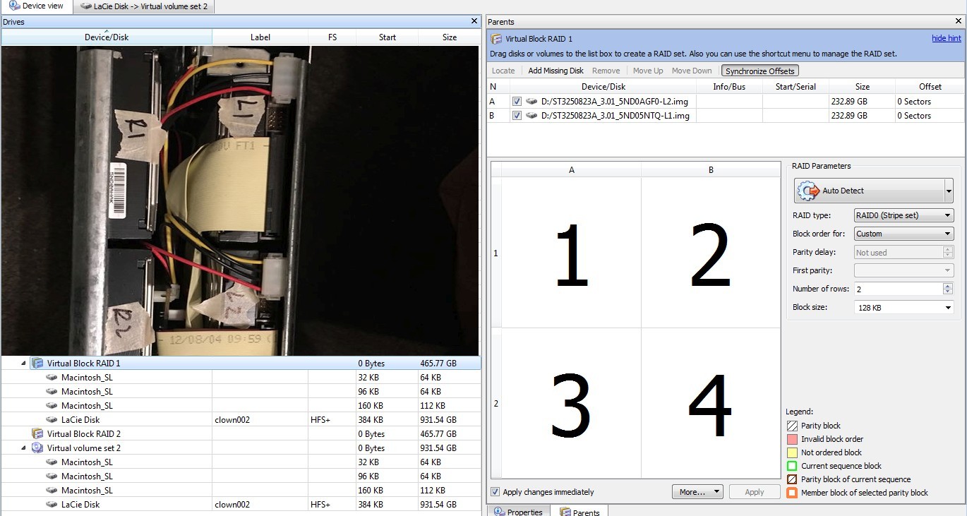

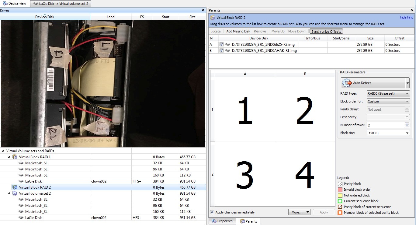

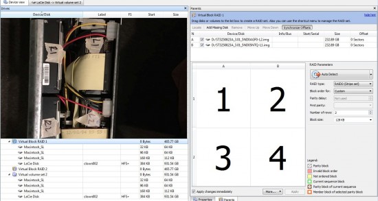

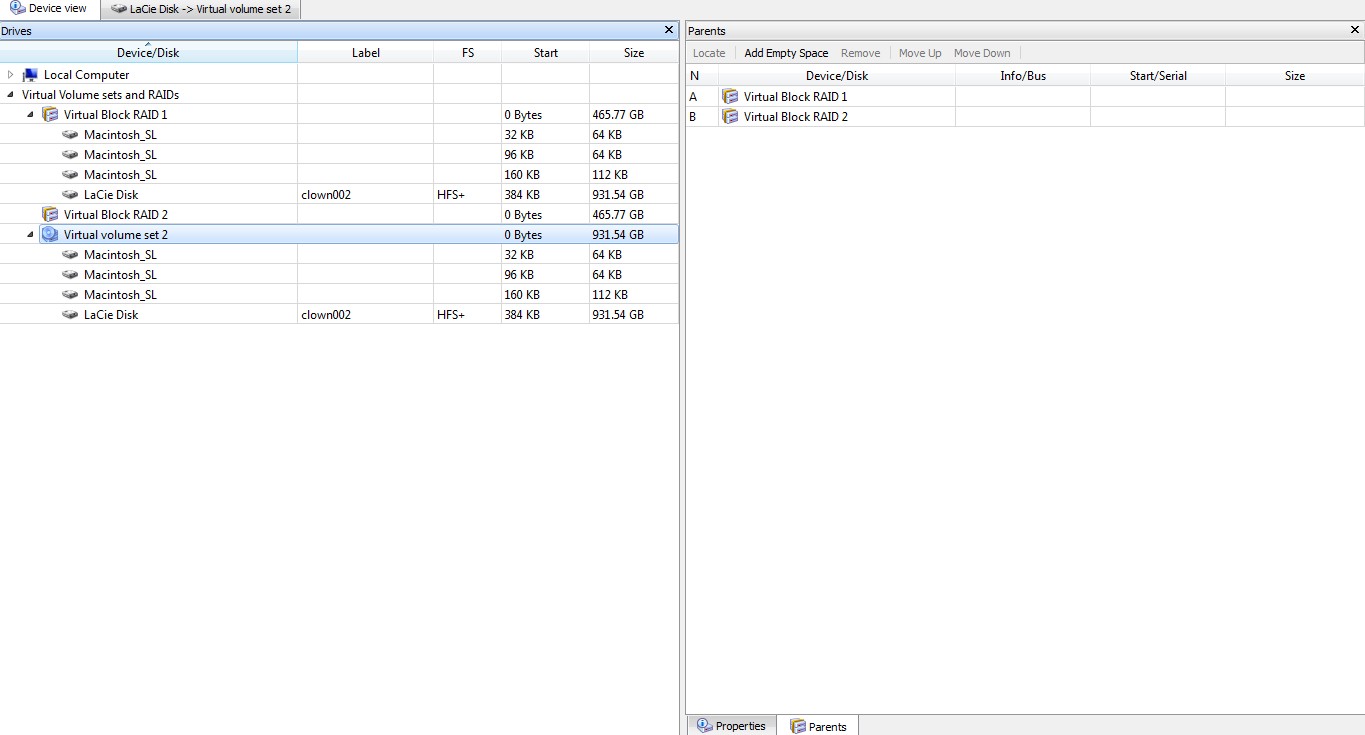

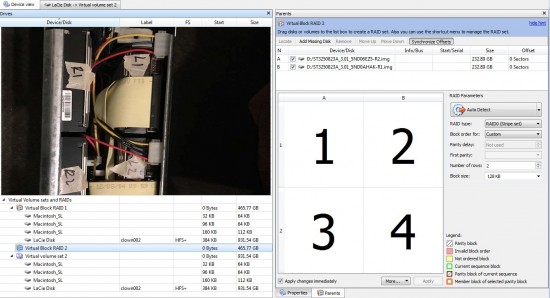

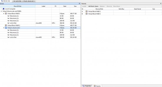

Old discussion but sharing is caring ...
After spending some hours I wanted to share my success with the help of this page.
2 RAID0 and a final JBOD , Block Size 128KB or 256 sectors, all offsets 0
JBOD ( RAID0 ( 1st row ) + RAID0 ( 2nd row ) )
Check images for RStudio Raid config.
Thanks alot to everyone , hope this helps more people in the future.
A
That is correct configuration. Well done . ;)
Angel Data Recovery

OP here, just wanted to give thanks to macwest for posting the details on the RAID0 + JBOD config on these old models. Just came across a 2TB version of this model and this discussion helped crack the case.
