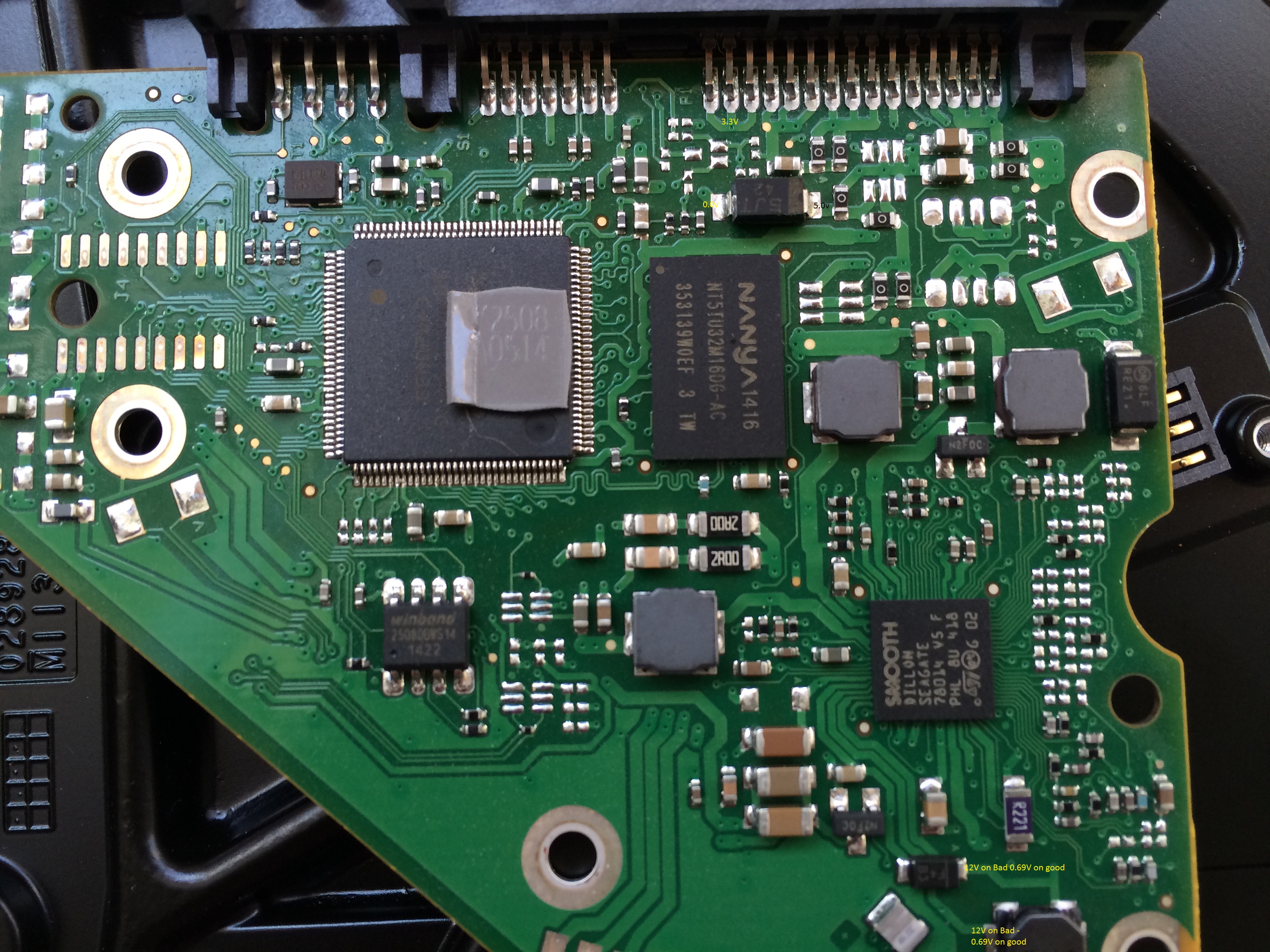

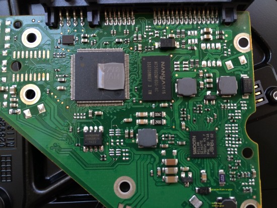

Latest - update. I checked voltages across the PCB in various locations and compared against good PCB and bad PCB. Near one coil on PCB with bad drive - I am getting 12V and on PCB with good drive; I am getting 0.69V. See picture attached below. Does it mean something is blown? Any idea which component is blown? Also does it also guarantee ROM chip swap would work (assuming I get identical rev PCB?).
Sorry - just realized that voltage text is very small. The place with difference is at the bottom right of the board.
File comment: PCB with voltage differences - text is hard to read - but it is at the bottom right.

@quasimatter, I'm not sure what that particular coil does, but I'm wondering if it generates the boost voltage for the VCM circuit.
It would help me understand the circuit if you could indicate the voltages at the other three coils plus the diode at the centre-right edge of the PCB.
It might also help to obtain a serial terminal log from the drive's diagnostic port.

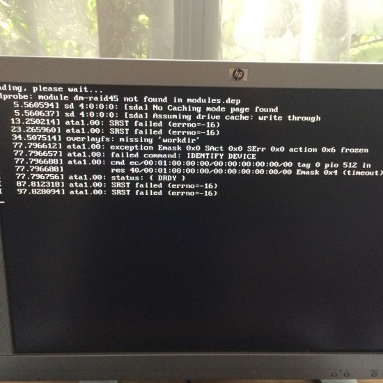

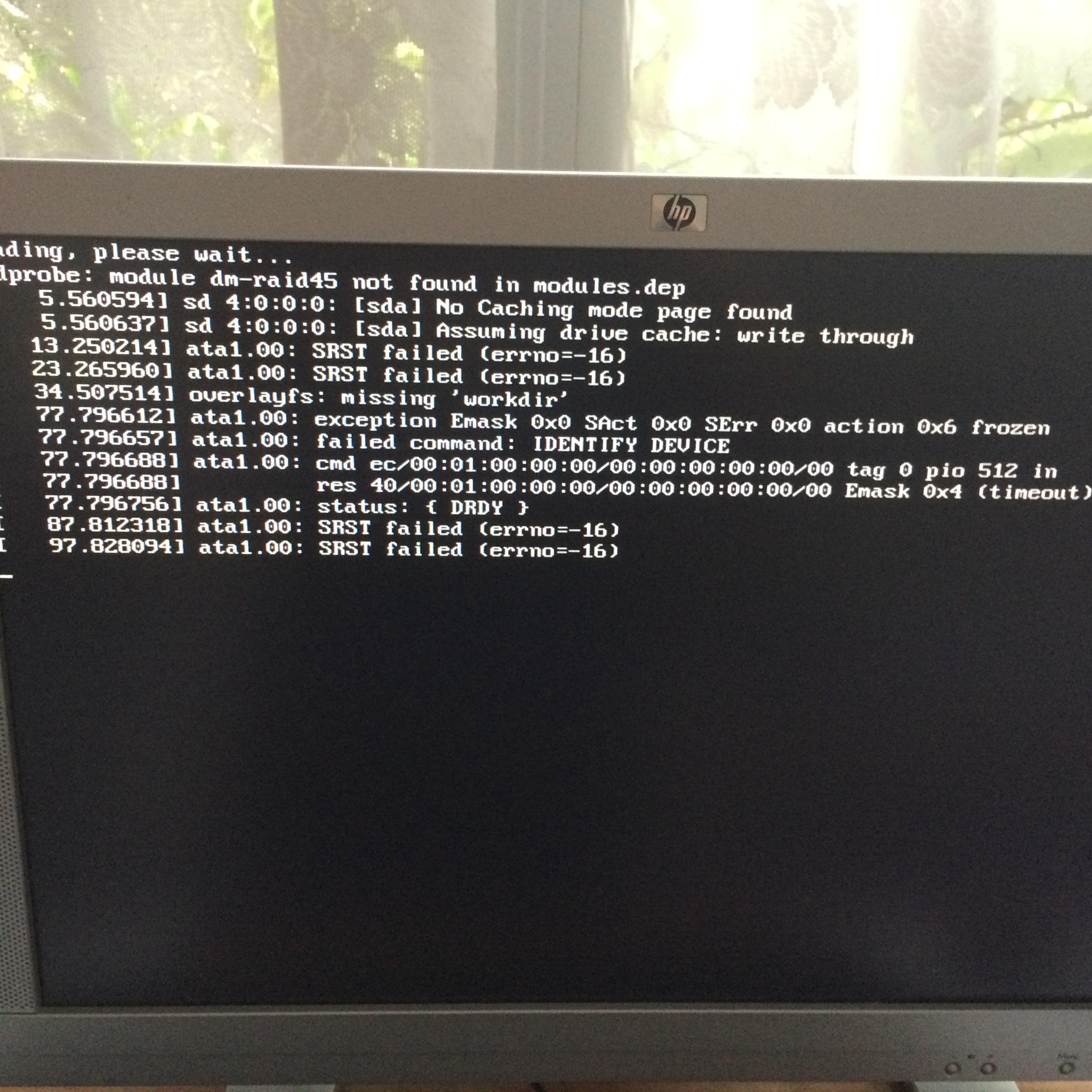

I changed PCB and swaped the ROM, now the disk can spin. Before it did not spin.
But when I boot clonezilla, I get SRST ERRNO=-16.
see attached picture.
ata1:00: failed command: Identify device
ata1:..: cmd ec/00:01:00:00:00/00:00:00:00:00/00 tag 0 pio 512 in
What can I do to fix that. I know the PCB is good, taken off from a good disk. did swap the rom, I noticed if I don't swap the ROM, it would not even spin.
 Post subject: Re: 7200.14 Story so far (HELP!) :) ST3000DM001
PostPosted: July 30th, 2015, 0:36
Posts: 17223
How does the drive identify itself to BIOS?
