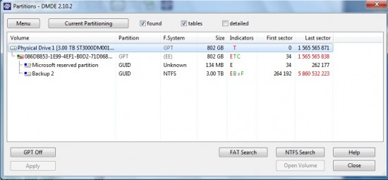

I run the ntfsfix (ntfs3g) and now I can see and open my partition again, the Ubuntu recognizes the 3 TB, the problem is that some folders and files are not visible, but the properties shows that I'm using 2.7 TB and available only 7.5 GB .
When I reboot and enter on Windows, appears the chkdsk, so what can I do now?
Run the chkdsk?
Try other tools to recovery my data?
On Windows the partition continues like RAW, but on Ubuntu this accessible.
I run the GetDataBack Simples and show only 746 GB, but show to me folders and files that Ubuntu don't show...
On Ubuntu I see some folders and files and not on GetDataBack, on GetDataBack I can see folders and files and not on Ubuntu.
I know the all the folders and files still on HD, but how to see the others 2 TB?

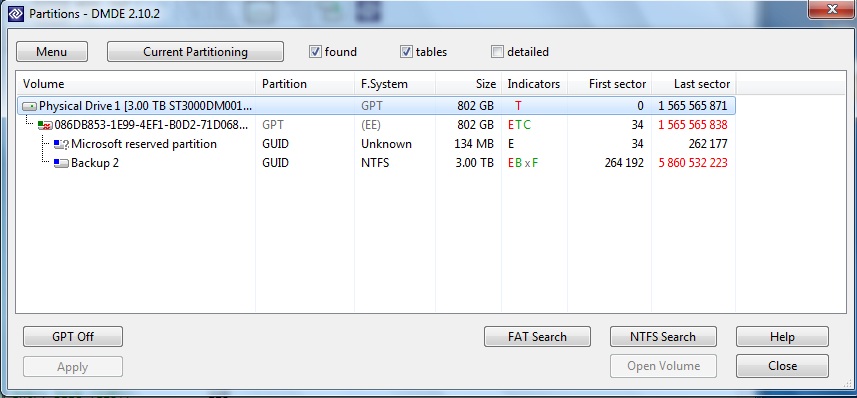

@petabyte85, I would not attempt to repair your file system, nor would I write to your drive. Doing so will only exacerbate the damage, or at least complicate it.
colanco's suggestion to install your drive in a USB enclosure should force Windows to use a different driver (USB mass storage controller). That said, be aware that some older enclosures have 32-bit LBA limits in their firmware. Also be aware that some enclosures are configured with 4KB sector sizes rather than 512 bytes.
The fact that R-Studio encounters an I/O error at the 745GiB point confirms that there is still a fundamental problem in your system. You must resolve this issue before you can hope to recover your data.
Here is a screenshot of sectors 0, 1 and 2 as displayed by DMDE (freeware disc editor):
http://s10.postimg.org/l2hgisl3t/4tb.jpg
You can see the correct sector range for a 4TB drive in the top left corner (0 - 7814037167). Can you show us a similar screenshot?

Here a screenshot od DMDE:
