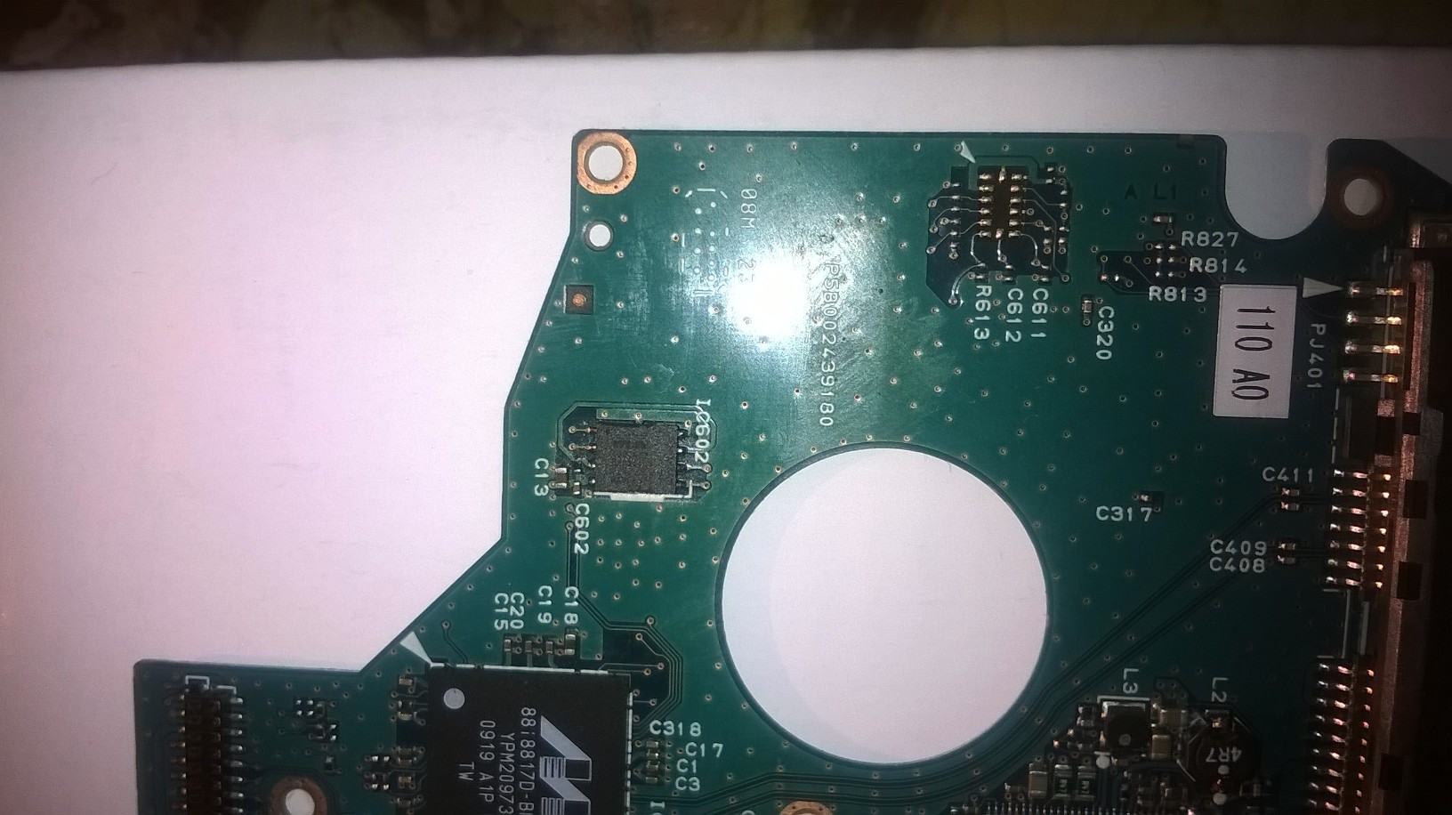

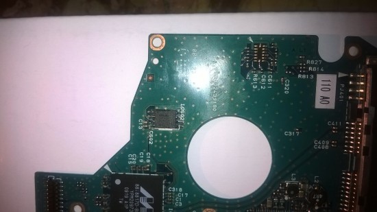

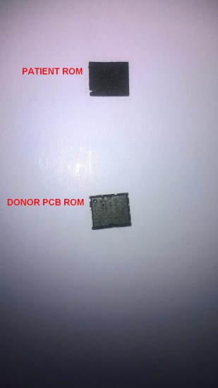

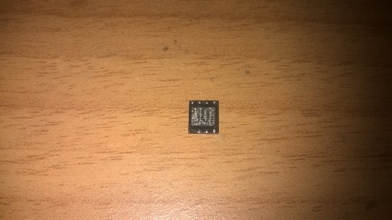

fzabkar wrote:Then he must have cooked the chip so badly that he blew the markings off. Wow.
It's strange that the key dimple also appears to be missing (unless it was just painted on).

Re: Toshiba MK2555GSX PCB HELP!
May 22nd, 2015, 7:04
There is no reason the picture quality should be so poor. Sorry but it is a pet peev of mine. It is very easy to get great detail in pictures. I just use my iPhone 4S, shine a desk lamp at the wall to stop glare, and position subject well. Crop picture so as to not waste peoples bandwidth and resize in case picture at 100% is overly large. Takes less than 10 min.

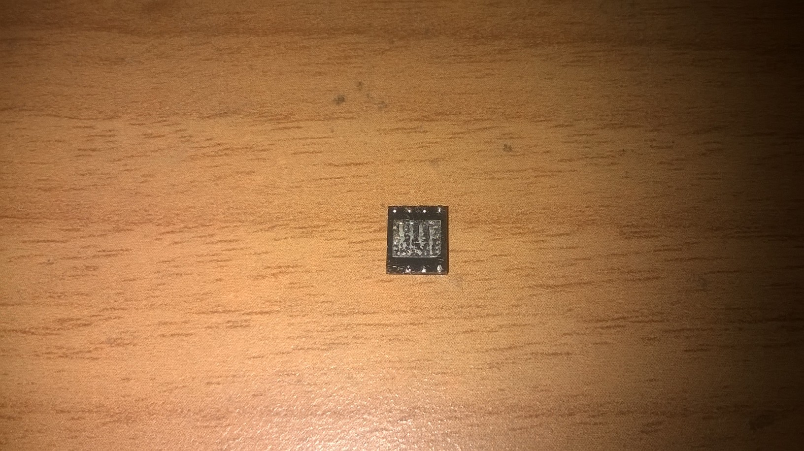

I would read rom of both PCBs via eprom programmer to find which is the native one (that tech could have mixed rom chips).
Reading rom via eprom would be a good way to find out if native rom is still good or if got damaged.

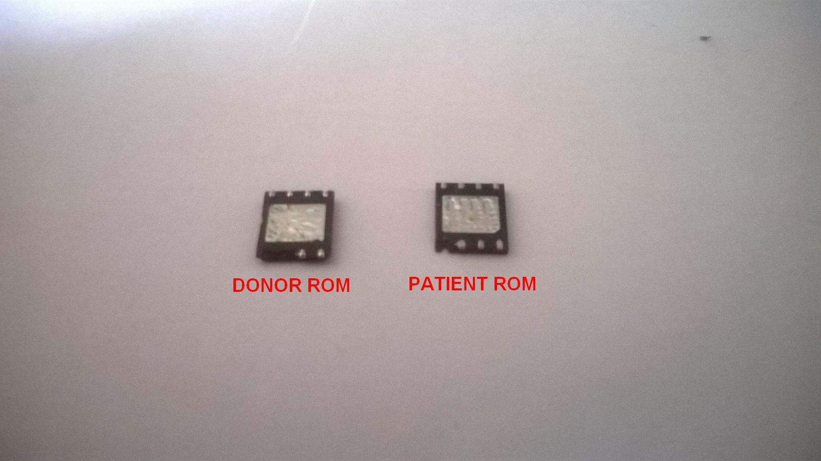

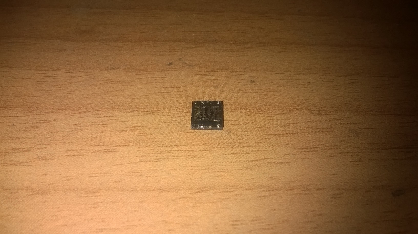

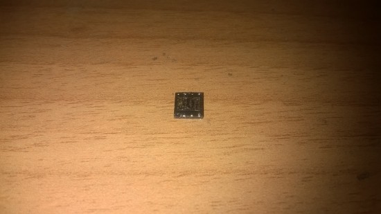

July 16th, 2015, 3:46
Hello guys,

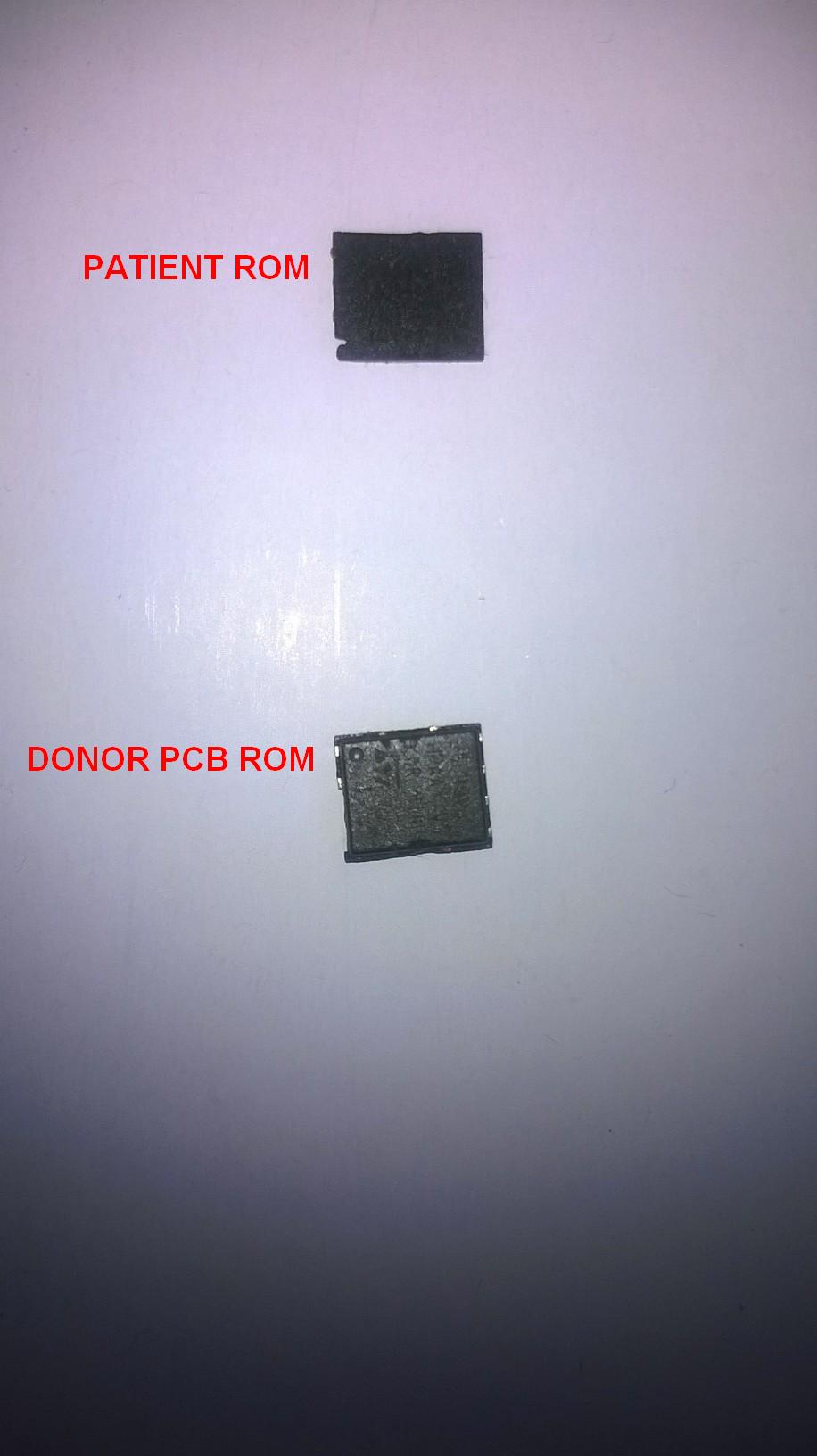

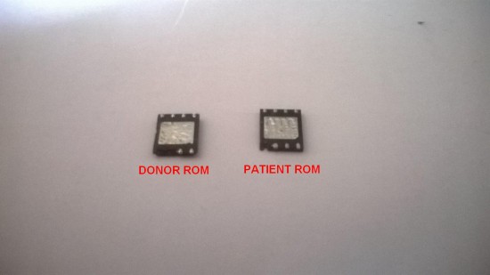

'seabroke' sent me his drive with patient and donor pcb.
Unfurtunally i have to say that this is a lost case :(
I found that patient ROM is damaged (GND pin is missing and also part of plastic package on bottom left).
Even donor rom i found damaged, 2 pins on bottom right are gone.
Second problem is that i've found patient ROM soldered upside down :(
I'm sorry but i have to say that this is a lost case (as many of you already wrote), not possible to recover data due to very bad technician job.
