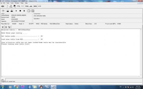

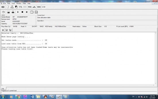

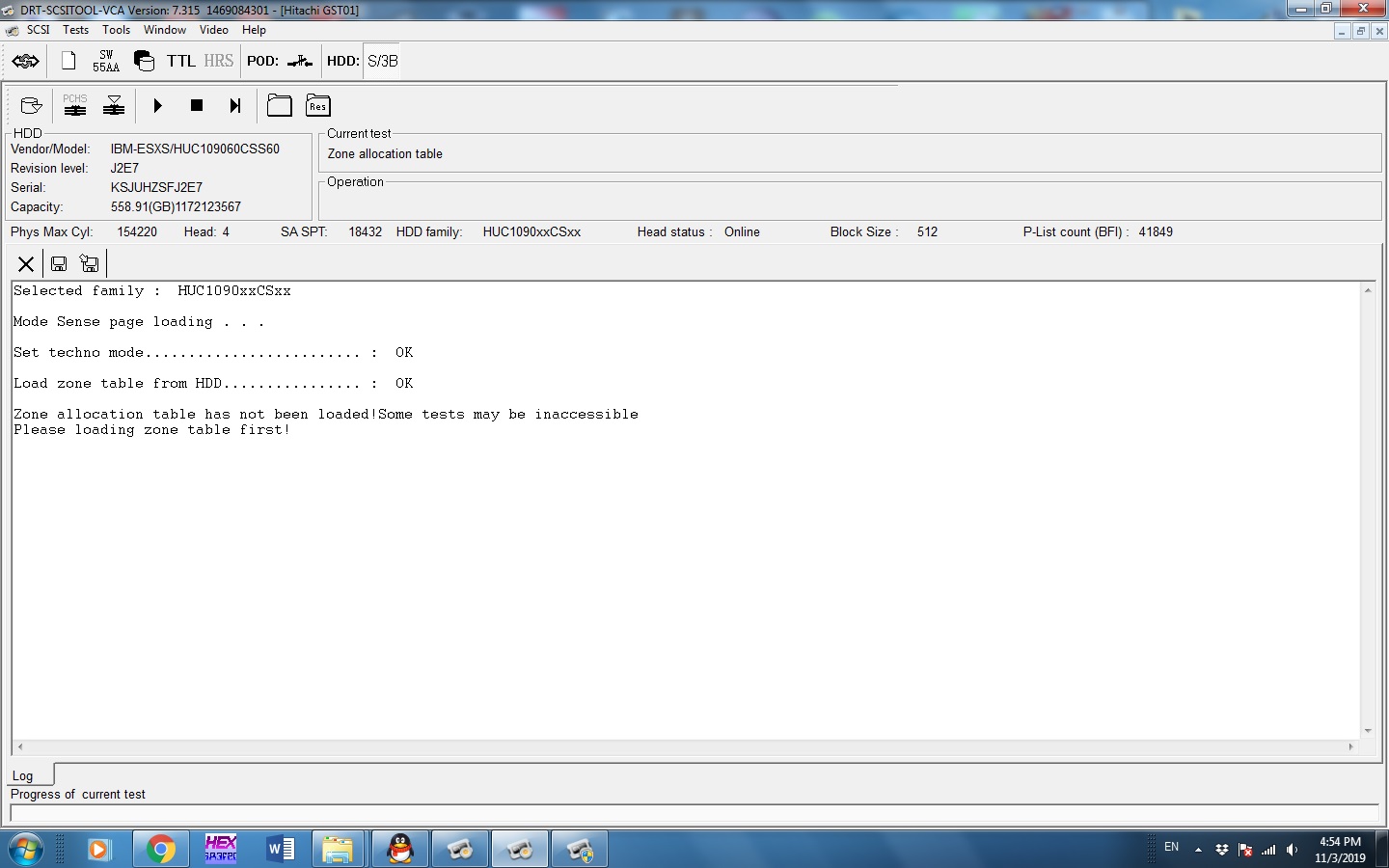

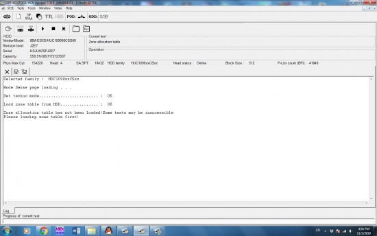

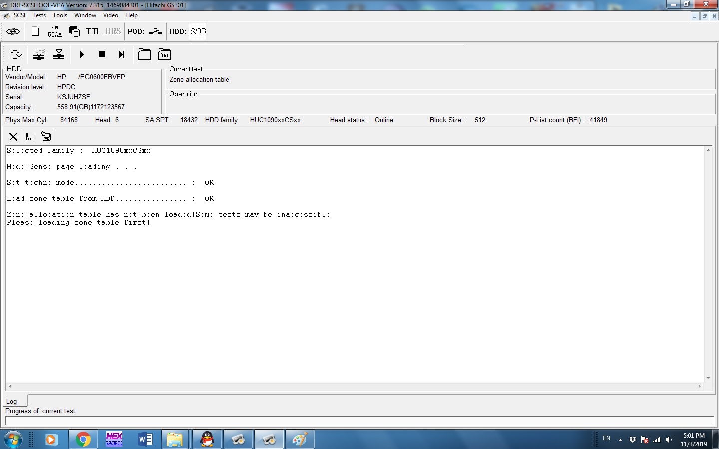

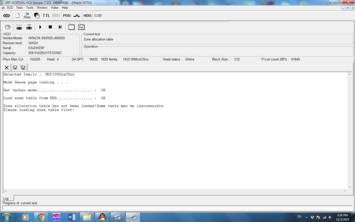

Yes You need custom software to do it, off the shelve utilities wont work.
Refer to the pictures attached.
Hitachi Storage - GHGH ---> IBM - JE2F
IBM - JE2F ---> HP - HPDC
