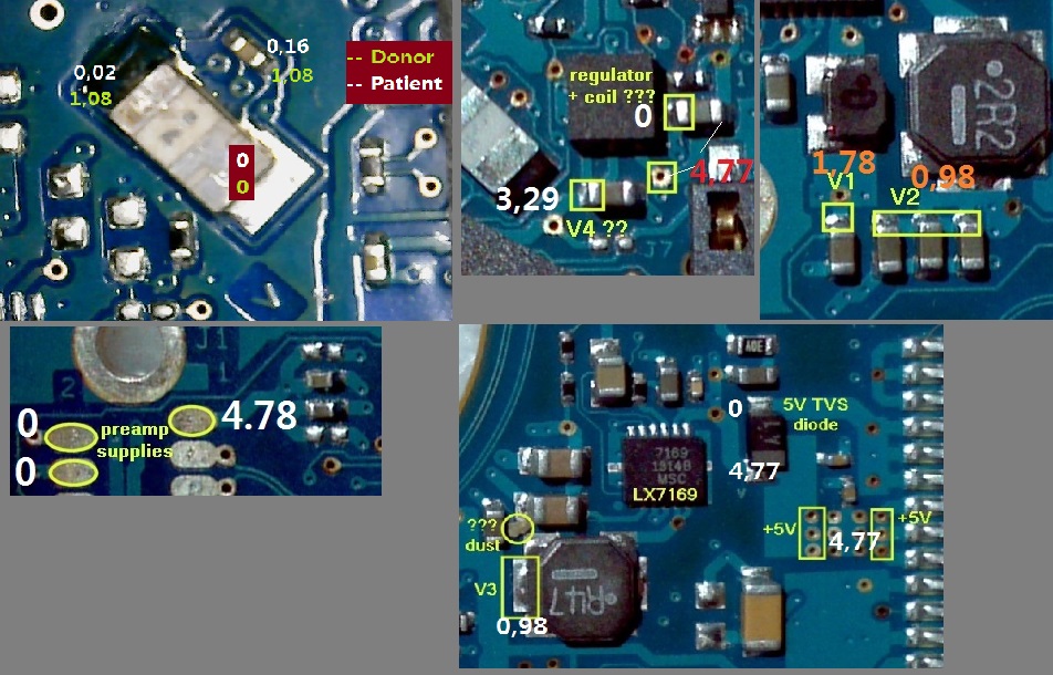

I have measured voltages.
Recognised something different than donor. Added pic

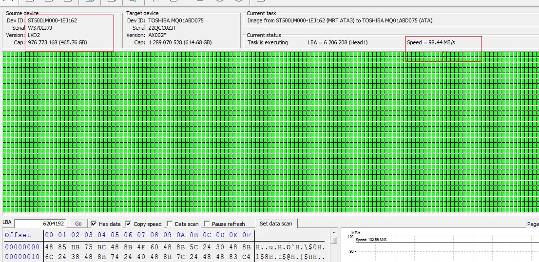

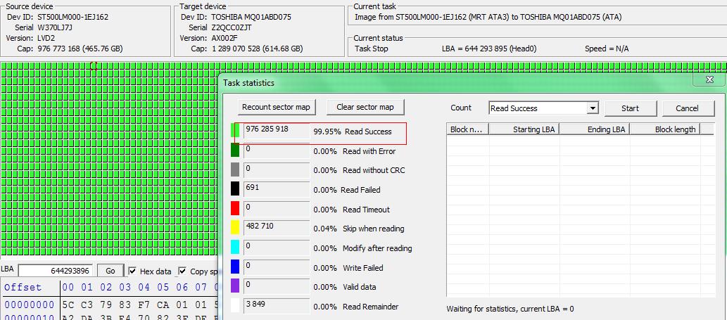

WOW.
I have tried so many things. Bricked live PCB at may last attemp. PCB gone endless busy.
After than I could adapt donor PCB to patient. Case solved. Thanks for assits.

So you're not going to tell us the solution?
Patched ROM (Kahuna PCW Patch 1 ) with MRT.
After then followed 0>I prossedure
