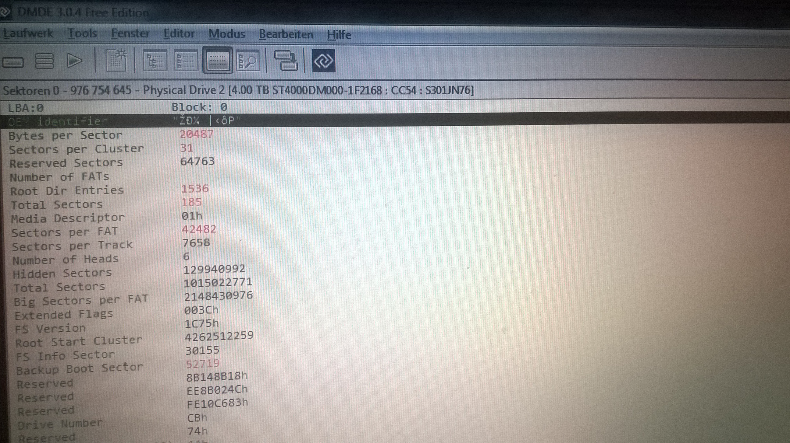

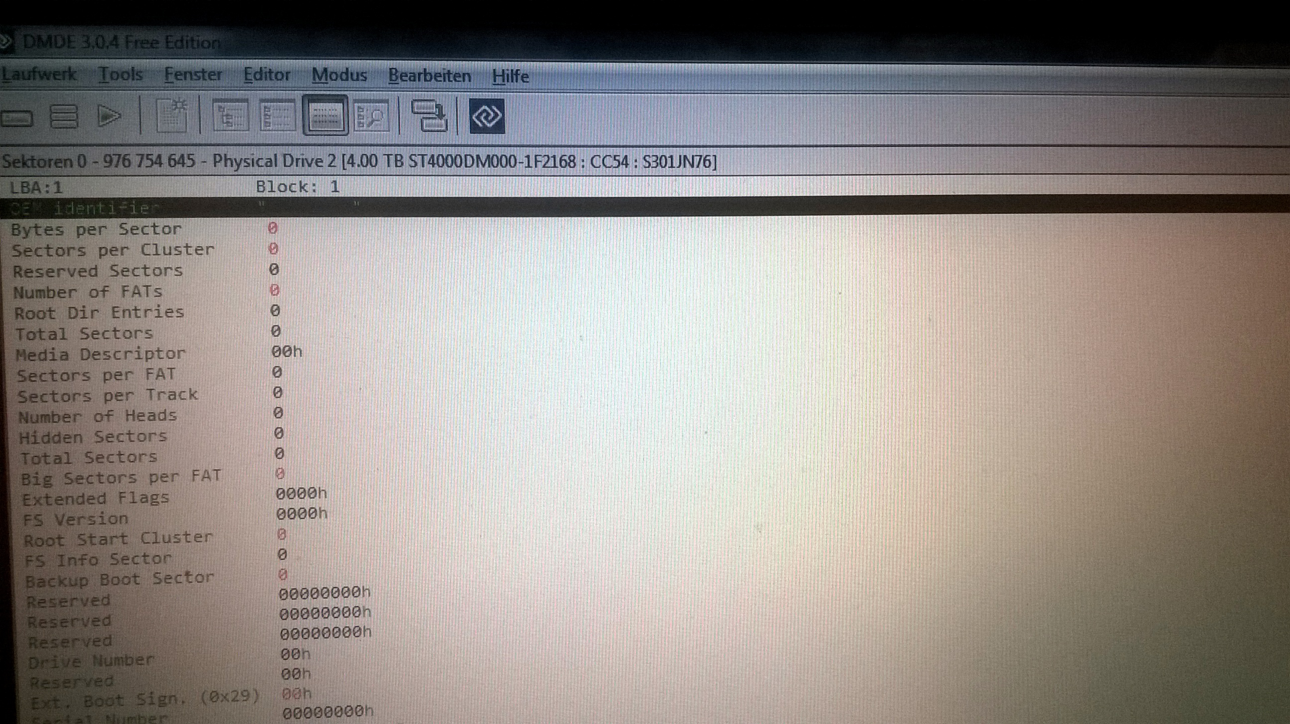

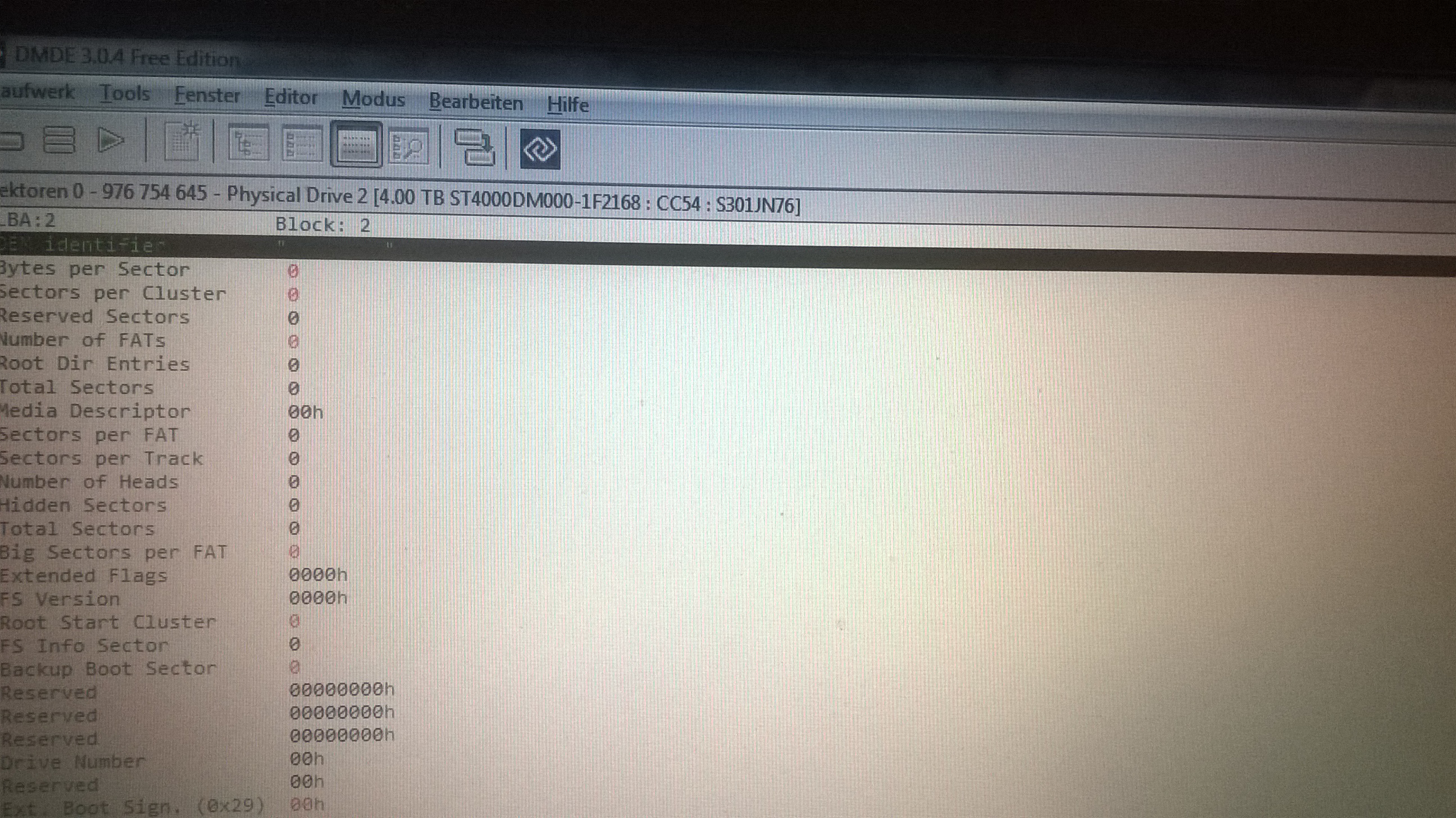

I have attached images of lb 0, 1 and 2 as shown in dmde.
the drive with the clone has not been formatted and before following up on your suggestions - there is a chance that the original drive, the one containing the data I am trying to recover now, that it could have been formatted in fat32. There was an issue with mac-connectivity, and this might be one of the drives in fat32. I usually have them formatted in NTFS, and I'm still not 100% sure about this one.
- As the security protocols of fat32 are not as advanced and hence the partitions not that resilient as with e.g. NTFS - I guess my chances to recover the data together with its structure will be lesser...?
- would the posted partition info of the clone be more "fitting" to an original fat 32 file format?
thanks again!

You need to determine whether the cloning process proceeded as in case A or case B. To this end you would need to compare the original drive against the clone. If you can upload DMDE's partitions window for the 1TB drive, that would be of great help.
Select Mode -> Hexadecimal/Text and scroll through the beginning of each drive. LBA 63 or 2048 on your 1TB drive would be the typical location of your boot sector.
