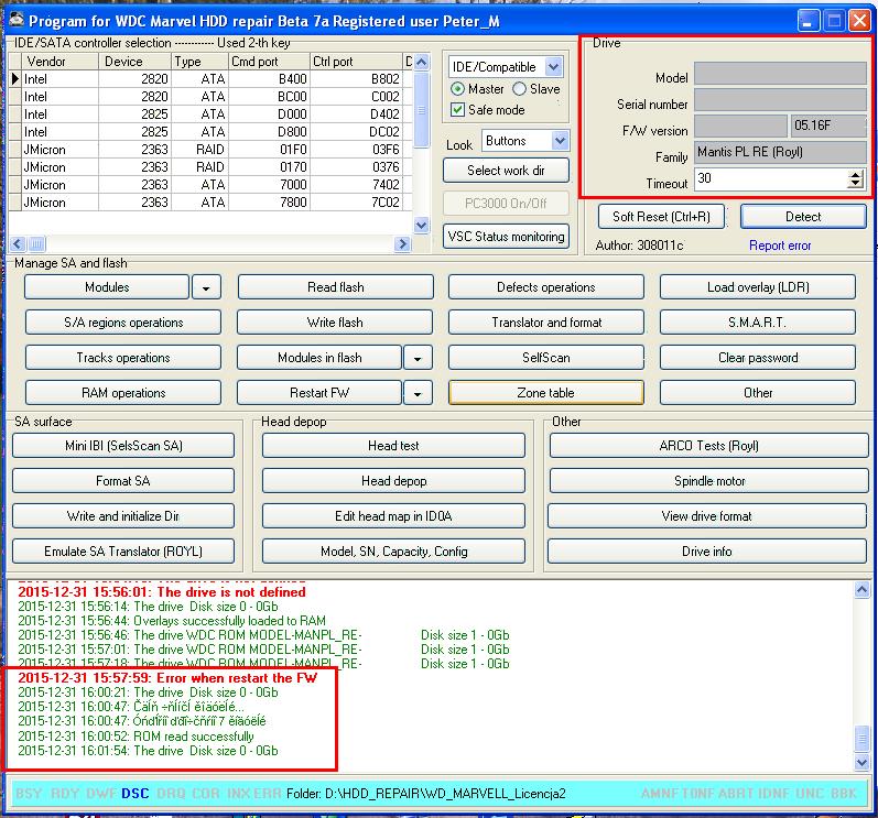

Same PCB is very slowly,
as presented for same PCB:
And, attach ROM modules, and ROM CODE.
ROM code.rar
(189.56 KiB) Downloaded 829 times

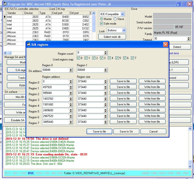

Now slide the regions and check sa
Re: CA_FLUSH_ALL_GOT_CANCELED - what's wrong?
December 31st, 2015, 11:27
Moltke wrote:ok.
But, screw the PCB to drive?
December 31st, 2015, 11:29
first slide, then screw the controller
December 31st, 2015, 11:32
SA REGIONS
December 31st, 2015, 11:36
reg0: 0 +1
reg1: 497920 +1
December 31st, 2015, 11:46
OK, I will try.
Btw. Screw PCB and Check SA?
December 31st, 2015, 12:06
No problem Frend, SA checked, and SA Is Empty, Can't Read modules, I Created new theard in WD MARVEL forum, and we are waiting for a reply. :)
December 31st, 2015, 20:21
Well, I don't know. I suspect that detects a drive ok but the UA will blocked. What do you mean write bruch firmware?
BTW. I have some doubts as to the PCB reaction to commands is beyond time limits. Understand me?
Thanks for all replies friends :)
December 31st, 2015, 20:39
I mean sytuaution when backup rom module's and rom. Initialization mcu Exceeded timeout. Reaction same PCB is very slowly.

If so, and assuming that WDMarvel does not have a bug, ISTM that either the ROM code or a particular SA module is locking you out of the SA (by disabling VSCs?). IIUC, Moltke replaced the ROM code with a version which he believed was not locked, but you were still unable to access the SA, so this would point to an SA module as the culprit. The next line of attack was to hide the SA from the ROM by displacing SA regions 0 and 1 by +1 sector in module 0x20B. Would it not have been advisable to also adjust the location of module 01 by -1 sector? In this way the ROM would still find module 1 but would not be able to find the others.
January 1st, 2016, 9:21
fzabkar wrote:Would it not have been advisable to also adjust the location of module 01 by -1 sector? In this way the ROM would still find module 1 but would not be able to find the others.
shifting regions we have access to the service area under the loader.
we need to analyze all modules, not just the 01h. how to do it in wdmarvel I do not know, and better to consult the author
since the ROM module are read without an error (experiment with only one controller) , the block comes from SA
