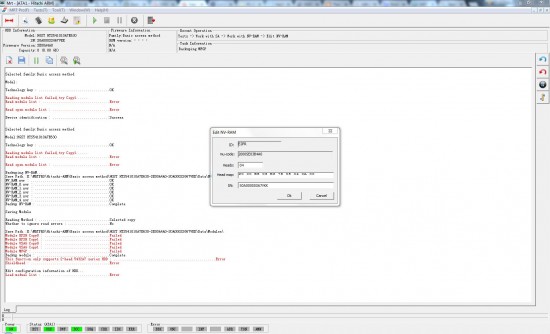

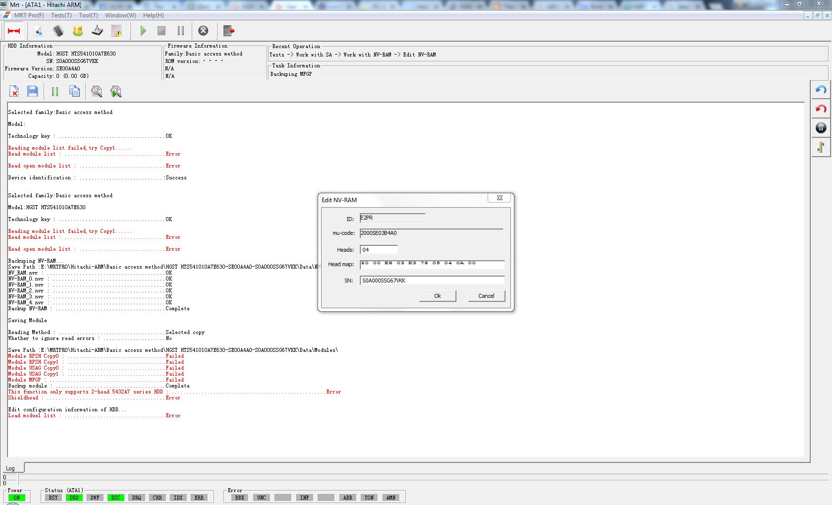

 Post subject: Re: HTS541010A7E630 (NEWEST MODEL)
PostPosted: October 25th, 2016, 10:03
Posts: 331
Hello!
I have a patient with a same problem.
Drive spins up, no head moving, but it's ready right after finishing speed up process.
Has anyone a solution for this?
Thanks!
