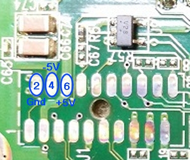

Here are what I believe to be the supply pins for the preamp:
Please confirm that there is continuity between each of the 3 pads and its respective test point on the PCB (Vneg = -5V). I would use a good PCB for these measurements. It would also be advisable to repeat the previous resistance measurements on the good PCB.
Now locate the corresponding pins at the HDA connector on the body of the HDD. Measure the resistance between pin 2 and each of pin 4 and 6. If the resistance is too low, then the preamp will be shorted.

As far as continuity, I only found it between pad 6 and Vneg on any of the boards. None of the boards had connectivity between pads 2 and 4 and Vneg. I was a little confused by your instructions, but I'm assuming Vneg is the solitary pin on the right side of the component near the drive connector as shown in your picture on the previous page.
Resistance between pin 2 & 4 and pin 2 & 6 on both drives was larger than 200 Ohms.

The preamps are probably OK. If they were damaged, then the drives would either not spin up, or spin up, click a bit, and then spin down again. At least that's my understanding. I was hoping to measure the preamp resistances and compare the two dead drives. If the results were close, then that would have given us some added confidence.
