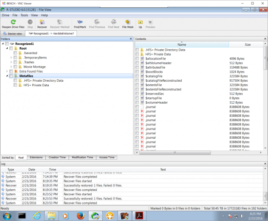

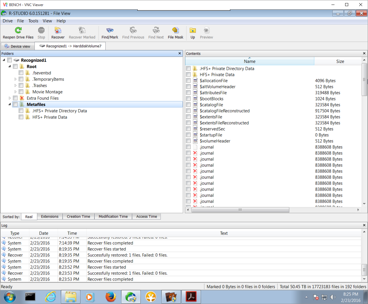

I did a scan on the drive for recoverable files. It looks like it found some .trash directories and one program folder.
The rest is extra files with generated names.
The interesting part is it looks like it found a lot of the meta files for the drive. Is there a way to construct the partition from the meta information?

Im doing a file recovery on this since I cant get any further help on recovering the file structure. Can anyone tell me why the file recovery scan shows 50.00TB on a 4TB drive? Im not going to be able to do a full recovery on the disk with that much space to recover from. Any suggestions on how to handle this?

Use the filter option to rid of obvious files that don't make sense size wise.
Yeah the program is is crashing on me when I mess with the filter settings on this particular drive, I do not know why maybe too many files or something. So I am now re sorting to recover one file type at a time and working though the files that way.
 Post subject: Re: Recovering a lost HFS+ partition fr a two drive raid 0 a
PostPosted: March 9th, 2016, 17:39
Likely crashing because files' sizes don't make sense and it is eating up all RAM trying to process them.
Still, to me, something seems wrong with the set up or some other damage took place besides that of the enclosure.
