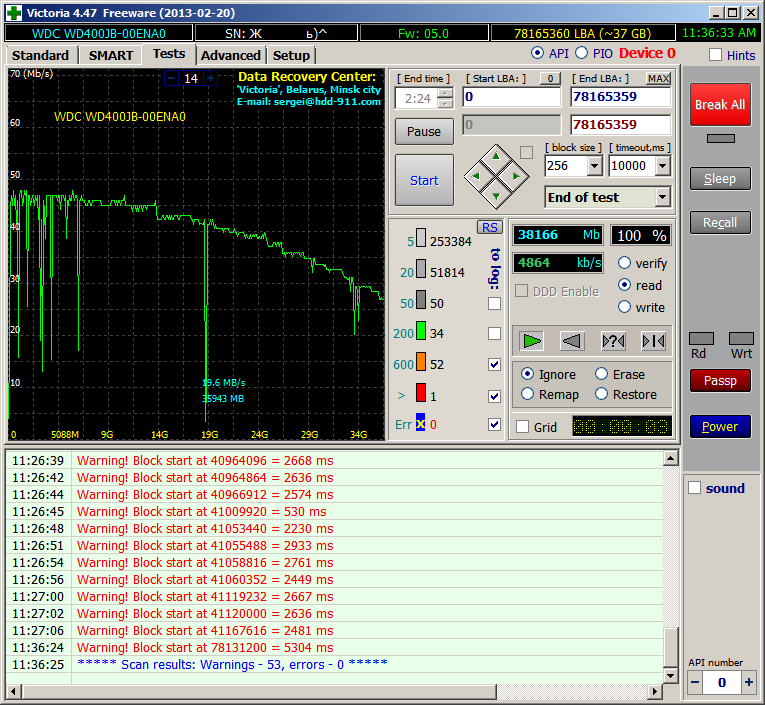

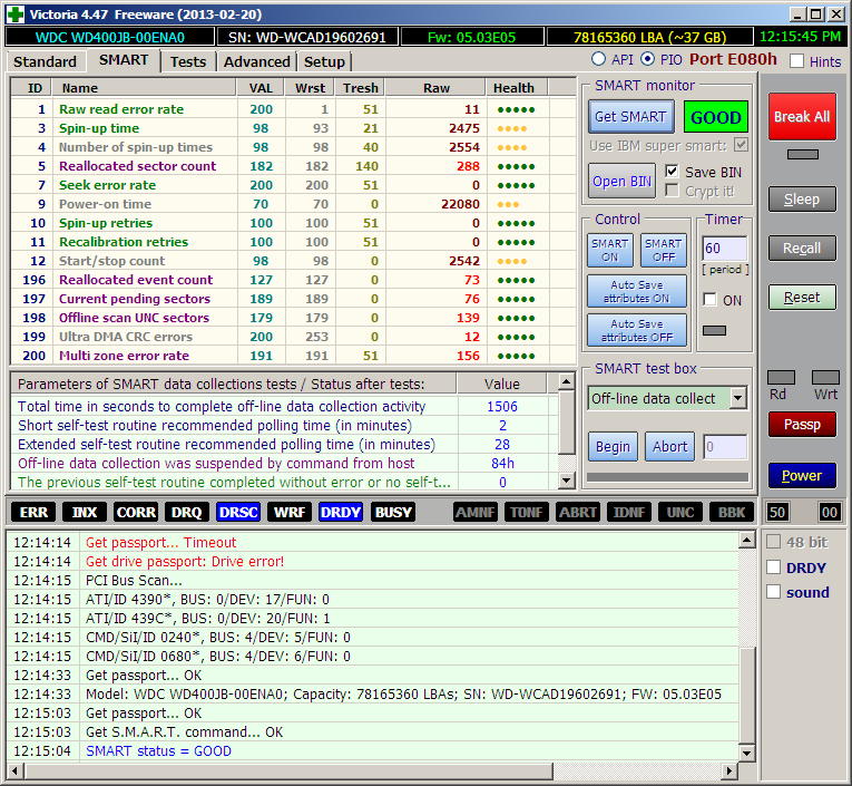

Here's a screenshot of Victoria 4.47
It looks the same as your pic at first sight.
There are also 182 reallocated sectors and 189 pending sectors.
 Post subject: Re: WD400JB cannot read sectors from 30GB to 35GB
PostPosted: May 31st, 2016, 7:14
Joined: March 30th, 2016, 12:29
Posts: 127
Location: Germany
Spildit wrote:
What could have happened is that your cloning software is somehow flagging the sectors as good or somehow those sectors were added to the G-List by your software.
I cannot imagine that. My cloning tool has no implementation for such things..... at least as far as I know and understand the source-code.

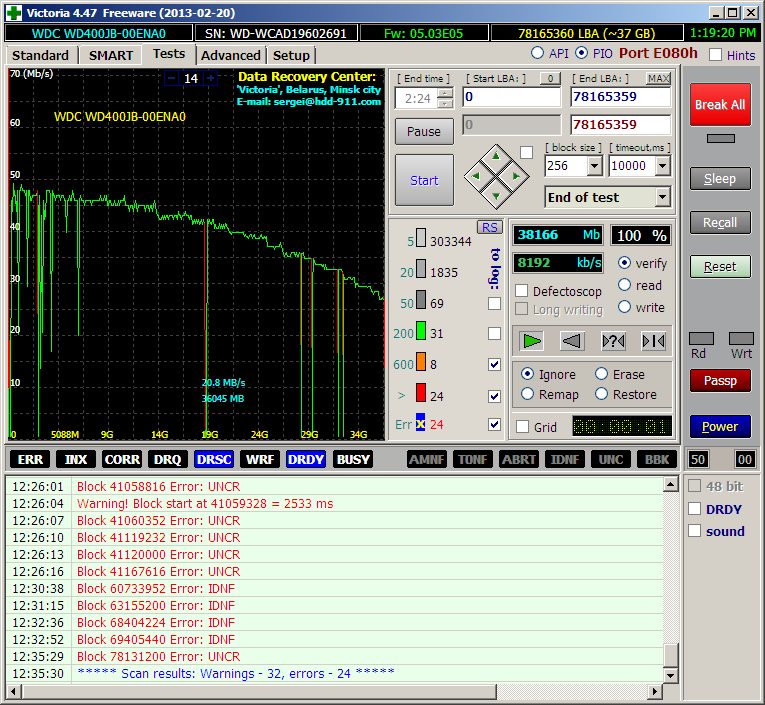

Spildit wrote:
Do run MHDD/Victoria on the drive and scan it. It should find bad sectors at the start and across the drive.
This is the scan result with API mode
Interestingly it differs from the scan in PIO mode

I'm sure that the drive have those 180 bad sectors. I didn't remap them to the G-List. Maybe your software managed to do so. Check S.M.A.R.T. and you should see the number of relocated sectors.
Smart Data (see screenshot in last post) seems to be similar to your screenshot.
