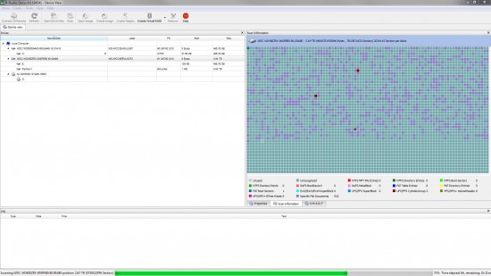

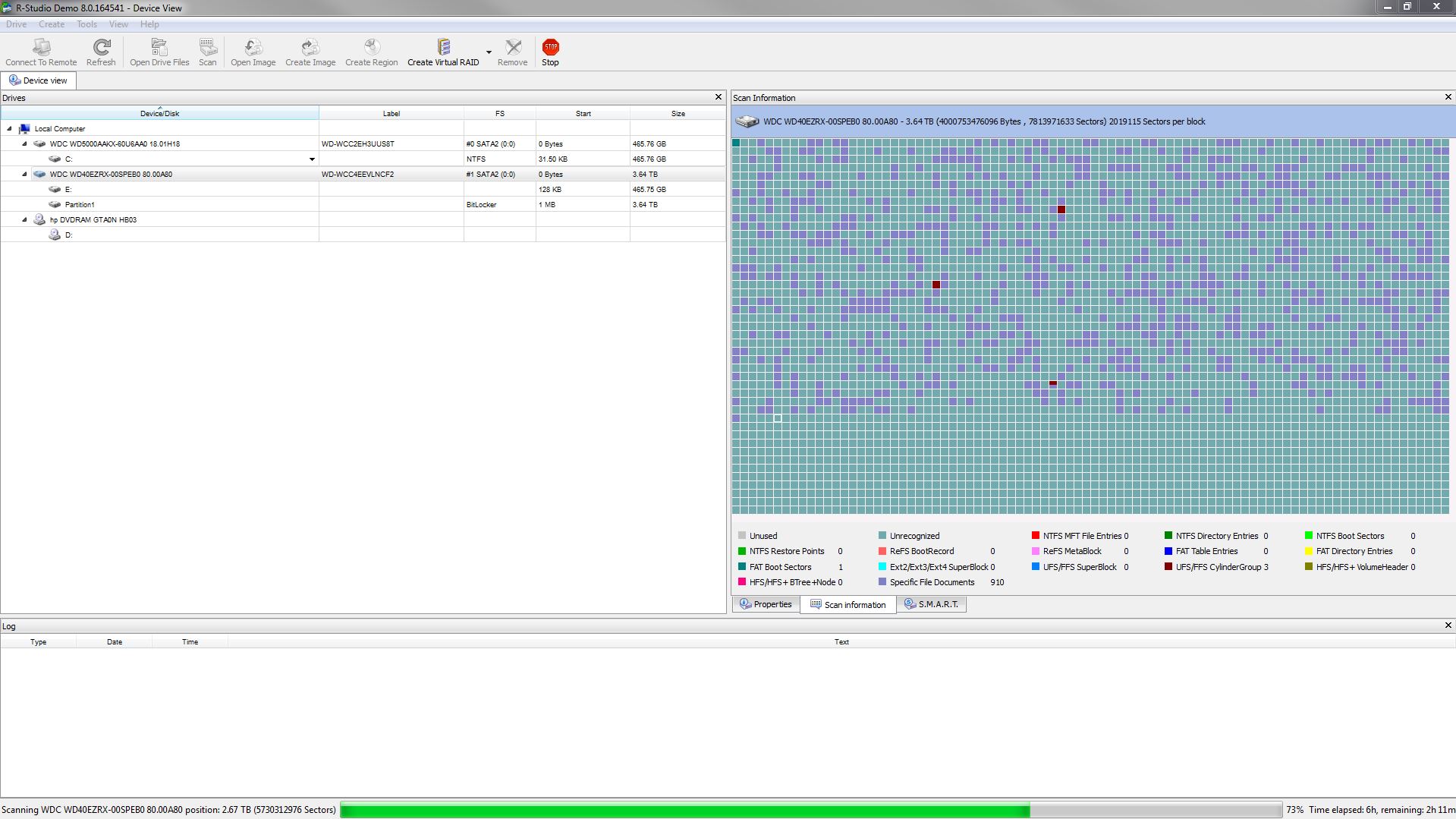

I have attached a SS of R-Studio, it is nearly done scanning the drive. It's found FAT Boot, Specific File Documents, n and a few UFS/FFS Cyclinder groups - does that sound reasonable?
FWIW, last night I tried to scan using DMDE, Recuva, and GetDataBack with no luck (No File Structure Found). R-Studio seems to at least recognize the 4K and that the drive has BitLocker on it, which I make as being a positive re: hardware and a negative re: software (where would I enter the password? I know it even!).

So, as an update, this didn't work. The finished product of the scan looked more or less like the above, but the file structure couldn't be read.
Disk Management says that the drive is "Healthy," but also "RAW." In case this is a bitlocker thing, I'm currently running repair-bde to see if I can't unlock it.
