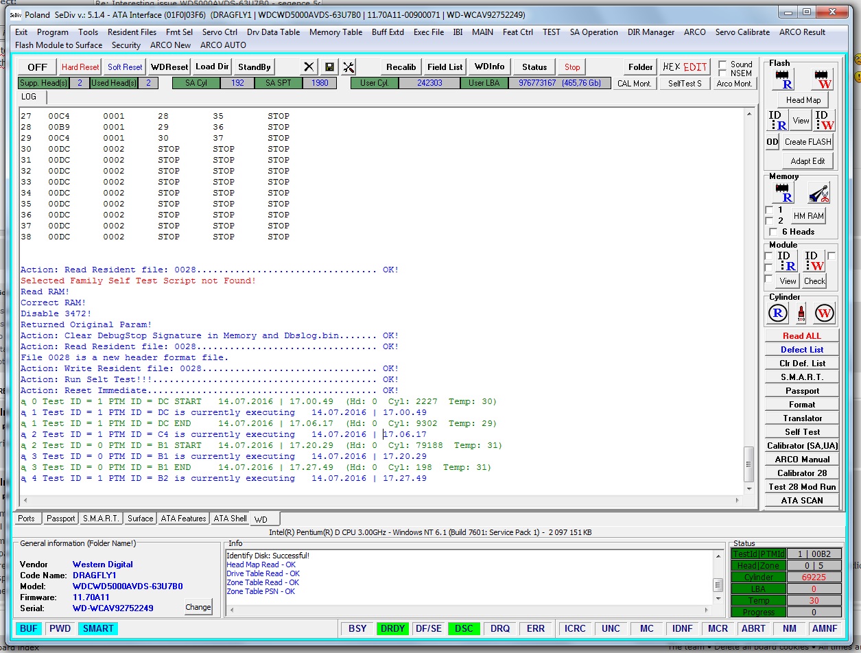

everything is show in screens
I was talking about error code in registers, not about pictures.
"WDC Marvell HDD repair....Registered user Peter_M" - hmmm, I think I guess about this Peter_M :)
Write back all original modules exept 02, 03, 31, 40. If drive clicks - so heads are not OK (can't pass start check). If not clicks - write these modules one by one untill drive start clicking. By doing this you can localize a problem.

Hi for all, I'm banned I don't no how. But Problem solved, I found problem why Click my WD AVDS. Problem identical
like my WD BLack WD2002FAEX, SHIT WDR........ Copy Made in WDR soft are bad :arrow: Mod 40 is this problem.
I prepared FW for ARCO procedure, and restart HDD, and success, Drive no Click, and Show Model XYZ ROM MODEL, SN correct, and FW version, so I Write mod from 01 do mod 39,
And restart hdd, and Drive again no click and correct initialize, Write mod 40, 41 reset drive and I hear Click click click click click pause click click click click click pause click click click click click pause click click click click click and spin down.
Further part are not write, because, does not make sense. It seems that you need to perform the procedure ARCO, do you understand me?

Case solved, My drive have bad servo or platter.

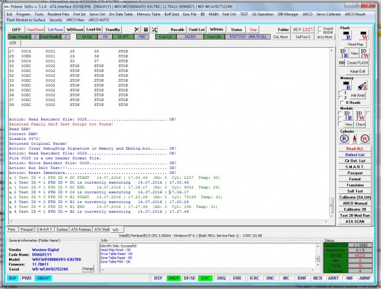

Lool, very lool, drive perfect complete ARCO, and Now running Self Test,
So, this case is veeeeeery interesting why Clicking, because previous drive clicking seqence, and now Running perfect.... :lol:
My disk still alive, Very interesting issue, Self test completed, and drive work perfect, not clicking, and not strange noises(borrowed PCB).
So finally :arrow: Previous Backup is corrupted, or lot of badsectors, can not propertly loaded translator, and finally clicking.
Btw: WD marvel is veeeery bug, and veeeeery poor, can not deal in many drives. :(
