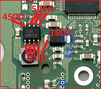

Thank you mad4hdd for your recommendations, let me summarize the steps already doing and why:
1) I use this hard drive to back up all my pictures, videos and other personal files, connected to an external dock on my laptop one day Win7 have reported me record as being in RAW format, I tried Test-Disk without success or increasing the problem.
2) The disc rotates normally but is not recognized by Win7, and on my desktop it's seen in the BIOS but gives errors in the SMART.
3) I order the same disc with the same PCB, I swap PCBs, same problem, I put the circuits as the original place and disconnecting the SATA cable (PC running) the PMos burn!
4) I de soldered the PMos and checked if the preamp look Ko, it seems not.
see photos on bottom.
5) I Hesitate to swap again PCBs, how to be sure that the preamp is Ok?
Thank you ! For your support.

This is where the preamp measurement should be taken:

Hi & thanks fzabkar for the information, I'll check the -5V after PFet replacement and let you know.

I would first measure the resistance between that point and ground. That will tell you whether the preamp is shorted.

Hi all, I'm back. To answer the question from fzabkar I compare to GND with
ohmmeter on the point :
1: Hot on the point => Measure = 0.676 on 2Kohm range on HDD OK.
2: Same -----------=> Measure = 0.629 ---------------------- KO.
3: Hot to GND => Measure = 1.039 on OK.
4: Hot to GND => Measure = 1.036 on KO.
Then I put the drive on docking station without USB connection, only power supply, on the Good HDD I measure -5.20V and 0V on failing one.
Note: The PMos is not in place on failing, I'm waiting to receive it ....
It looks the preamp is not shorted, what do you think ? :)
 Post subject: Re: Samsung HD203WI Not reconized.
PostPosted: June 17th, 2016, 17:36
Posts: 17343
ISTM that the preamp is probably OK.
