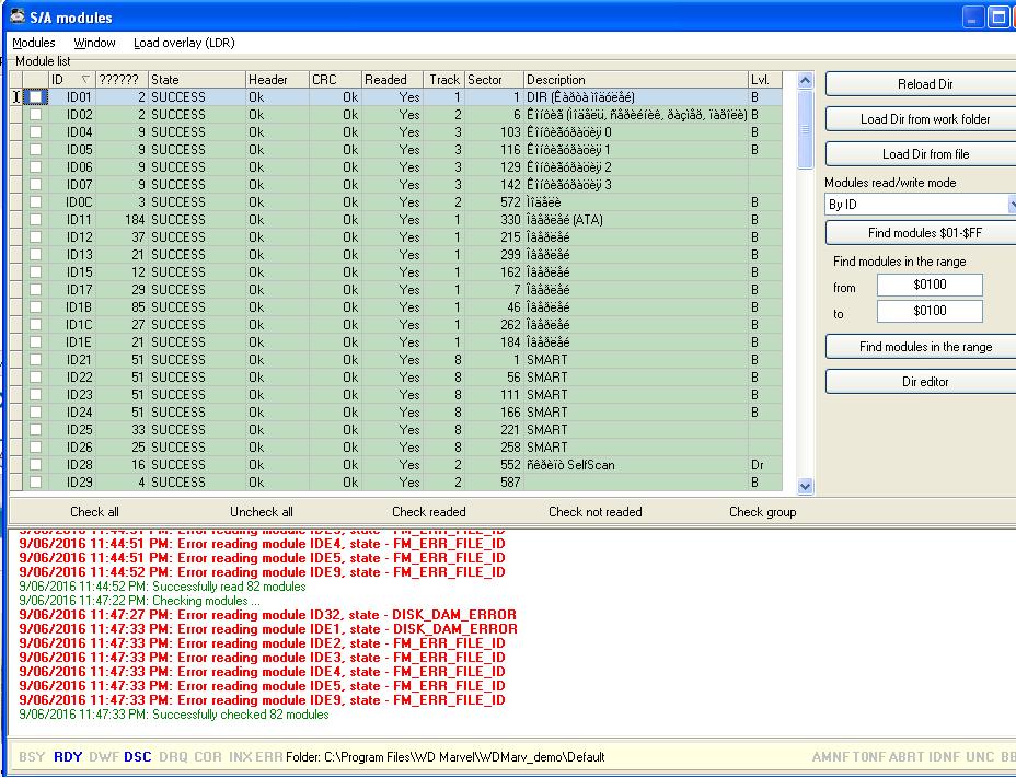

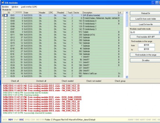

Ok I've got MD Marvel demo going. It says the Family is Mammoth. Does this change anything?
I've attached a screen shot of the output from reading the modules, they appear to have been backed up.
Should I proceed with using WDR DEMO and the quick format with P-List command to regenerate the translator?

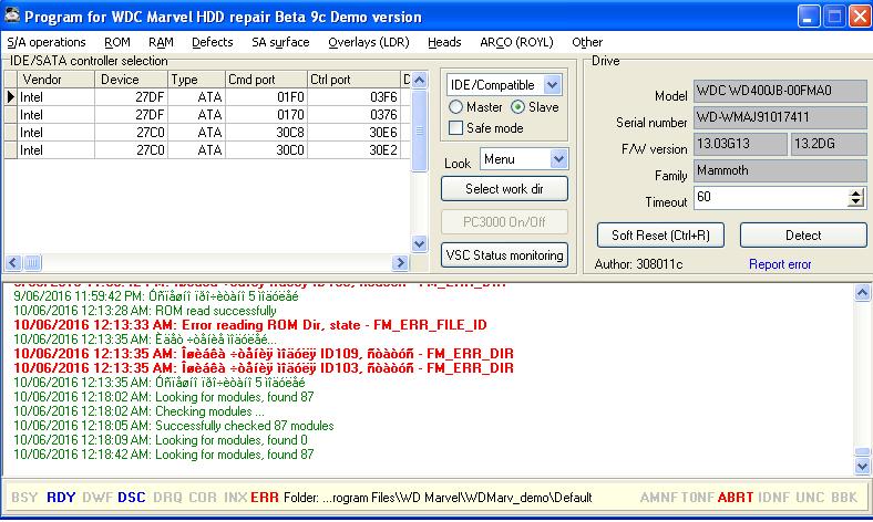

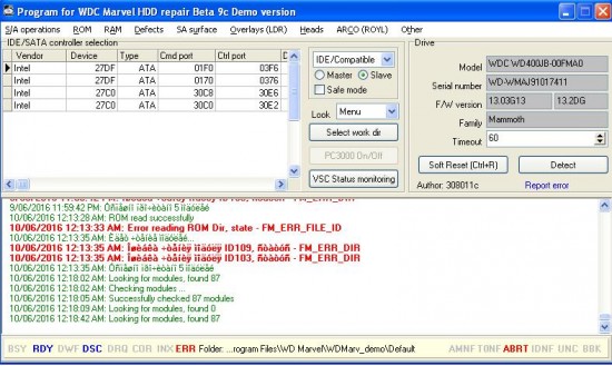

This is just another screenshot showing the drive family.

 Post subject: Re: Drive recognised but every sector is bad
PostPosted: June 9th, 2016, 16:14
Posts: 17343
Please don't write anything to your drive.
NazYura's tool found MOD 20 but this doesn't appear in the WDMarvel screenshot.
Edit: The reason is that MOD 20 is not in the module directory, so that is OK.
ID   TRAK        SECTOR  SIZE
0x01 0x01 0x0000 0x0001 0x0002
0x02 0x02 0x0000 0x0006 0x0002
0x1E 0x01 0x0000 0x00B8 0x0015
0x21 0x08 0x0000 0x0001 0x0033
Also, NazYura couldn't read MOD 2D, but this is absent from WDMarvel's error report. Was this module read successfully by WDMarvel?
Modules E1 - E9 are not required for normal operation (they are manufacturing logs) so they can be ignored.
Your second WDMarvel screenshot is complaining about a ROM Dir error (MOD 0B) and errors in SA MODs 109 and 103. These modules only exist in Marvell ROYL architecture. Your drive's firmware architecture is pre-ROYL, so the drive appears to have been incorrectly identified by WDMarvel.
Try to read MOD 32. It consists of 8 sectors. Even if you can only read the first sector of either copy, this will be enough.

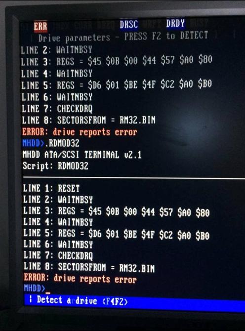

When I try to make it read Mod 32 I get this error
Error reading module ID32, state - DISK_DAM_ERROR
Is there any other way to try to read it?
Also sorry for the rookie question, what program do I use to open and view module files? WD Marvel outputs them as .MOD files, in the resources you linked me to they are .RPM files. I'm assuming the extension doesn't actually matter, but I'm not sure how to correctly open/view either of them. Thanks
PostPosted: June 10th, 2016, 3:36
Posts: 17343
The extension doesn't matter. Just view them in a hex editor. I use HxD (freeware).
https://mh-nexus.de/en/hxd/
As for module 32, you might get lucky if you keep trying. The other modules appear to have intermittent problems. For example, NazYura had trouble reading the En modules, but the tool was able to read the tracks on which they are located.
Alternatively, download MHDD ver 4.5 and copy the "rdmod32" file to the SCRIPTS subdirectory and the rm32.bin file to the MHDD directory.
http://hddguru.com/software/2005.10.02-MHDD/
Then type ...
    .rdmod32
... to execute the script.
This should read module 32 one sector at a time. Each sector should be written to a separate file -- 321.bin, 322.bin, 323.bin, ... 327.bin.

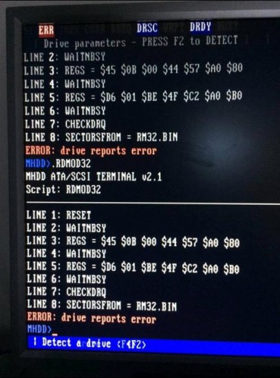

I tried many times in WDMarvel but kept getting the DISK_DAM_ERROR or DISK_ECU_UNSAFE_ERROR and wouldn't read.
So I tried in MHDD with the scripts you provided, but it gave an error too, see the screenshot below.
Does regenerating Mod 32 based on the resources for this exact drive, but without the first sector from the actual module, still jeopardize the data?

Let me experiment with my BB drive, then I'll get back to you.
PostPosted: June 14th, 2016, 19:34
Posts: 17343
The rdmod32 script is OK with my WD2500BB drive (see attachment).
To answer your question, if we rewrite module 32 with a copy from another resource, then we need to be certain that it is compatible with the other firmware modules. I wouldn't want to risk such an approach until we have exhausted all other options.
My next approach would be to try reading the track, or partial track, on which this module resides. If you can give me some time to experiment with my drive, I'll try to come up with a suitable script.

The following script works on my BB drive. There are four BIN files (rd32h?s?.bin) which need to be copied to the MHDD directory. The script file (RD32SEC2) needs to be copied to the SCRIPTS directory.
And then I just type .RE32SEC2 to execute the script? Ok I'll give that a shot, many thanks.
