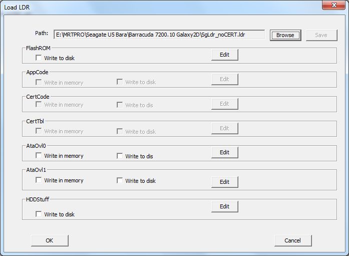

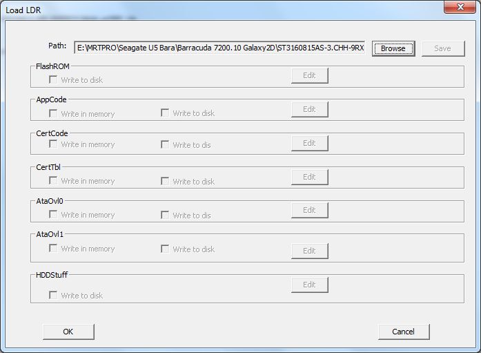

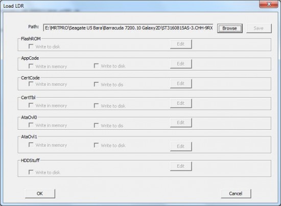

Attached is my attempt at removing the 3 CERT components.
Thanks fzabkar, but teher is something wrong with this loader, because i can't select anything in it.

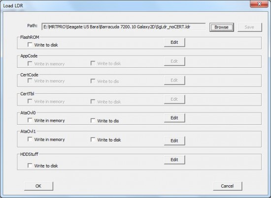

I see the problem.
The section I have identified as "header for ATAOverlay_0.bin" in fact consists of the first 0x200 bytes of CertTbl.bin plus the actual 0x15 byte header for ATAOverlay_0.bin. In other words, the CertTbl.bin file has been patched into the loader in two parts in reverse order.
loader address        component module            size
0x8503D - 0x87E3C     CertTbl (0x200 - 0x2FFF)    0x2E00
0x87E3D - 0x8803C     CertTbl (0x0 - 0x1FF)       0x200
0x8803D - 0x88051     ATAOverlay_0 header         0x15
This is the actual header for ATAOverlay_0:
00088030                                         14 10 EC
00088040  00 00 32 39 01 00 00 00 00 00 00 00 00 00 76 00
00088050  00 00
This the corrected structure:
0x0 - 0x2             "Mrt" signature             0x3
0x3 - 0x27             CertCode header            0x25
0x28 - 0x85027        CertCode (Block1 & Block2)  0x85000
0x85028 - 0x8503C      CertTbl header             0x15
0x96C52 - 0x96C7B      HDDIDstuff header          0x2A
0x96C7C - 0x96E7B     HDDIDstuff                  0x200
0x96E7C - 0x96E80      ROM header                 0x5
0x96E81 - 0xA6E80     ROM                         0x10000
I have attached my corrected loader.
SgLdr_noCERT.rar [68.05 KiB]

saltwater wrote:
... there is something wrong with this loader, because i can't select anything in it.
I don't use these tools, but shouldn't you be selecting or deselecting the appropriate "write to disk" or "write in memory" checkboxes? Isn't that all you need to do?

Posts: 331
The first 5 bytes of each header appear to be laid out as follows:
    byte #0 --> module ID (10h, 12h, 13h, 14h or 15h)
    bytes #1 - 4 --> size of module plus number of remaining bytes in header (byte #5+)
For example, the ATAOverlay_0 section has a size of 0xEC00 + (0x15 - 5) = 0xEC10.
This begs the question, is there an error in the HDDIDstuff header?
    15 10 00 00 00 ...
IIUC, the header is indicating a size of 0x10 when the actual size should be 0x225.
Hi fzabkar!
With you second modified loader, i get this:
....but whenever i do, the drive not become ready state.

fzabkar:
Thanks you for your great job!
With MRT Pro not possible cut contents from loader file, but i can select whatever i want load.
Now the problem is, i can't load Cert code to disk. I tried several loader file.
So after (P)SATA Reset backspace and ctrl-Z not works, but i cant enter T> stage, if i hit backspace before (P)SATA Reset appear.
Strange thing is, sometimes the drive stuck at this point:
Reset
4096k x 16 DRAM
NHAWK - 1_Disk S-3E 05-14-08_14:46
HM SFI
(P)SATA Reset
When i hit backspace before (P)SATA Reset appear, and try load Cert, i get this:
Reset
4096k x 16 DRAM
Buzz HM SFI
3.CHH  05-14-08_14:50 CHF,NH_1D_2H_S,3A
T>
T>INVALID Cert Disk Code - ROM Resident Revision Required: CHF3A0
T>
When i try load Cert with loader file, then i get this:
Choose a family: : ...................Barracuda 7200.10 Galaxy2D
Model: : .............................ST3160815AS
begin to load LDR ...
Path : ...............................E:\MRTPRO\Seagate U5 Bara\Barracuda 7200.10 Galaxy2D\ST3160815AS-3.CHH-9RXEEEV4\SgLdr.ldr
start writing Cert Code ...
Write CertCode : .....................Failure
start writing Cert Table ...
Write Cert Table : ...................Failure
Load LDR completed
I can load other modules....
