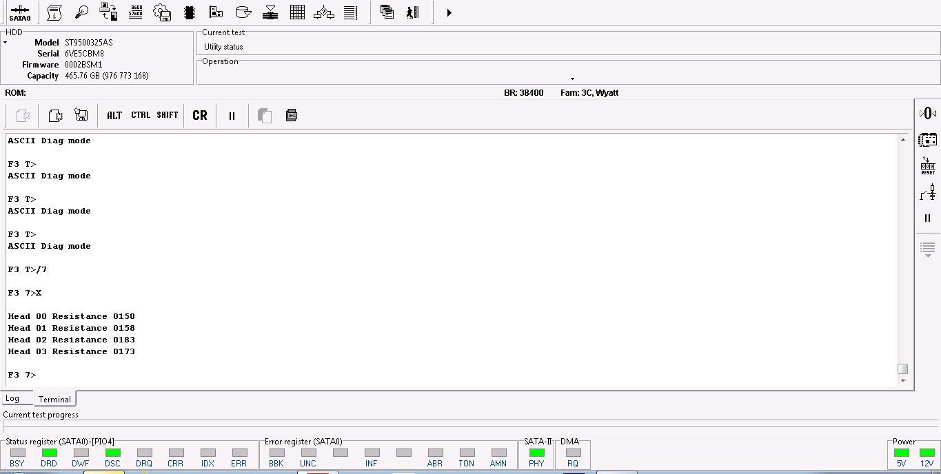

m0,6,3 does not affect NRG entries.
Unfortunately it depends on firmware
 Post subject: Re: Seagate F3 NRG list Dangers
PostPosted: July 4th, 2016, 10:19
Posts: 198
Location: Universe
Wo ! Thank you Doomer Sir for kind intervention. :D
Thanks MindMergepk too.
As final authority has said , outcome of m0,6,3 is not fixed and varies from firmware to firmware.
I have checked resistance of head 0 which is 0150 . reading by head 0 is with continuous reset terminal says issues with 203A file ,I have checked his file which is opening normally . Any performance related file or configuration file of Head 0 might be responsible.

Despite Slow speed I was able to image slower Head 0 sectors & all required data extracted . Besides success valuable lesson is learned.
Thank you all for extending kind help :D
