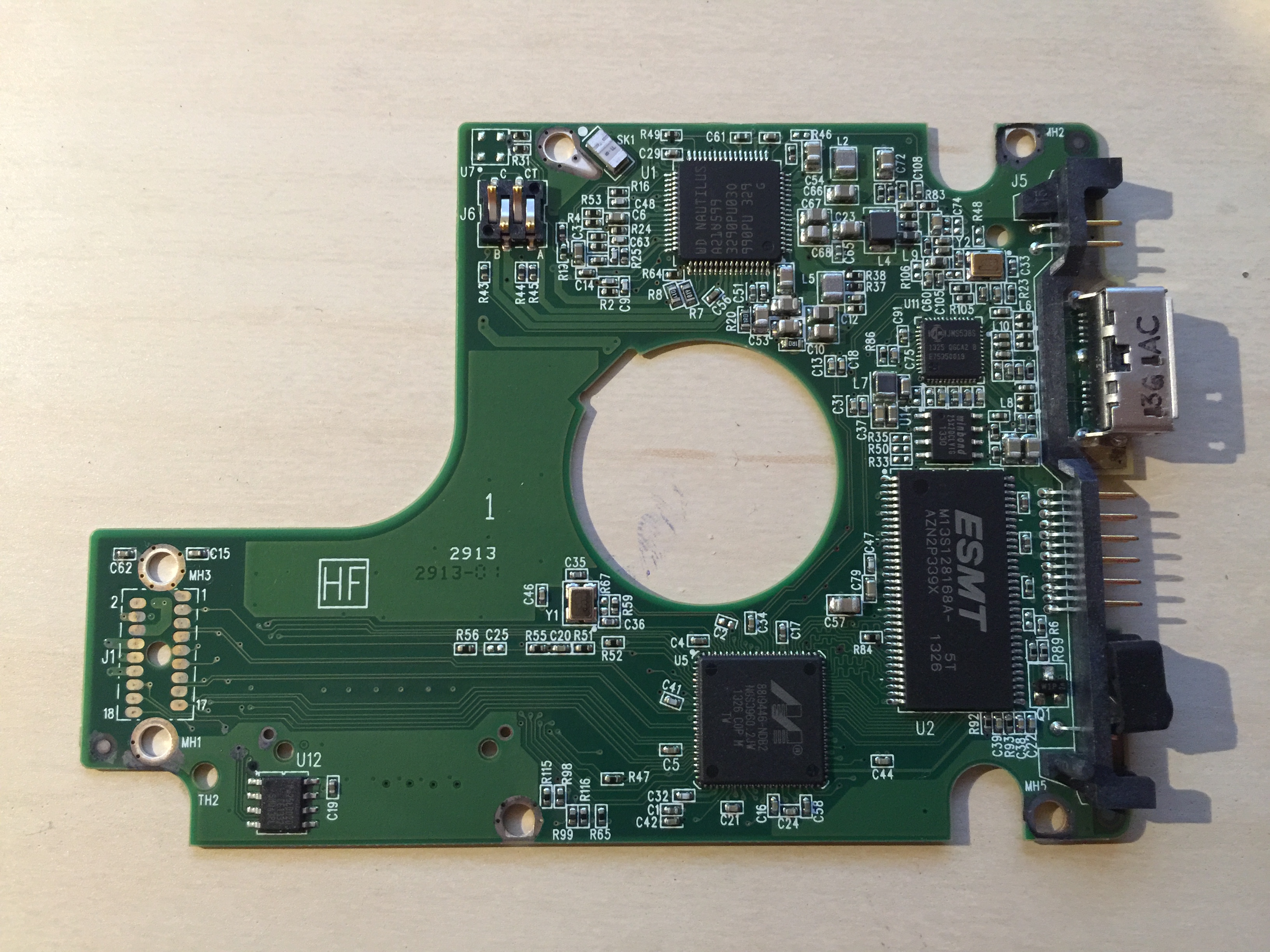

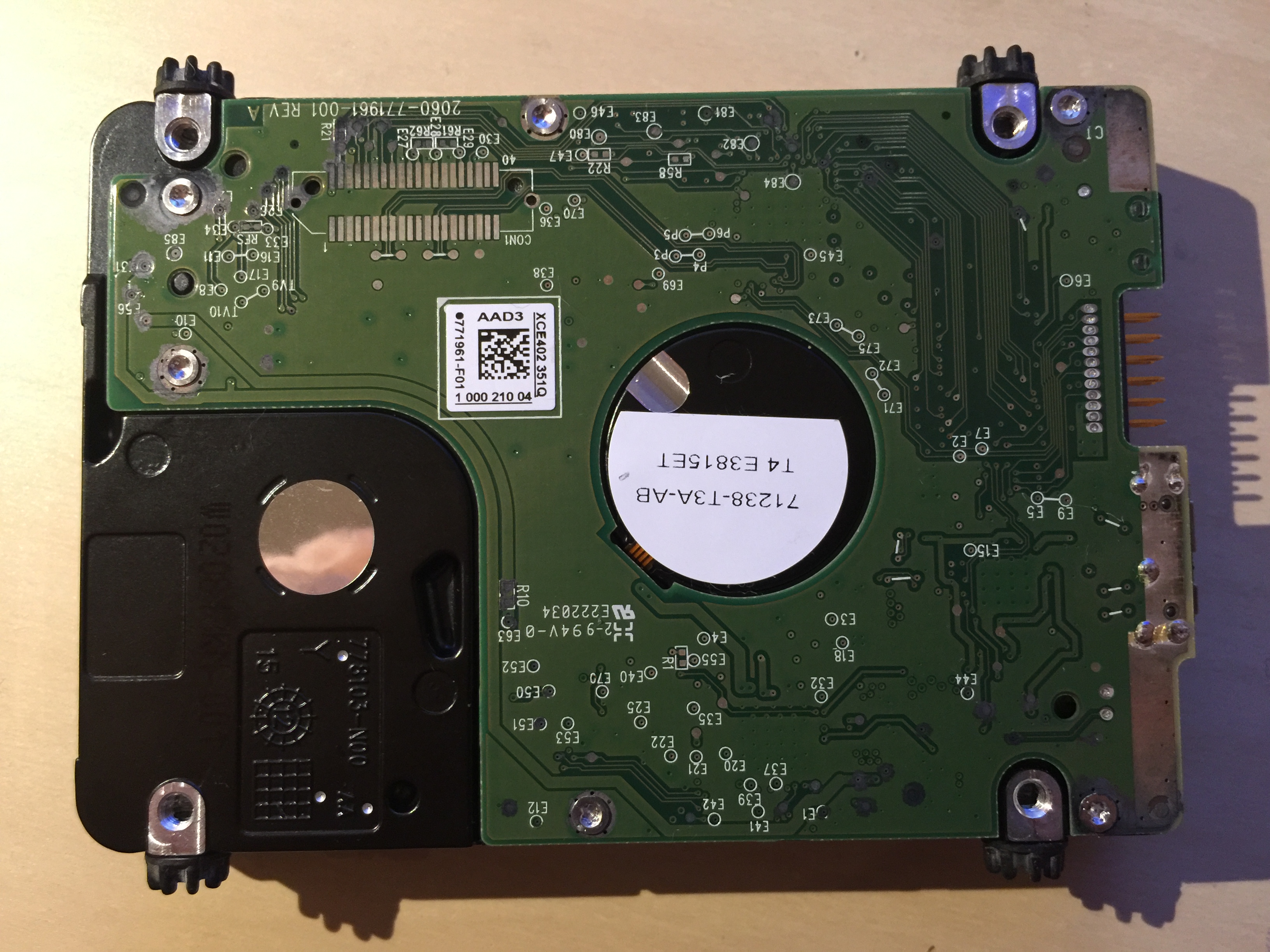

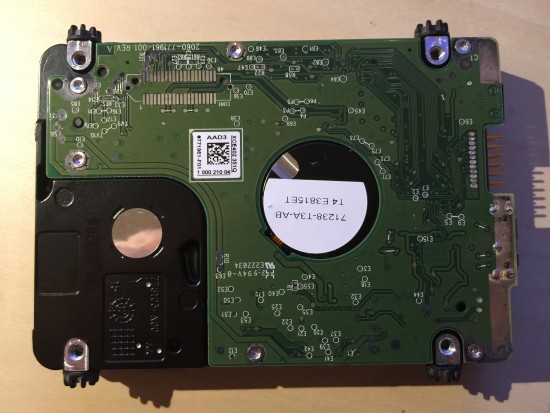

So, I finally took the enclosure apart and snapped the photo of the PCB. Does something not look right, or is it just me? ;)

 Post subject: Re: WD passport WD20NMVW problem: tools to diagnose?
PostPosted: August 11th, 2016, 21:39
Looks normal.
Worried about the bit of oxidation you see on there? It is more or less common.

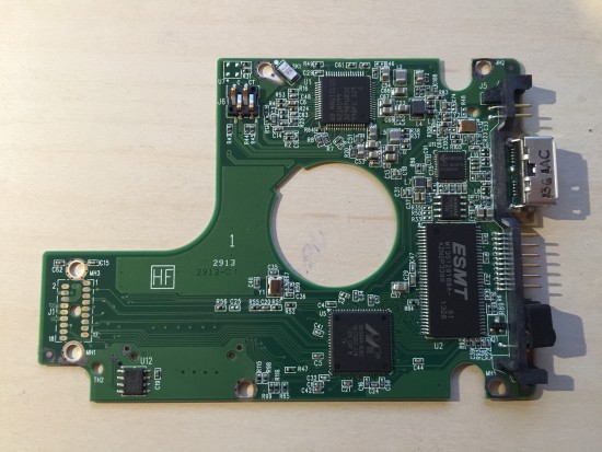

labtech wrote:
Looks normal.
Yeah, that's quite a bit of oxidation. But nothing looks burnt or damaged otherwise...
PostPosted: August 11th, 2016, 22:12
Posts: 17232
BTW, I believe that your drive's encryption is handled by the drive itself, not by the bridge IC. A photo of the PCB (component side) would help to verify this.
The bridge IC is a JMS538S, so it appears that the bridge handles the encryption. Anyway, that's a moot point since your drive is clicking.

pcimage, how can you tell the ROM chip in the board above that I posed? Thanks!
PostPosted: August 12th, 2016, 16:03
Posts: 488
Location: US
Probably you will laugh but it's U12.
No...I actually didn't laugh. My days of building prototype circuit boards made sure I didn't laugh.
So, if my PCB is bad indeed, then I should swap the ROM chip from my old drive onto the donor drive, eh? ;) Reason why I ask is that years ago when I lost two identical hard drives, I found a third one with the same PCB. I swapped the PCB and it actually worked! I was able to salvage the data off the hard drives. But from what I've read, I got lucky, because just swapping PCBs from identical drives won't work most of the time.
PostPosted: August 12th, 2016, 16:26
I am 99.99% certain that a PCB swap will be a fruitless waste of time and money.
