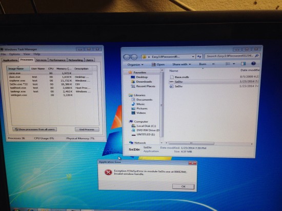

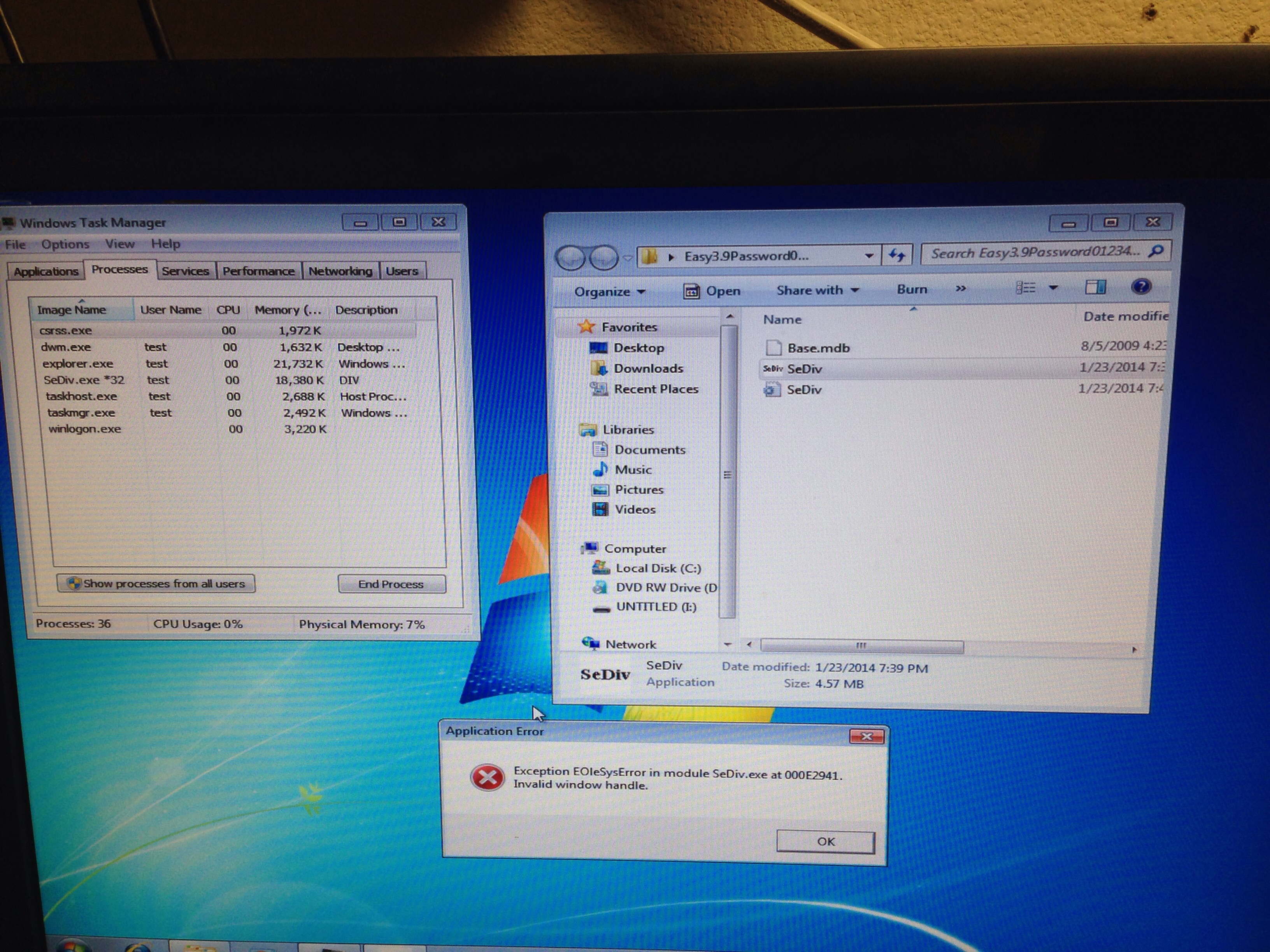

So far have not got SeDiv to run.
Tried in miniXP and it crashes right way.
Installed win7 on a spare HD and got an error that SeDiv crashed but stays running in the task mgr.
Any other requirements for this besides the vague screenshots included?

This what I get with SeDiv

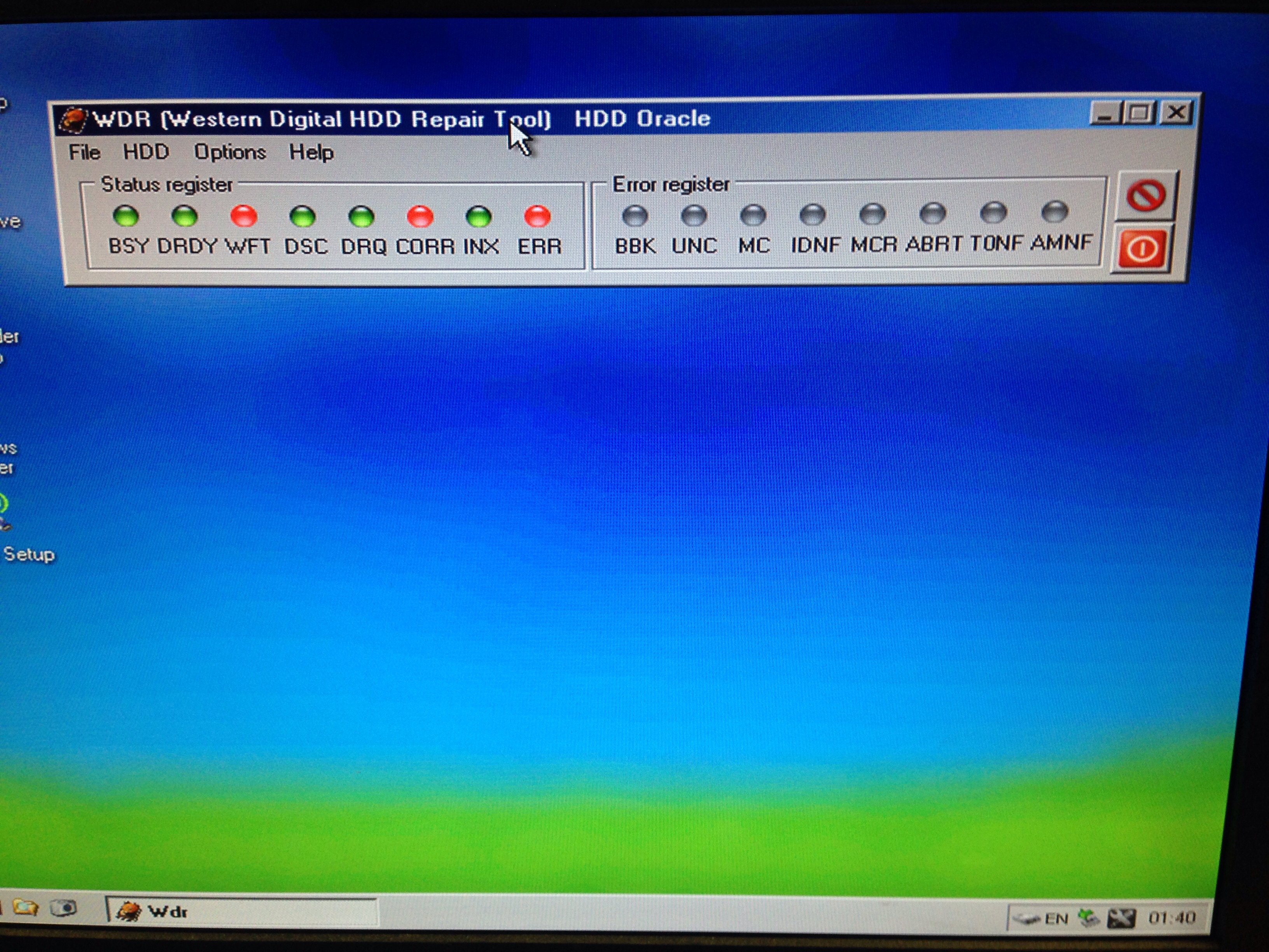

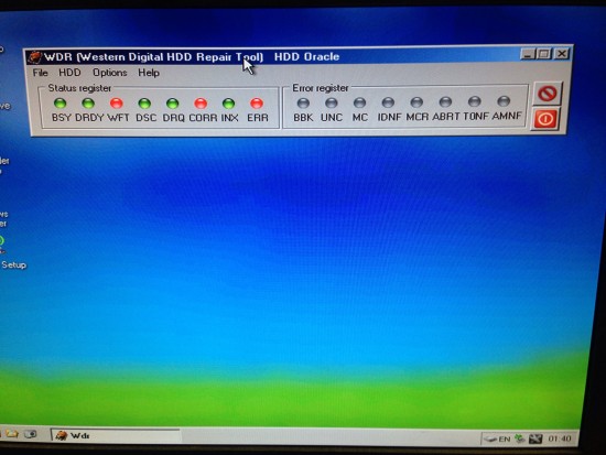

Try WDR Demo:
http://www.hddoracle.com/viewtopic.php?f=32&t=33

What now?
