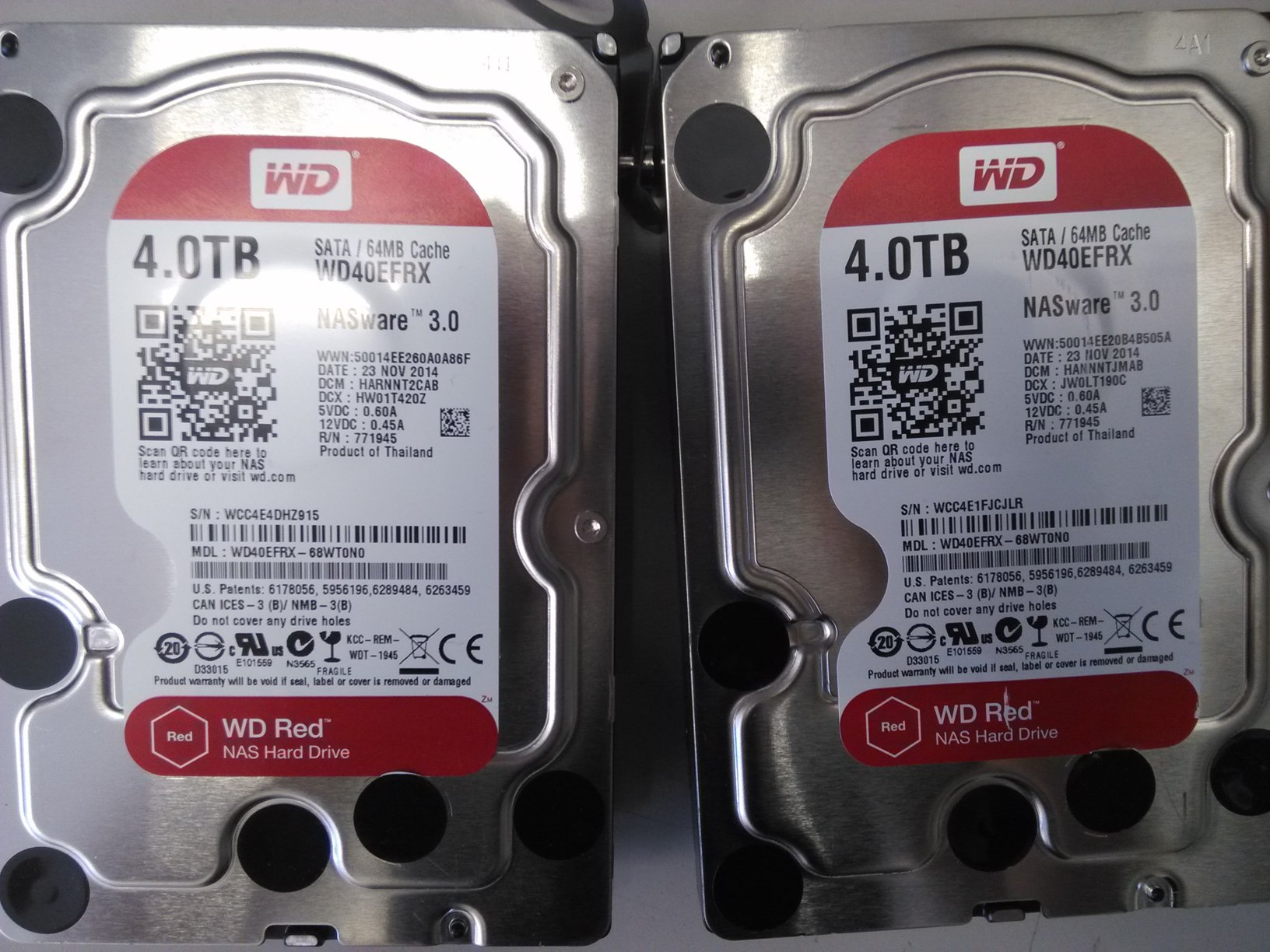

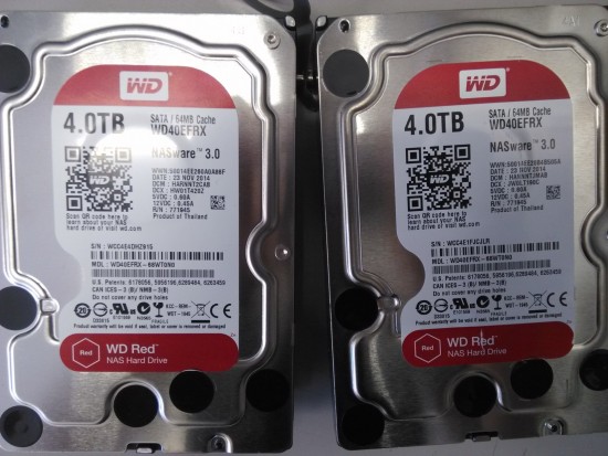

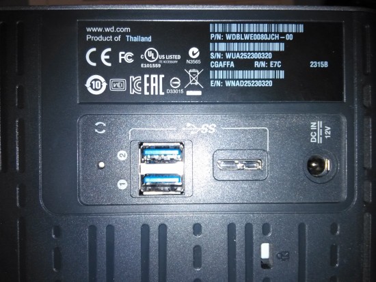

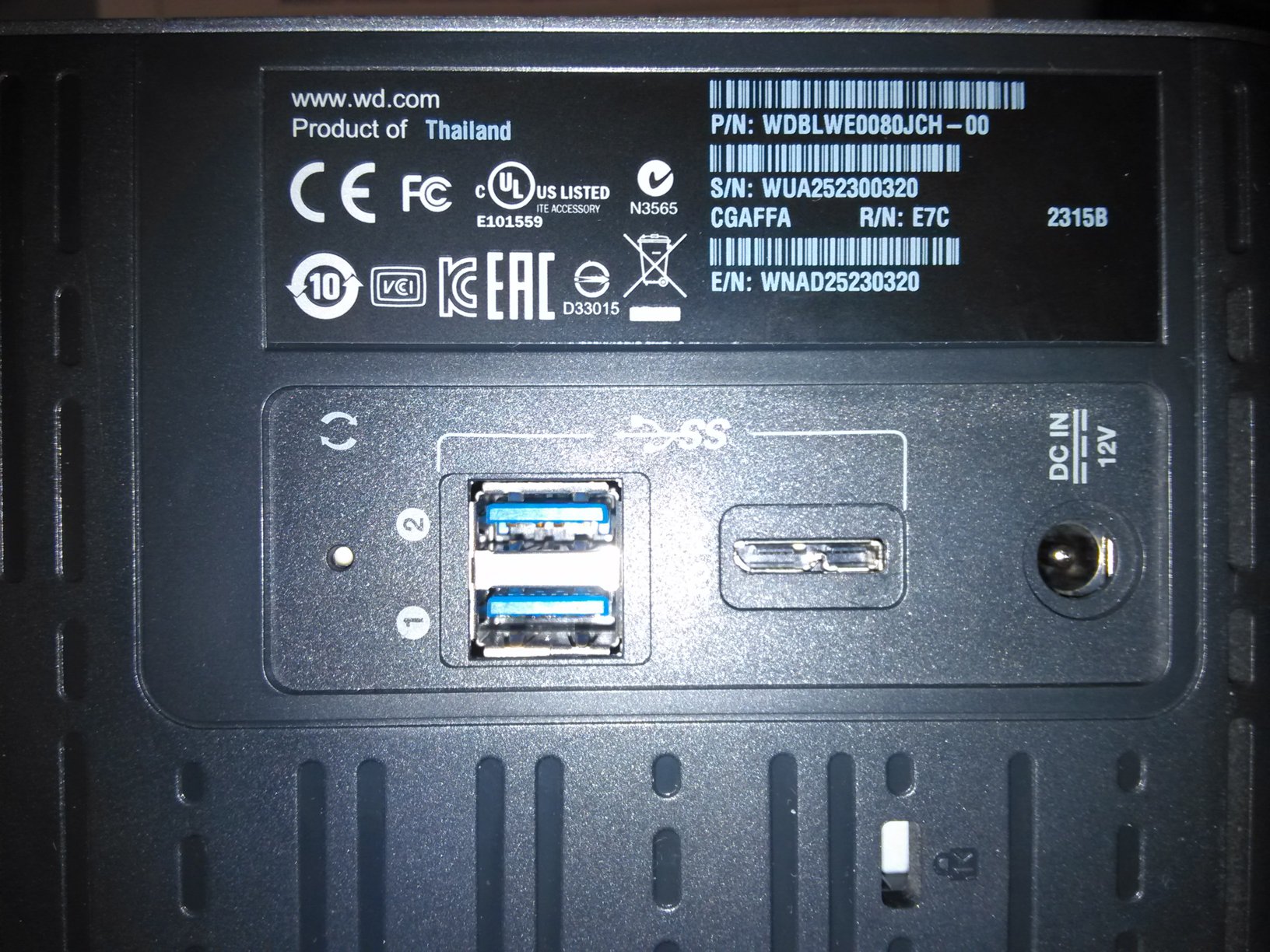

Roberto wrote:
Can you please show us the label of the HDDs from my book duo?
attached.
File comment: mybook duo
File comment: hard disk

maxisvk wrote:
It's original configured in RAID1 but for a mistake i force reconfigure it (again to RAID1) from WD Utility.
Can you please tell me the exact date of the mistakenly reconfiguration?
