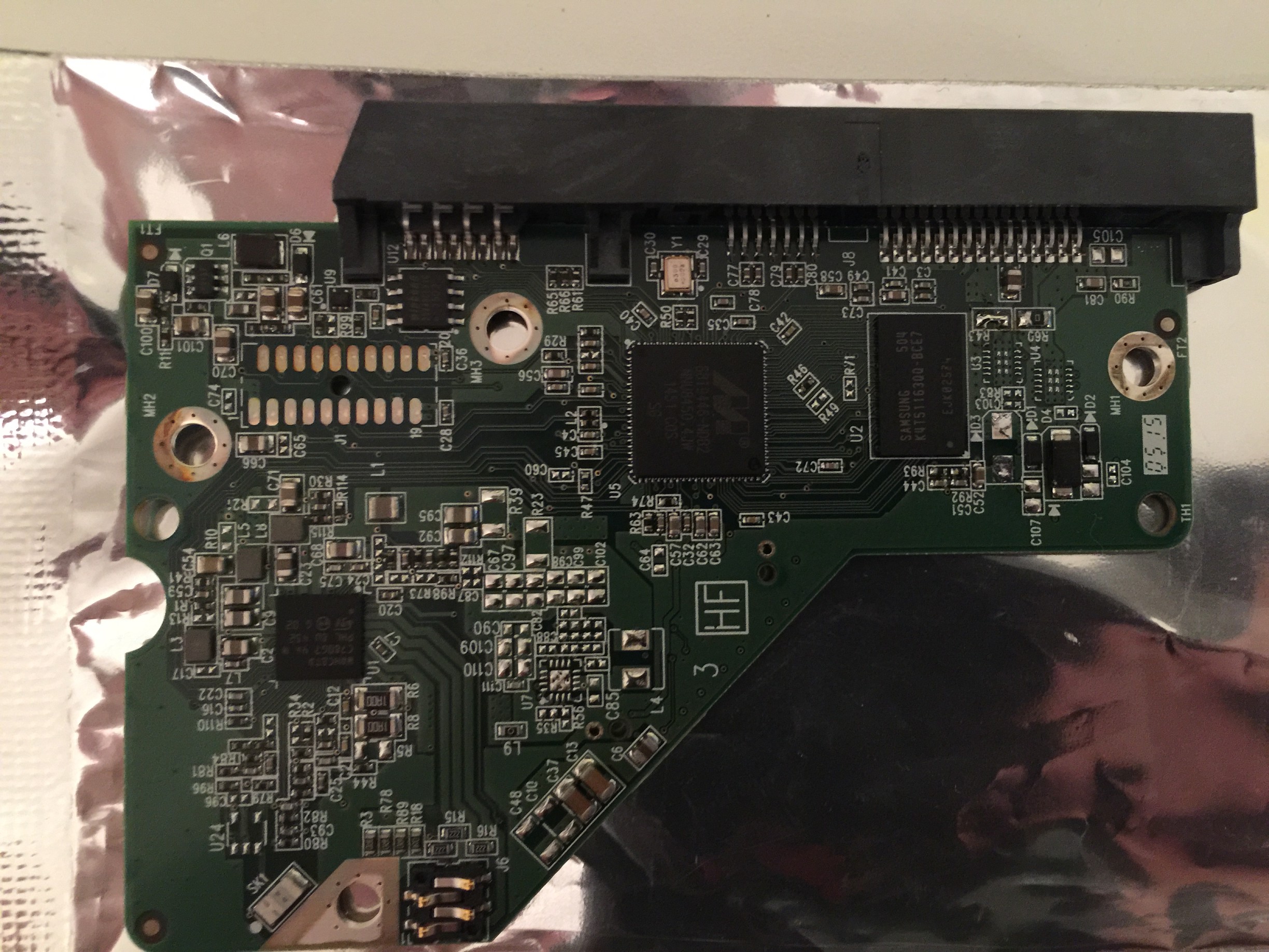

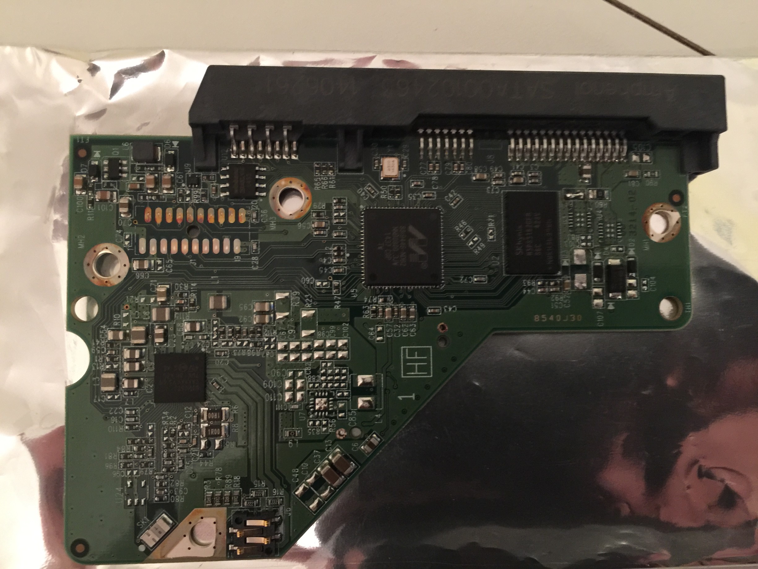

Happy to take some measurements again if they don't seem to make sense with what can be seen.
If the preamp is damaged does this make the DIY route unlikely to work (i.e. removing the diode etc.).
 Post subject: Re: Incorrect Molex Install has Killed Four Drives!
PostPosted: December 15th, 2016, 3:30
Posts: 17217
I would have expected R67 to be open circuit on PCB #1 (the one with the damaged motor controller). Instead your measurement shows 0 ohms.
A dead preamp means that the game is over for you.

I'll test PCB #1 again tonight. I do recall being surprised that it was coming back at 0 as that was the most obviously damaged board. Did some reading on the preamp so understand that if that's gone I'm at a loss.
I have four new drives due to arrive to accept any data I am able to recover. Going to see if I can get the electronics repair store to help with the diode removal and resistor soldering. I also have a spare PSU here that I can use to test the PCBs once they have been modified.

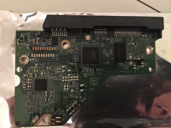

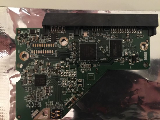

The diode has been removed on each board and the resistors bridged.
I can't actually test the PCBs on the HDDs for another couple of days, but will report back once I have had a chance.
File comment: Board 2
File comment: Board 3

Attached the Boards 2 and 3 to the Hard Drives this evening. Both the drives were detected fine by my server and it appears that all of the data was intact.
The drives were used in an Unraid server with dual parity so I was able to recover the data on the other two drives (Boards 1 and 4). I have removed the other two drives (Boards 2 and 3) from the server now and a rebuilding the array.
Thanks for all your help! Have a good Christmas.
Boards 2 & 3 were designed correctly while 1 & 4 were not. Congratulations on your good luck.
