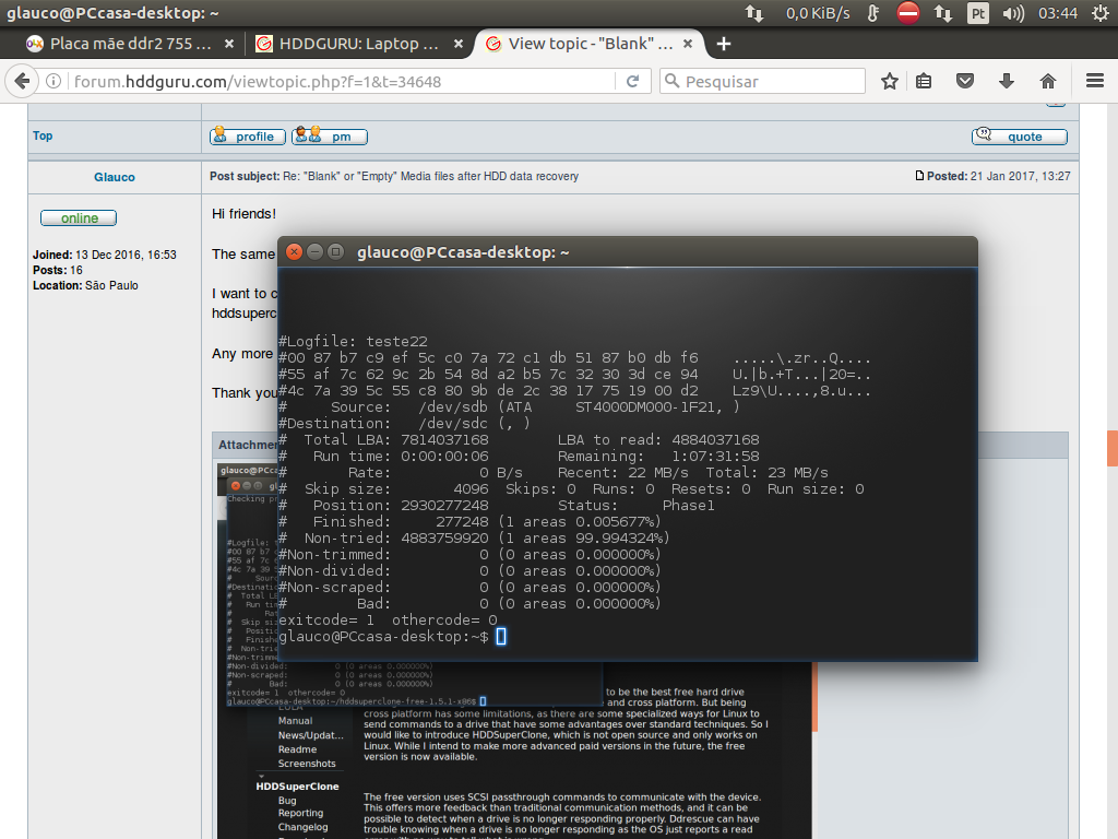

Re: "Blank" or "Empty" Media files after HDD data recovery
January 20th, 2017, 18:08

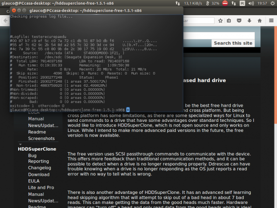

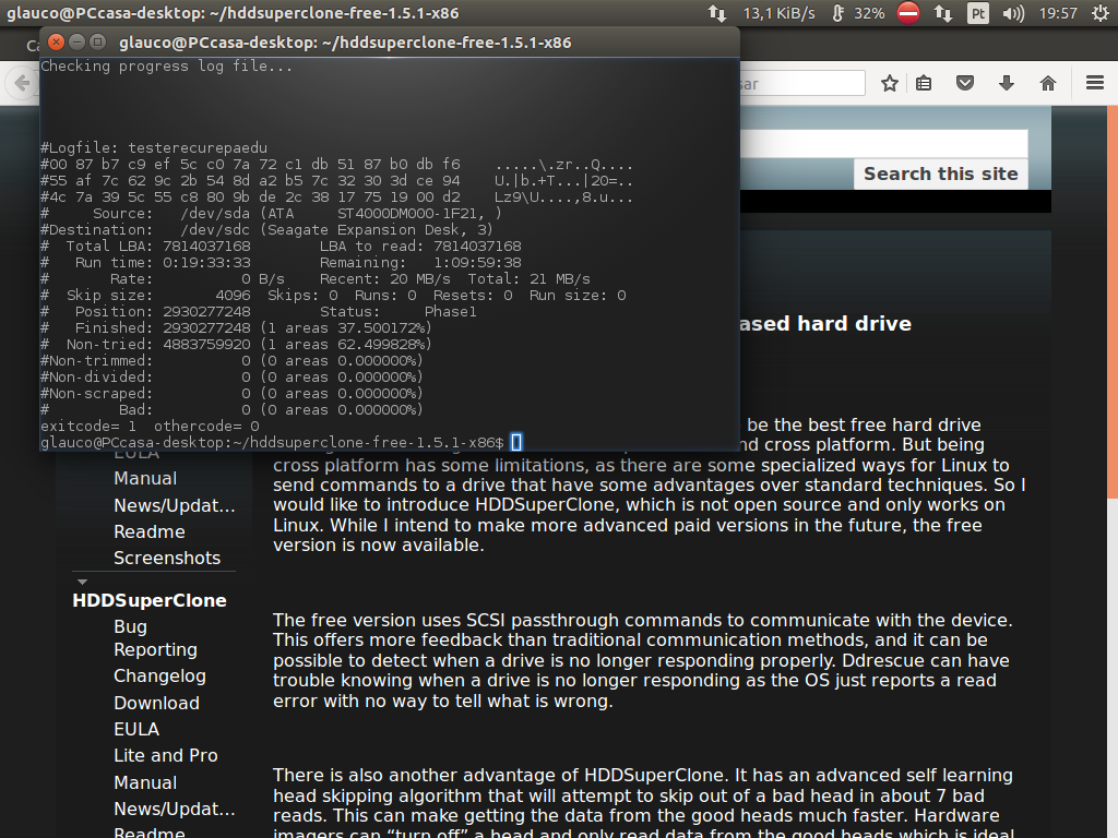

Hello everyone!
I started trying with hddsuperclone. And the results were these, when it suddenly interrupted.
I tried to restart the process with the log file but, apparently (I do not know if I did something wrong), it started from scratch. I'm running it again, let's see ...
Thank you all!
January 20th, 2017, 19:08
First, are you running from a live CD? If running from a live CD you need make sure the progress log file is being stored on an external drive, a flash drive will do. I can see that your log is likely being stored in the default home folder, and with a live CD that is in RAM, which will be cleared if you reboot. Also, you must get the log name exactly correct, or it would start a new one. It should not have started over.
Second, I do not know why hddsuperclone exited like that. There should have been an additional message to explain the reason. If that happens again, try an older version of hddsuperclone, maybe version 1.4 or 1.3. I need to know if it is something I broke with recent code changes in the program. I am concerned that it is not behaving properly :?
Third, since this drive is connected directly and not USB, you should use the --ata option for this drive (if you are not already). It could give additional information in the log, and possibly on a sudden exit. You should be able to stop the recovery, and add the option to the command line and resume.
If it stops again, along with screenshot please provide the progress log file.
January 20th, 2017, 19:39
To add to what Spildit just posted, since it did recover up to LBA 2930277248, and since you stated that it looks like it started over, you can add the following option to the command line to start the recovery at that LBA:
-i 2930277248
This will make the recovery start from this position on the drive. You can adjust this number to a higher value if there is a issue with this spot on the drive causing the exit.

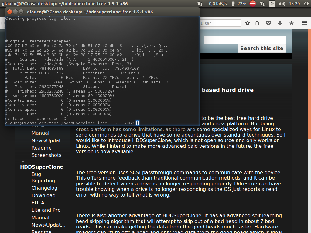

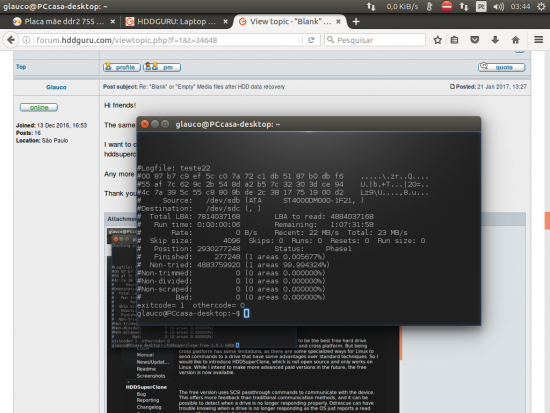

Hi friends!
The same again! Apparently, the problem is in LBA 2930277248. I will try what you said and return the results.
I want to colaborate with @maximus in hddsuperclone project.
hddsuperclone was the only that indicates me, at least, where is the problem.
Any more ideas? Instructions?
Thank you

Glauco wrote:Hi friends!
Thank you
I forgot to say that the log file was not created.
My procedure was:
sudo hddsuperclone
choose the log file name
choose the source drive
choose the target drive
In what location should the logfile be?
Thank you

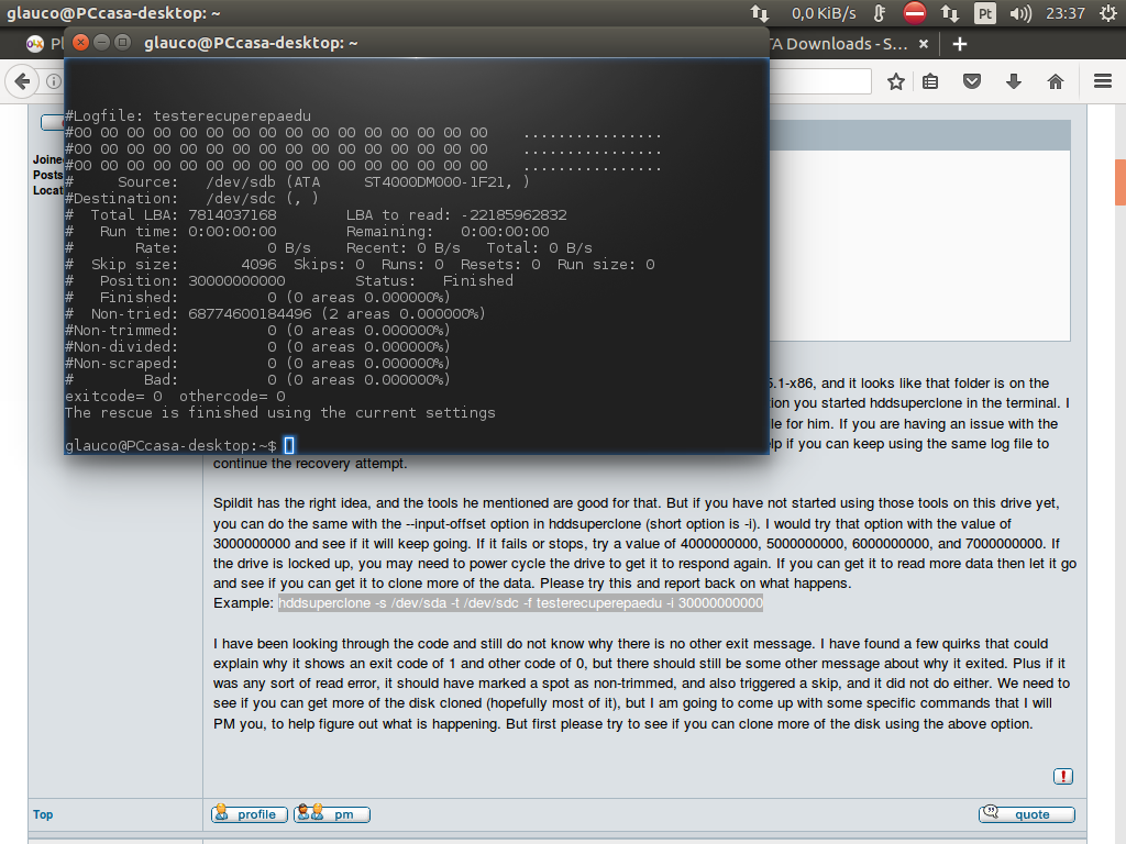

January 21st, 2017, 20:07
My procedure was:
sudo hddsuperclone
By looking at your screenshot, the log file should be in the folder hddsuperclone-free-1.5.1-x86, and it looks like that folder is on the desktop. Unless you specify otherwise, the default location for the log file is in the location you started hddsuperclone in the terminal. I know of someone else using this version of hddsuperclone, and it is producing the log file for him. If you are having an issue with the log file not being produced, I will need to work with you to figure out why. It will really help if you can keep using the same log file to continue the recovery attempt.
Spildit has the right idea, and the tools he mentioned are good for that. But if you have not started using those tools on this drive yet, you can do the same with the --input-offset option in hddsuperclone (short option is -i). I would try that option with the value of 3000000000 and see if it will keep going. If it fails or stops, try a value of 4000000000, 5000000000, 6000000000, and 7000000000. If the drive is locked up, you may need to power cycle the drive to get it to respond again. If you can get it to read more data then let it go and see if you can get it to clone more of the data. Please try this and report back on what happens.
Example: hddsuperclone -s /dev/sda -t /dev/sdc -f testerecuperepaedu -i 30000000000
I have been looking through the code and still do not know why there is no other exit message. I have found a few quirks that could explain why it shows an exit code of 1 and other code of 0, but there should still be some other message about why it exited. Plus if it was any sort of read error, it should have marked a spot as non-trimmed, and also triggered a skip, and it did not do either. We need to see if you can get more of the disk cloned (hopefully most of it), but I am going to come up with some specific commands that I will PM you, to help figure out what is happening. But first please try to see if you can clone more of the disk using the above option.
January 22nd, 2017, 21:59

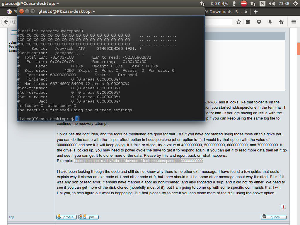

@maximus, First of all, i´m sorry, the logfiles is in my home folder, i was not finding it.
I tested with hddsupercone, the HDD don´t starts the test over 30000000000.
I tryed MHDD, it doesn´t shows this HDD, only my system drive. I'ḿ runnig from my CR-ROM. Is there any command or parameter to make this HDD shows up?
Victoria is for windows and i just have windows in my notebook. Only USB connection with this drive, in a case.
Tomorrow, I'll install Windows in this PC, in dual boot.
I looked for Victoria for Linux and did not find it. Is there another similar one that I can test to see if the disk reads after this LBA? Or has this hddsuperclone test been enough to be sure?
You mentioned a powercycle in HDD, how to do this?
I will download the beta version of hddsupeclone. Do I need to uninstall this one I'm using before?
Thank you all so much!
January 22nd, 2017, 23:13
You added one to many zeros to your command. You did 30 000 000 000 instead of 3 000 000 000 (separated by spaces to show the count). Please try again with the correct values.
No, the installation should replace the current version.

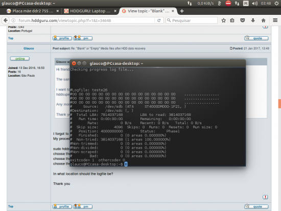

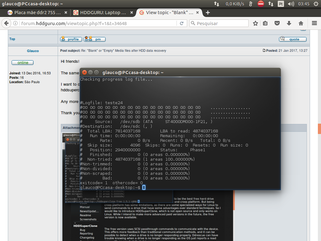

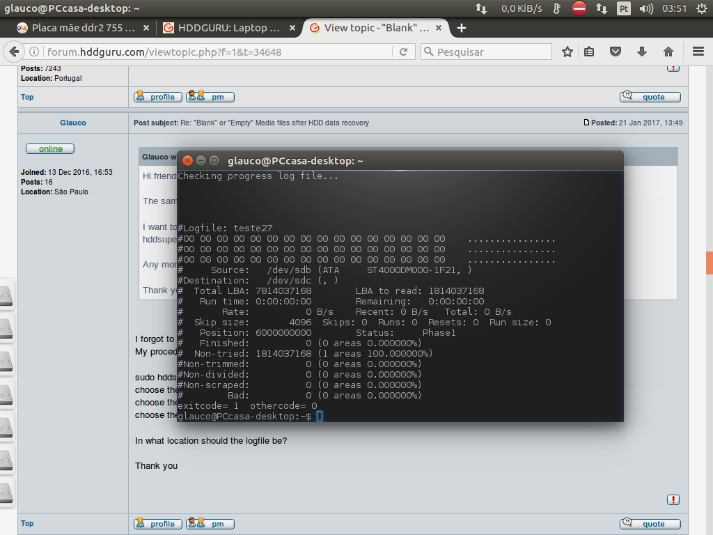

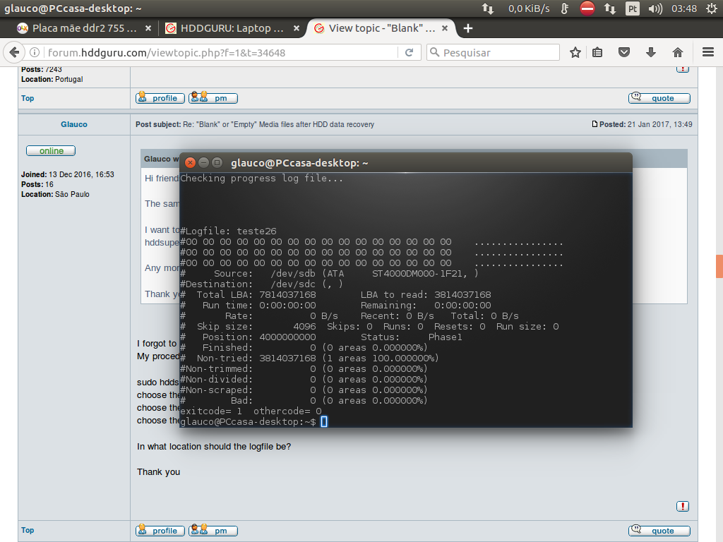

January 23rd, 2017, 2:08

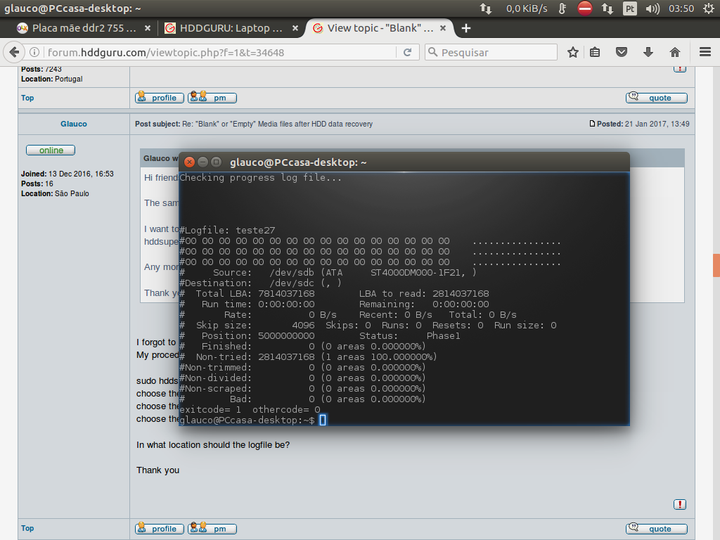

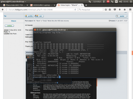

Hi @maximus i did it again...
Really, after LBA 2930277248 it lost comunication.
I tried starting in 2930000000 hddsuperclone read at 2930277248 and finished the process. After this, i tried with 3, 4, 5, 6 and 7000000000. Nothing...
Thank you for help!
January 23rd, 2017, 2:39
Glauco wrote:After this, i tried with 3, 4, 5, 6 and 7000000000. Nothing...
might be translator
