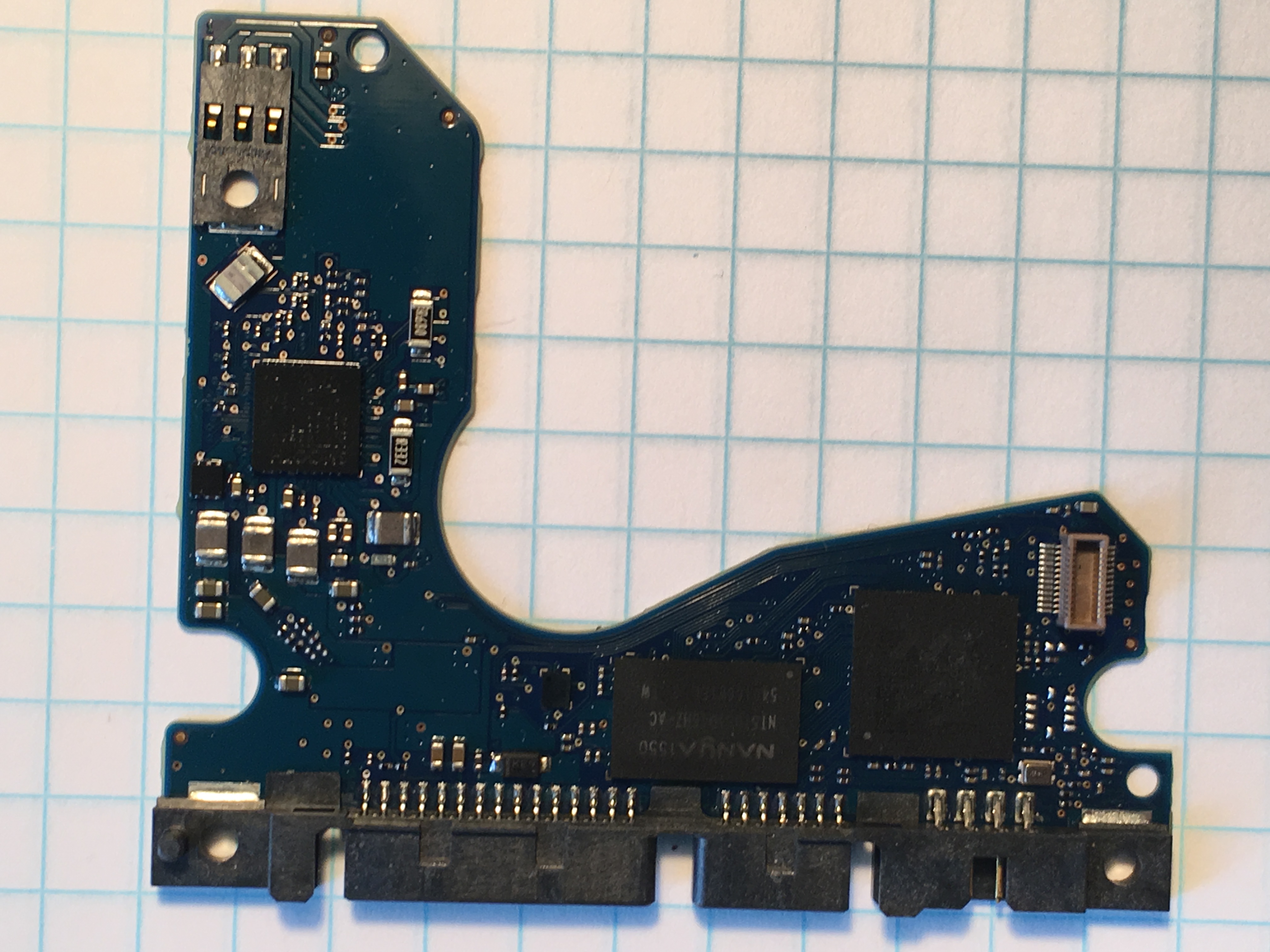

Front side

nanoic wrote:
I found the Marvell hdd controller becomes very hot in original board. That makes me think the board has a damaged chip although the motor can still spin.
most likely the flash ship is dead too
if so - data is unrecoverable
 Post subject: Re: Identifying firmware chip
PostPosted: January 25th, 2018, 17:49
Posts: 3592
Location: Chicago
Spildit wrote:
Doomer wrote:
If so drive shouldn't spin with native PCB ....
Unless the ROM chip got damaged while moving it to the new PCB ...
yeah, missed that part :)
Yes, the drive cannot spin w/o working Marvell chip and working flash with correct FW content
