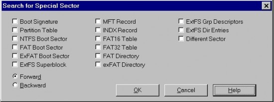

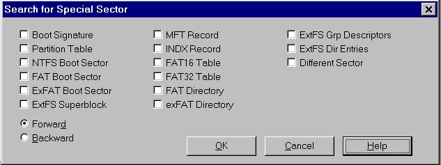

DMDE's "NTFS search" will find all NTFS components including MFT and INDX records, if they exist. In fact the OP's search results display a count of the numbers of such records.
Tools -> Search for Special Sector will find particular file system components.

Under special sectors which ones should I select? Only MFT and INDX or I need more?
