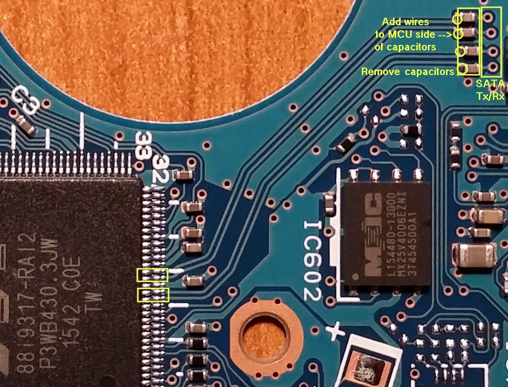

Yes, the SATA conversion would be a good idea.
Here is a SATA PCB which uses the same MCU (88i9317-RAI2):
Follow the SATA Tx/Rx signal pairs from the MCU to the SATA data connector. Then wire your USB PCB the same way. Remove the capacitors and connect your wires to the MCU side of each capacitor (do not use the plated thruholes on the RHS for your connections).

unknown wrote:
Find a compatible SATA PCB and transfer ROM's(IC602) then connect it directly via SATA interface.

castiman wrote:
Hello to all,
I’ve been reading over the forums, but I didn't find similar symptoms as my drive.
Either PCB or BUSY status due to background processes.
Take a PCB from MQ01ABDxxx as the donor PCB, replace IC 602 (ROM) to the donor PCB. Previously check is MPU (processor 88i9317-RAI2) and motor driver IC (TLS2605) are the same (should be in this case). If it is BUSY status, probably, better to ask some nearest professional person/company for help.

Martin wrote:
castiman wrote:
Hello to all,
@the OP
"take into consideration"
overheating, burning (Etc.) that chip and your data is gone
you might want to consider a pro to the job for you
