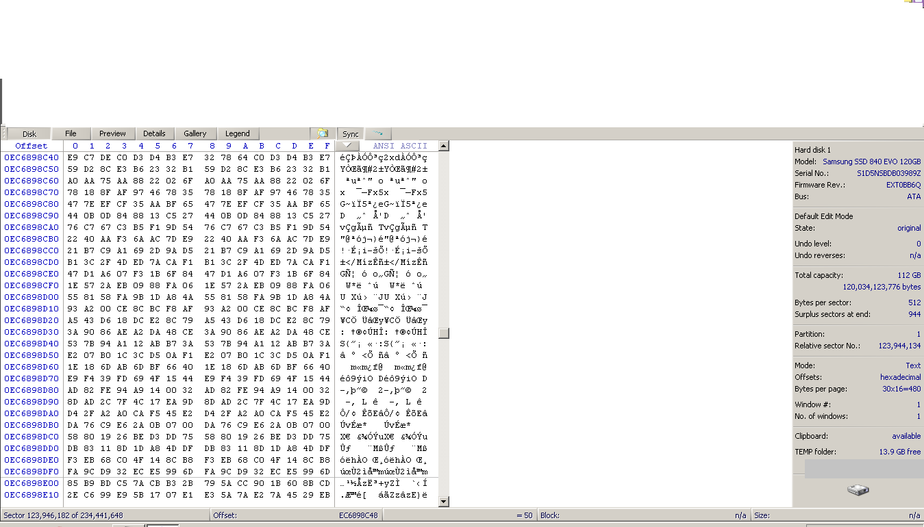

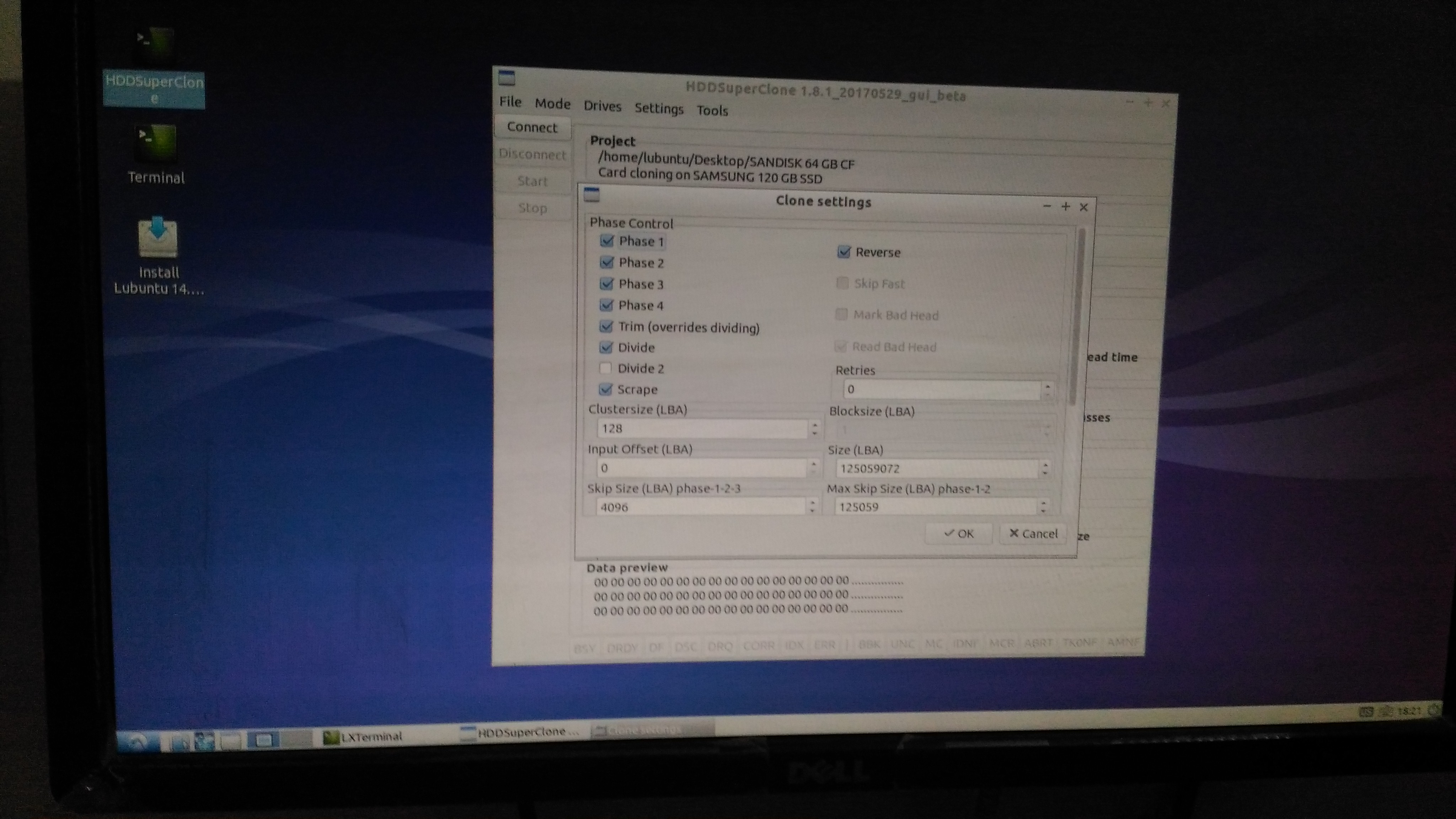

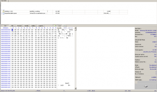

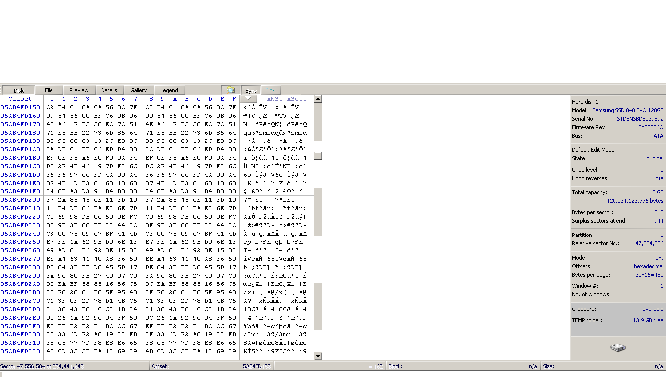

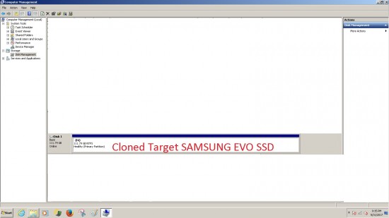

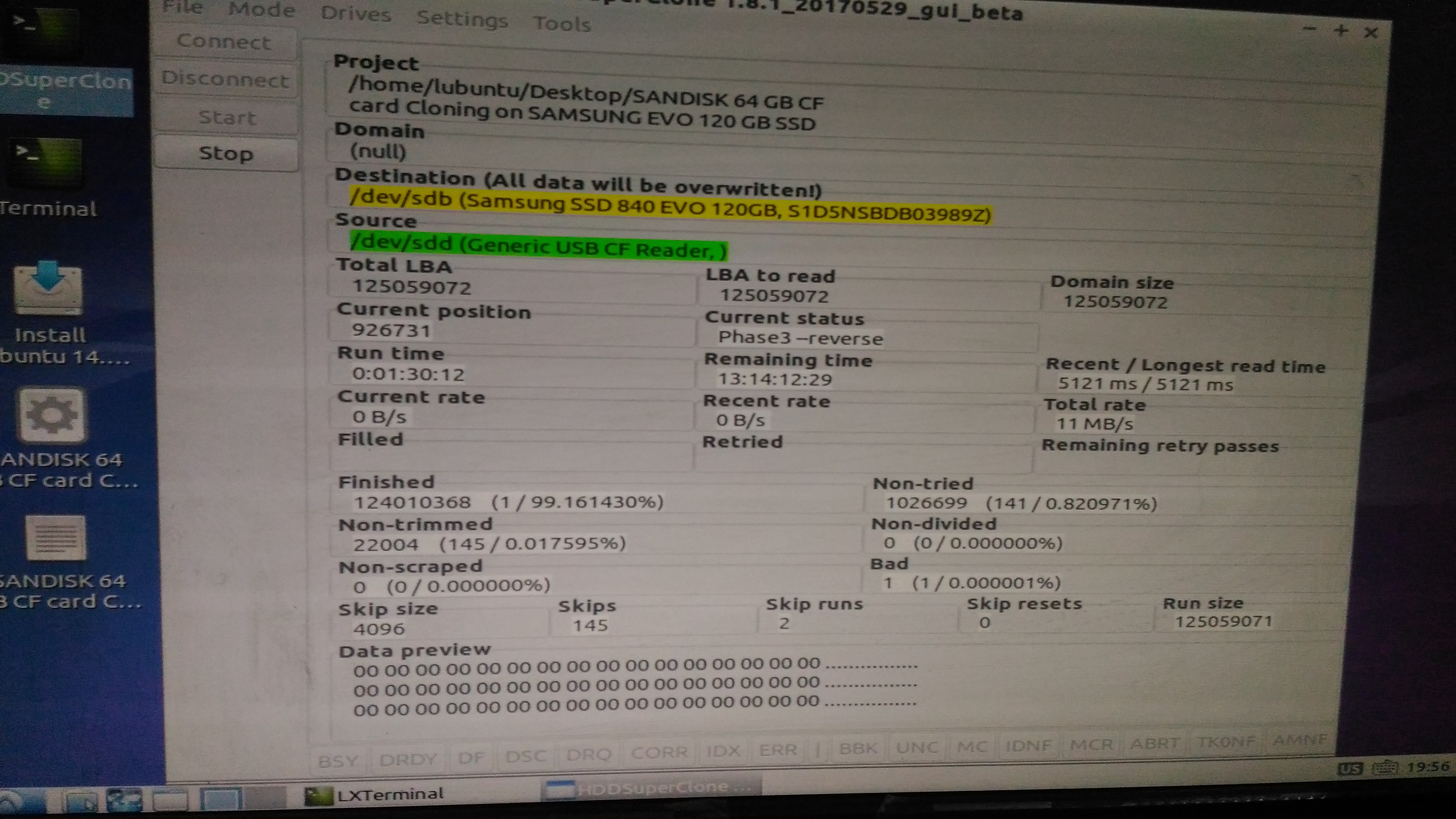

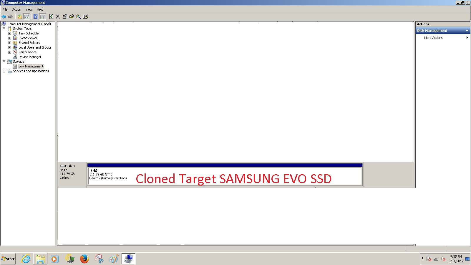

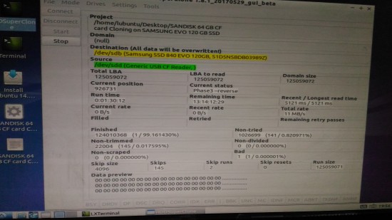

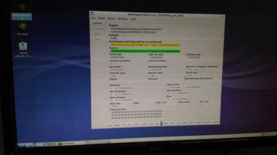

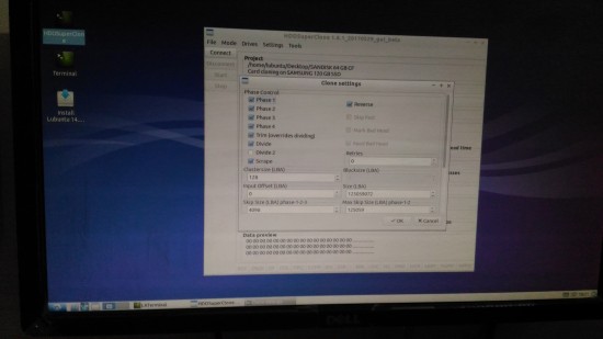

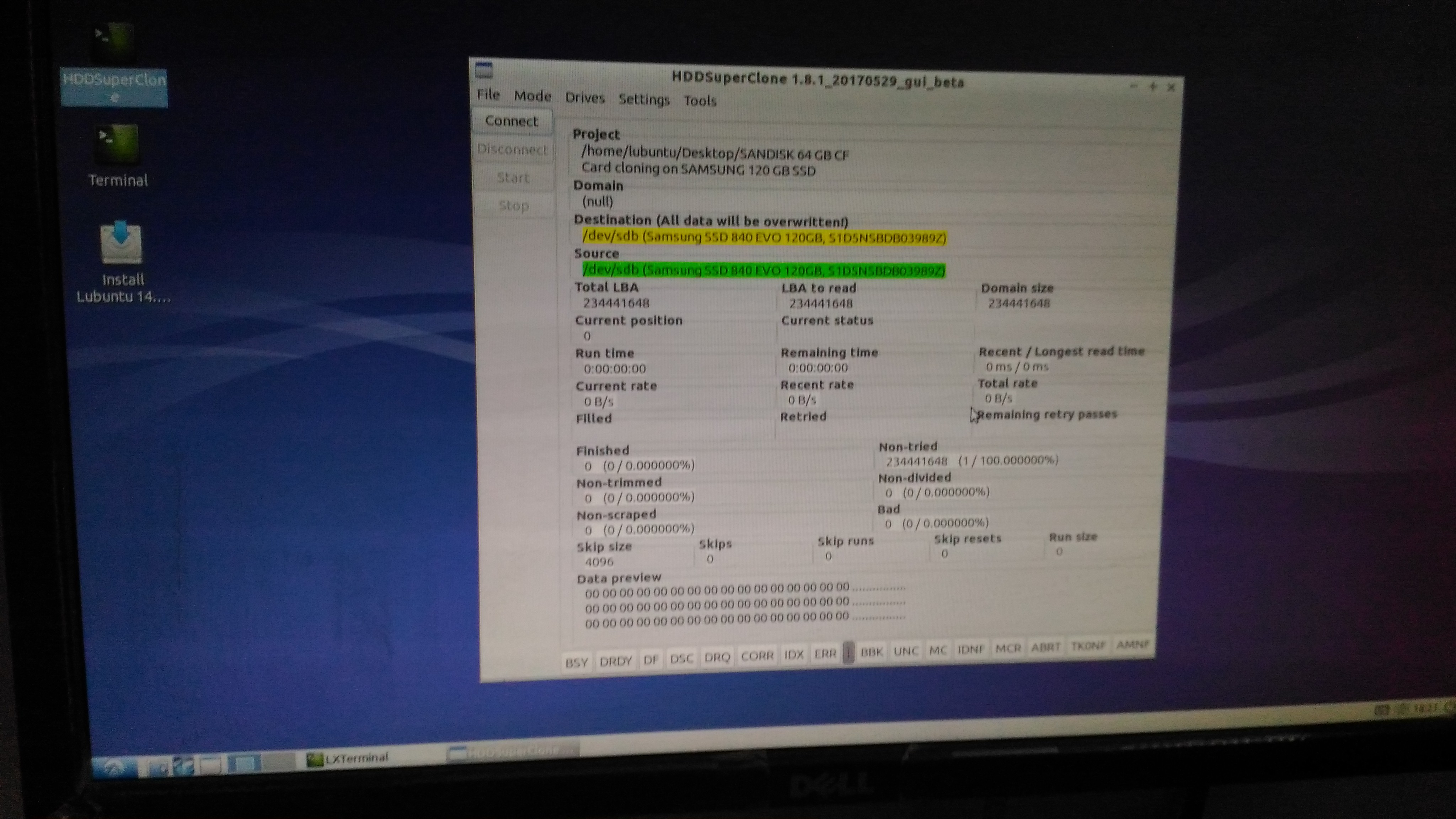

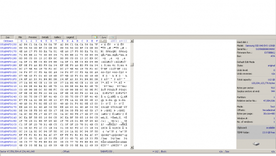

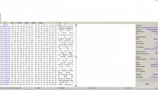

Congratulations maximus for developing best cloning tool. I tried gui version on CF card today. I have selected reverse clone . Almost 99.16% cloning was successful . Unfortunately cloned disk does not show any data (though it shows NTFS file system )
As per customer card is not getting recognized suddenly & he has not done anything.
I am fearful as maximus has said , it could be be issue with commands not working on flash media.
My concern for putting this thread was because of this reason only. HDDSUPERCLONE is the best option for hard disk cloning. I have decided to clone 10 differnent types of hard disks ( SAS/SATA /IDE ) and test hddsuperclone extensively on DCO /HPA , and to verify SHA1 of both source and target. This is only to help maximus , my small contribution for his great work.
I think its clear now why I was looking for a commercial cloning tool for flash media. Meantime I have got response from tool developer ,he has quoted exorbitantly high price so I have closed that subject.( I can buy 2 deepspar units in quoted price) . Besides no evaluation is possible.
Now I have 2 options --
1) Customer or person who might have done R&D before me ,might have accidentally formatted card in camera in order to recover data.
(often several cases I get are formatted by DIY customers as well as DR technicians in order to gain access to inaccessible media)
2) Try some other tool /technique -- pls.suggest.

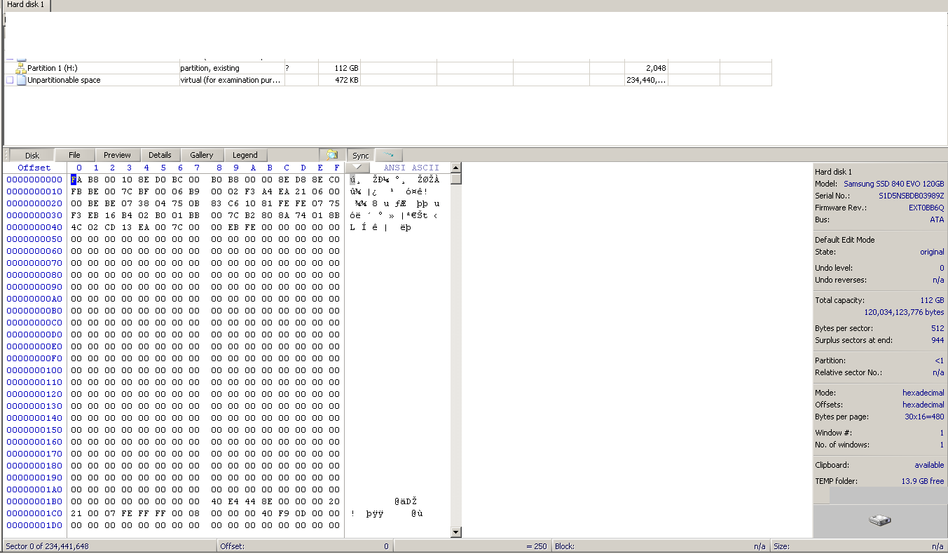

hex view cloned ssd
hex view cloned ssd
Hex view cloned ssd
Re: Cloning Tool
May 31st, 2017, 14:48
Why does the target drive have a 120GB NTFS partition? If the card was formatted in a camera, then it should have a 64GB partition, most probably FAT32 or exFAT. I'm guessing that someone "initialised" the card in a Windows machine.
I would examine the clone with a disc editor, eg DMDE. Can you show us DMDE's Partitions window?

@bunty, can you create an image ( not clone to other disk ) with ddrescue and compare the beginning of this image to the beginning of the disk you cloned to ?
Re: Cloning Tool
May 31st, 2017, 19:22
bunty wrote:Congratulations maximus for developing best cloning tool. I tried gui version on CF card today. I have selected reverse clone . Almost 99.16% cloning was successful . Unfortunately cloned disk does not show any data (though it shows NTFS file system )
I think that the first many sectors are not readable from the memory card. They would therefore not be copied to the destination, and any data that already existed on the destination in those areas would still exist. That would allow it so show a partition that did not really exist on the source memory card. When using a physical destination, it is best to write all zeros to it before cloning. Hddsuperclone has an option to zero fill all areas that were not recovered. But you must save the project (progress) file and keep using it, because it keeps track of the progress and makes the recovery able to be resumed. Your project file was saved to the desktop of the live CD, and unless you copied it to a more permanent location, it will be gone when shut down.
Re: Cloning Tool
May 31st, 2017, 19:54
I would also like to say that if you can post the progress (project) file from the hddsuperclone recovery, I can provide some analysis. With conventional hard drives it can usually be determined if there is just a bad spot, a weak head, or a dead head. I have no idea what to expect from a memory card failure, but it will show what sectors were recovered and which were not.
You may have to do a raw data recovery on the cloned drive using a tool such as rstudio or getdataback. But since you are trying to clone to a drive that is larger than the source, you really need to write zeros to the entire destination before cloning. That will assure that no data other than what is on the memory card will end up on the clone.

Yes I have zero filled SSD before cloning so no remanant data was present. I have tried raw recover using winhex but nothing was found.
Fortunately I have copied log file. Pls.check whether cloning was successful and what could be actual issue.

From examining the log file provided, my assessment is that you have the best clone possible with a software only tool. The data at the beginning that has not been read shows no signs of having any readable data. Reads up to sector 0x0fffff (1048575 sectors, or 536870400 bytes) all failed.
FYI You could possibly get another 128 sectors right at the cutoff of good reads and bad, but I doubt that is worth much considering the situation.
