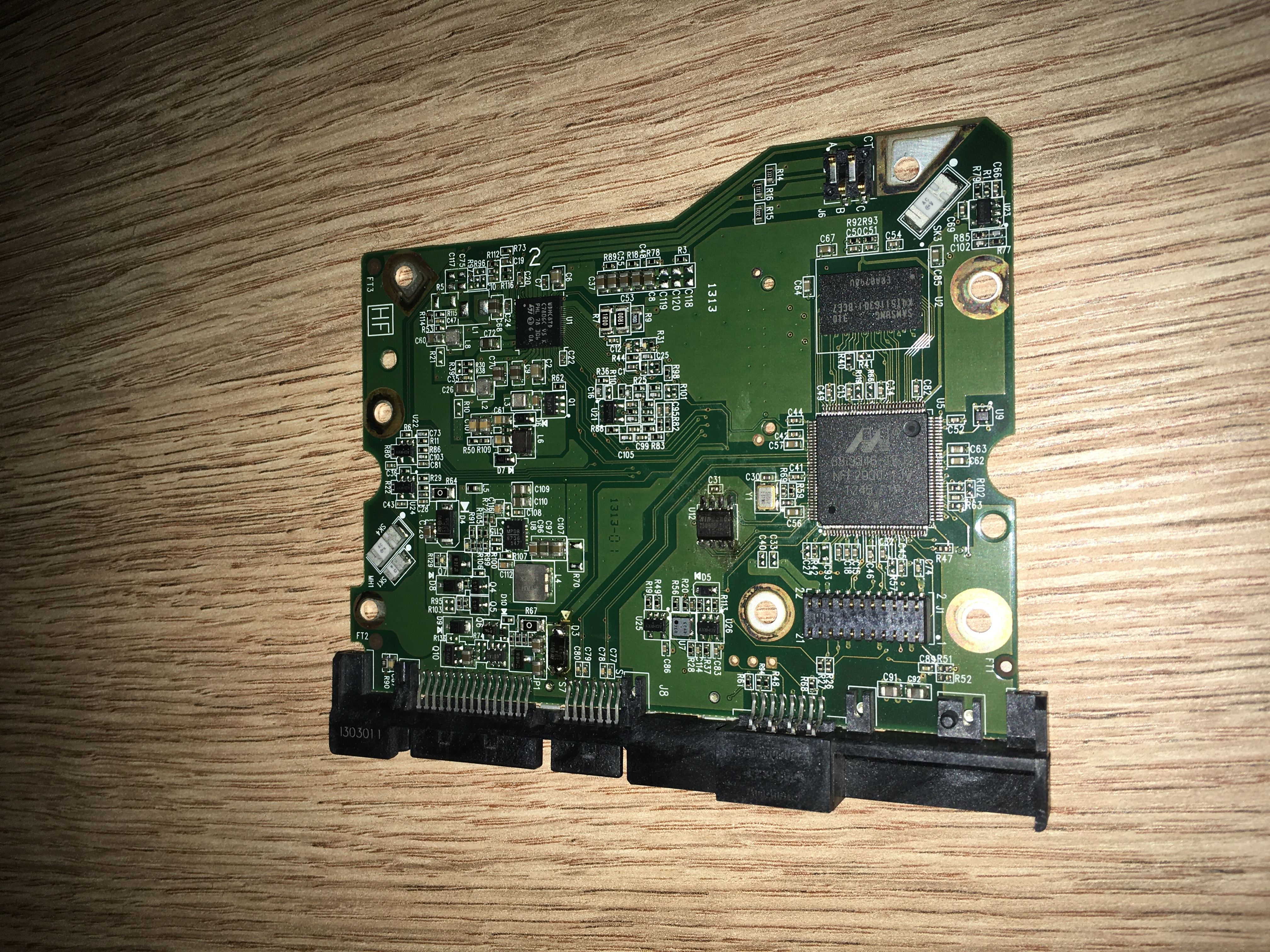

Hi everybody,
I learned a lot about data recovery from this forum, especially from Fzbakar's comments. I successfully recovered a couple of disks I had corrupted and damaged, but I faced a challenge that seems like it's impossible to solve now.
My WD3000F9YZ-09N20L0 had been in an overvoltage situation and it stopped working. I connect the disk, but it doesn't spin, doesn't show in the computer BIOS or OS. Since I have three such disks, two in a different computer I tried to replace PCBs between the broken disk and donor one and changed the BIOS as well. The disk had started but the capacity read by BIOS was 2.19TB and it couldn't read the disk's serial and any details about the disk. It looks like it couldn't read the bios(firmware), but I am not sure. Then I put the firmware back to the original (broken) PCB (because I thought it couldn't work on the other disk's PCB) and replaced the TVS diode, but that didn't help either. The disk now starts and is recognized by the computer, but it still doesn't show the disk serial number or capacity, or any other detail. It can't be initialized. When it was with the other PCB it was clicking, but now with the original PCB it just starts spinning, but it doesn't click. I've opened the disk for a split second and heads are positioned in the normal position as if they were in standby, they were not stuck on the plates of the disk.
My only concern is the BIOS (Firmware) dead or is some other diode or chip dead for protection of the firmware or due to voltage surge.
This is the PCB I have: https://www.hddzone.com/wd-2060771822002-pcb-p-567.html
I would appreciate any help regarding the issue since I have some data I would like to recover from this disk.
Thanks in advance,
Milos

If the drive spins up, then the "ROM" firmware is OK.
Which diode was shorted (D3 or D4), and was its associated zero ohm resistor (R67 or R64) open circuit?

Thanks for this quick answer. It was a D3 diode.

It was D3 that was replaced. I haven't checked R67 or R64, I can check them tomorrow. Is there anything else I should be aware of?
BTW, what makes no sense to me is that when I put the firmware on the new PCB and connected it to the disk, it was spinning and clicking five times, then it was unavailable to initialize. Why didn't it work with the new PCB when it's 100% working board?

Clicking suggests that the overvoltage on the 5V input killed the preamp on the headstack. What I don't understand is why your original PCB doesn't click.
If you can upload a detailed photo of your PCB, I can show you where to test the preamp.

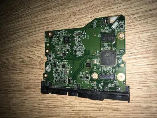

Thank you for your answer and sorry for the delay, I've been very busy at my work.
So here is the image of my PCB. As you can see one TVS Diode is now replaced and the disk is now shown in disk manager (can't be initialized), starts rotating but no head sound. However when I put the same PCB, but from the other disk, it starts rotating and heads click 5 times and then stop for some time, then they click 5 times two more times and that's it.
Can I give you any other details?

That ROM swap looks sketchy.
Preamp is probably gone. And you can only hope for the damaged preamp did not wreck your data. Yeah, you may have learnt a lot but not enough, since most of the times the guys recommending TVS diodes or pcb do not tell you it is a large scale kind of hazard.
Contact HelpDisc if your data is important.

Sorry, I can't identify the preamp supply pins just by visual inspection. I expect they would be near the 1 & 2 end of the connector.

If you can send a closeup shot of the ROM that would help.

@ddrecovery I can share the close up on Wednesday. Thank you for your effort.

@jaksa95, can you do some measurements on your donor PCB?
Start by measuring the resistance between the 5V input at the SATA power connector and each of the pins of the HDA connector (J1).
https://pinoutguide.com/Power/sata-power_pinout.shtml
If you find no connection, then use the 5V TVS diode as the 5V source for your measurements.
Otherwise, it may be that the power is switched by the "6BTAV" SOT23-6 component.
Si3456BDV-T1-E3, Vishay Siliconix, MOSFET, 30V 5.1A 2W N-ch, marking 6Bxxx, TSOP-6:
https://www.vishay.com/docs/72544/72544.pdf
Next find which of the pins of J1 connect to ground (eg a screw hole).
Then measure the resistance between these 5V and Ground pins at the connector on the drive. That should tell you whether the preamp is dead.
