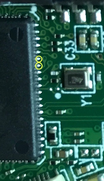

I wonder where these pins go. Perhaps they go to the 12-pin connector, or maybe they connect to the MCU.

u mean the bridge?
