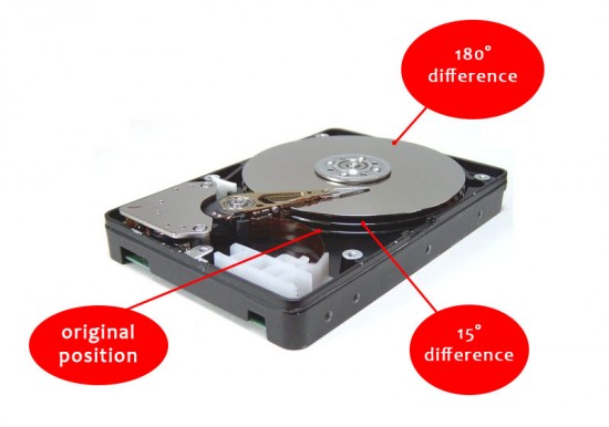

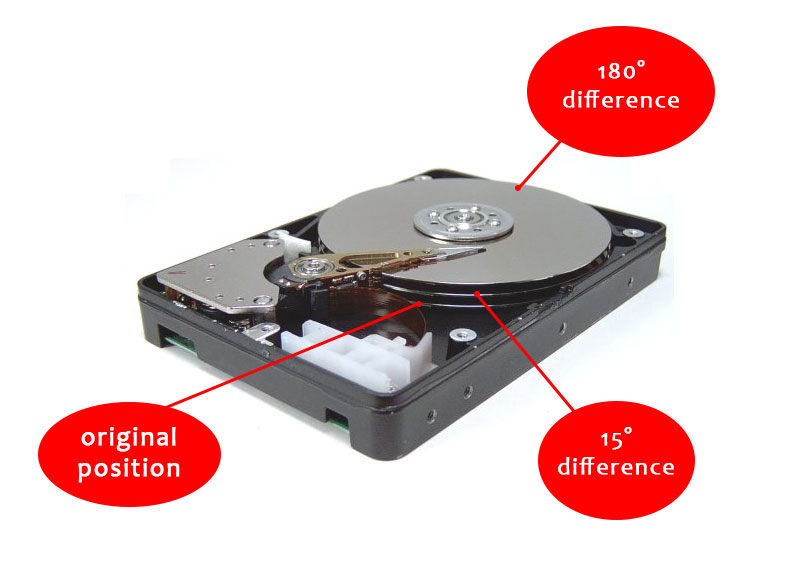

I completely agree with you! For example i extract 2 platter from damaged hdd and put inside donor one and i respect 1st platter and 2nd vetically without rotating faces! But if i rotate the 2nd one about 180 degrees respect the 1st horizontally (or value that you want) what this rotation will cause?? a misalignment or nothing ? maybe just an increase of seek time right ??

here a sample on what i mean attached

@XAN, let me just clarify my position. I accept that rotating the platters results in some kind of misalignment, but I don't understand why. Like you, I would expect that there would be an increase in head skew when switching between platters. However, ISTM that this should simply result in a very minor performance hit, not a dead drive.
The only other possibilities that come to mind are runout and imbalance. However, I would think that these effects would be present even if rotational alignment were maintained.
