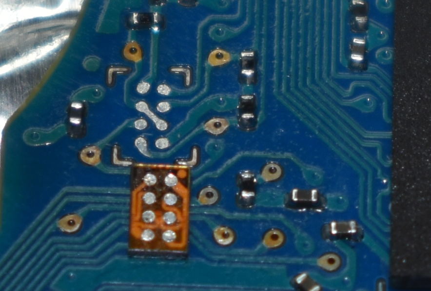

Ok...
Well seems the vitriol has been flying whilst I have been away.
Let me make it very clear, I consider ANY data supplied , be it solid advice, data-sheets or website links or code repositories to have been very helpful. (* ANYTHING that saves me time)
for those who "give advice" but clearly know Sweet FA about reverse engineering, it is VERY common in well designed system roms, for "disabled" corrupted" devices to put systems into debug or bypass mode. (say deliberately blocking NAND/RAM chip address lines/chip id's), it is by testing such hypothesis that we may find new modes of device recovery.
I've enclosed a picture with the SPI EEPROM removed, so other members can see the tracks under the device.
Picture was via Digital camera and not via optical rework station.also EEProm is on its BACK so pin 1 is shown top right )
Yep the quality of the PCB really is like the picture
These devices are difficult to remove, I would recommend pre-heating the PCB from underneath masked off with Polyimide tape.
Aslong as your air rework pencil is not set to high it is easy to remove the device without blowing the resistors near by off the PCB.
Re-balling seems to be necessary once the device & PCB have been cleaned up.
Also it is clear that Seagate have at-least two PCB manufacturers, one of which is complete GARBAGE...............
The "Defective" PCB , is clearly over exposed and the resist out of focus, also the copper mask is poorly defined & etched as well as corroded under the solder & plating, it's the kind of cheap assed PCB I would expect in a Chinese made set top box
