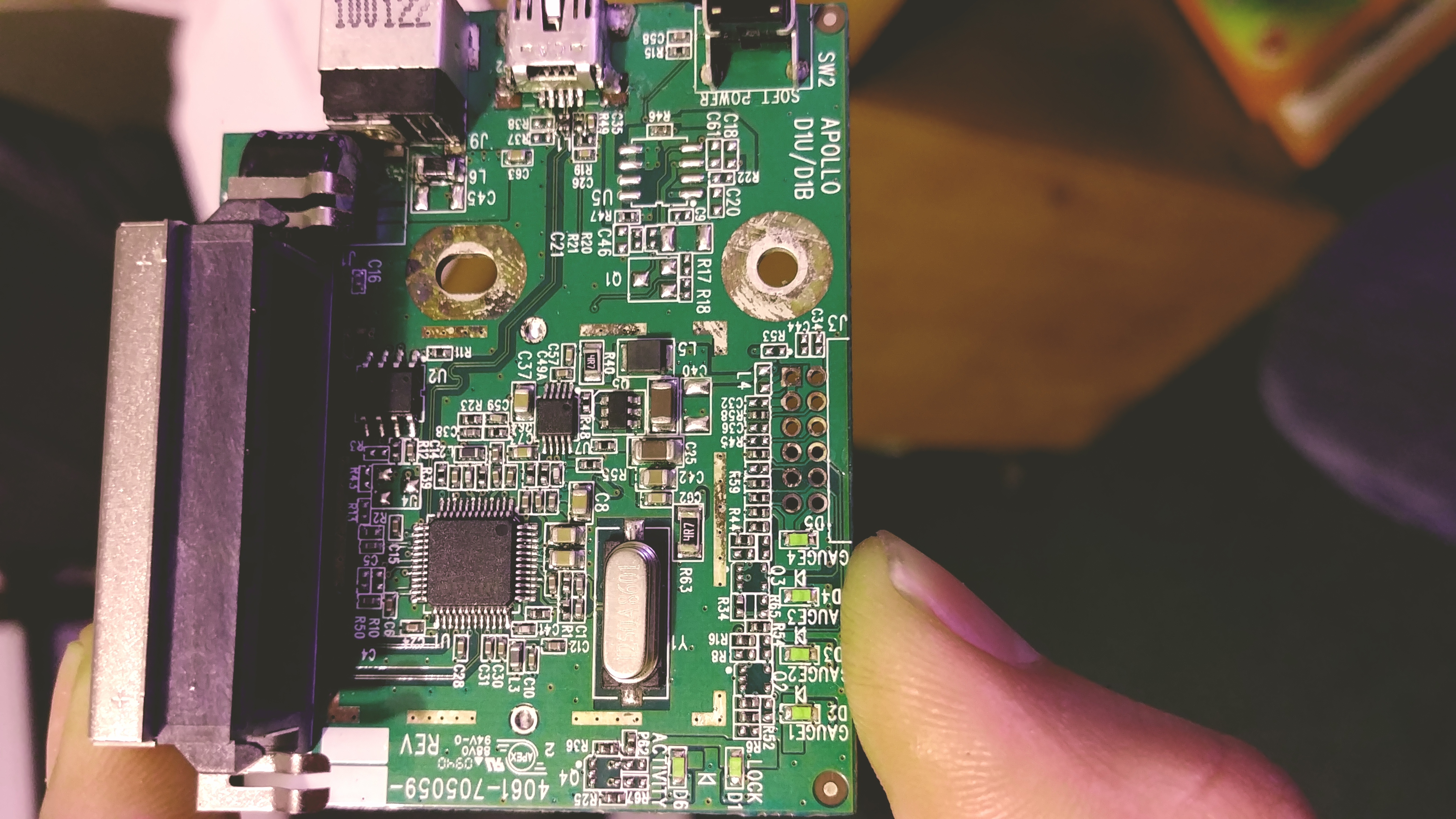

Maybe some chip swapping will be necessary. It depends on what is on your original board, and what is in the new one.
Also, have you tried to just read only the hdd directly connected to a normal computer ( not a notebook ) ?
Other : can you post a picture of the original board, in the state it is now ? Areas of importance are those around the usb connector with the damaged traces, and the R46 resistor frank pointed you at.
 Post subject: Re: WD My Book Essential 2.0T Problems
PostPosted: January 24th, 2018, 20:41
Joined: January 22nd, 2018, 12:57
Posts: 28
Location: Athens, USA
It's no good, that tiny thing the 2 middle prongs of the usb connector tracers run to is no longer there. It's physical missing smd parts now

What smd is at L1?
PostPosted: January 25th, 2018, 0:31
Posts: 17323

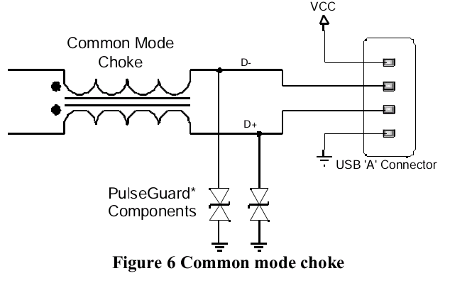

L1 looks like a common mode EMI suppression choke. Each coil should measure close to zero ohms.
High Speed USB Platform Design Guidelines:
http://www.usb.org/developers/docs/hs_usb_pdg_r1_0.pdf

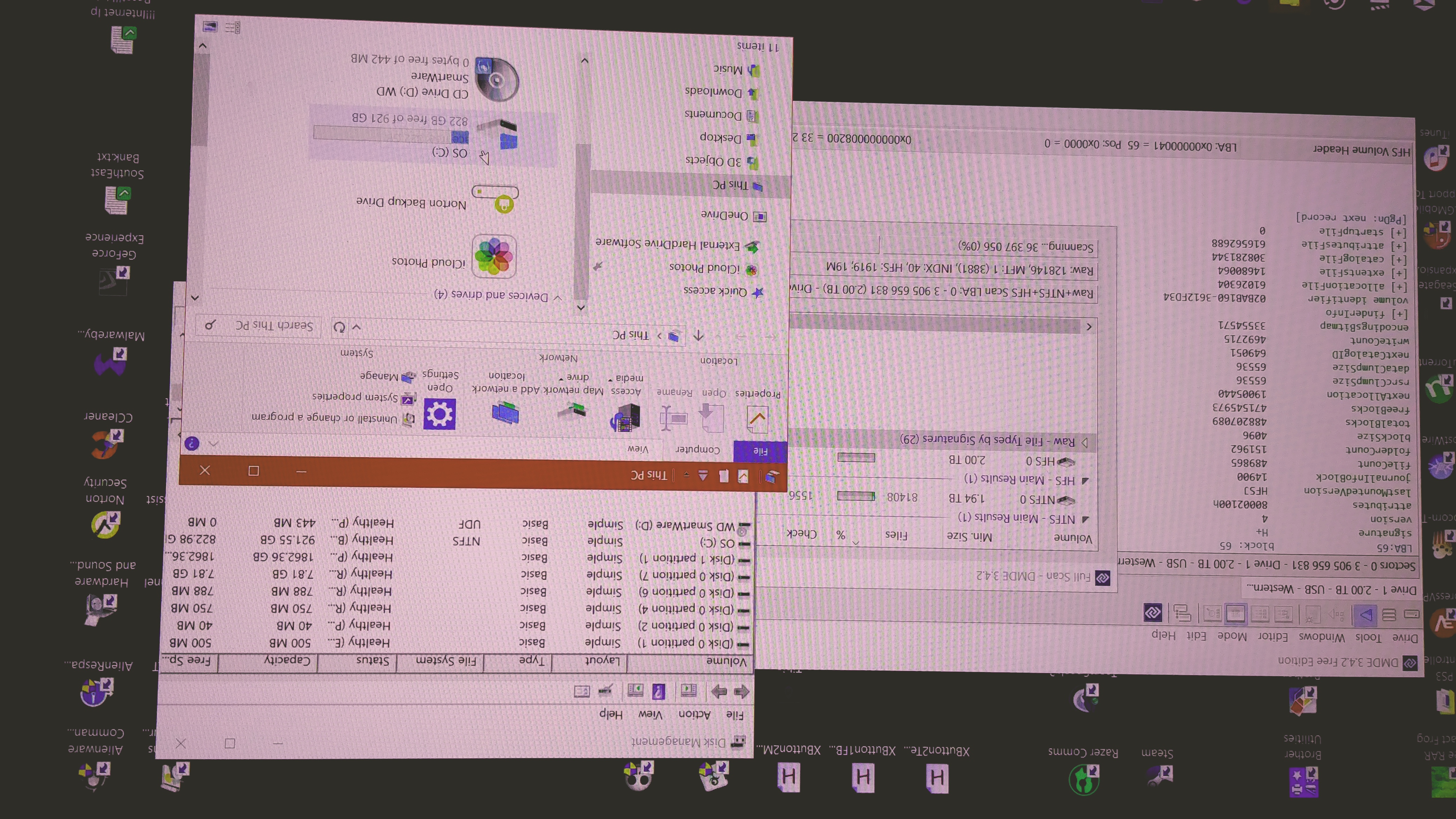

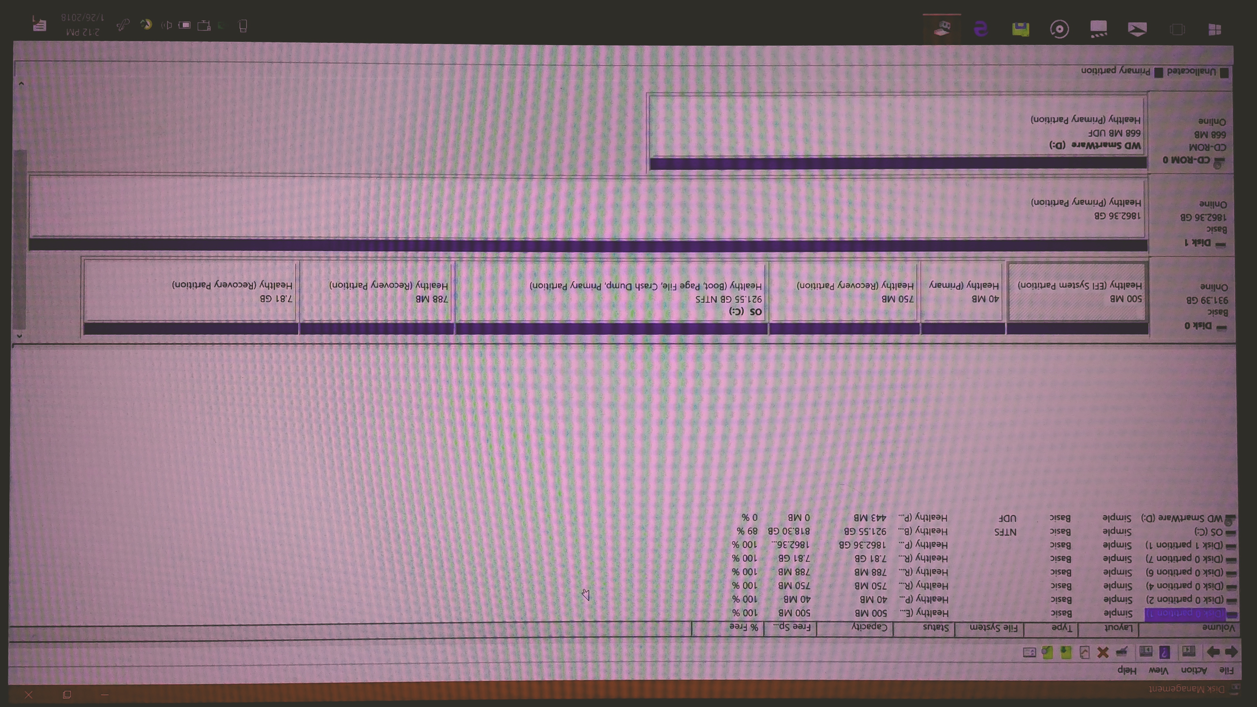

Okay, got the new bridge board, My computer recognized it but it opens up as a CD drive(smart ware) in my computer and in disk mgmt. Im scanning it with DMDE and its finding the files. Does this mean that I need to swap the 8 pin serial flash memory chip on the bridge board?
PostPosted: January 26th, 2018, 14:43
“Finding the files”?
Do you mean it’s finding the smartware files in the small partition, but not your data in the large (user data) partition?
PostPosted: January 26th, 2018, 15:01
Posts: 713
Location: Brazil
Post a picture of how Windows Disk Management is showing the disk / partitions.
PostPosted: January 26th, 2018, 15:14
Posts: 28
No, it was finding files on the hard drive itself.

Another peice of information is that he used this on a Mac, but said he has plugged it into a windows computer last and was able to see the files but couldn't read/write to the drive. I don't understand how he could see the files in their intirety on a WINDOWS if it was formated to Mac?
